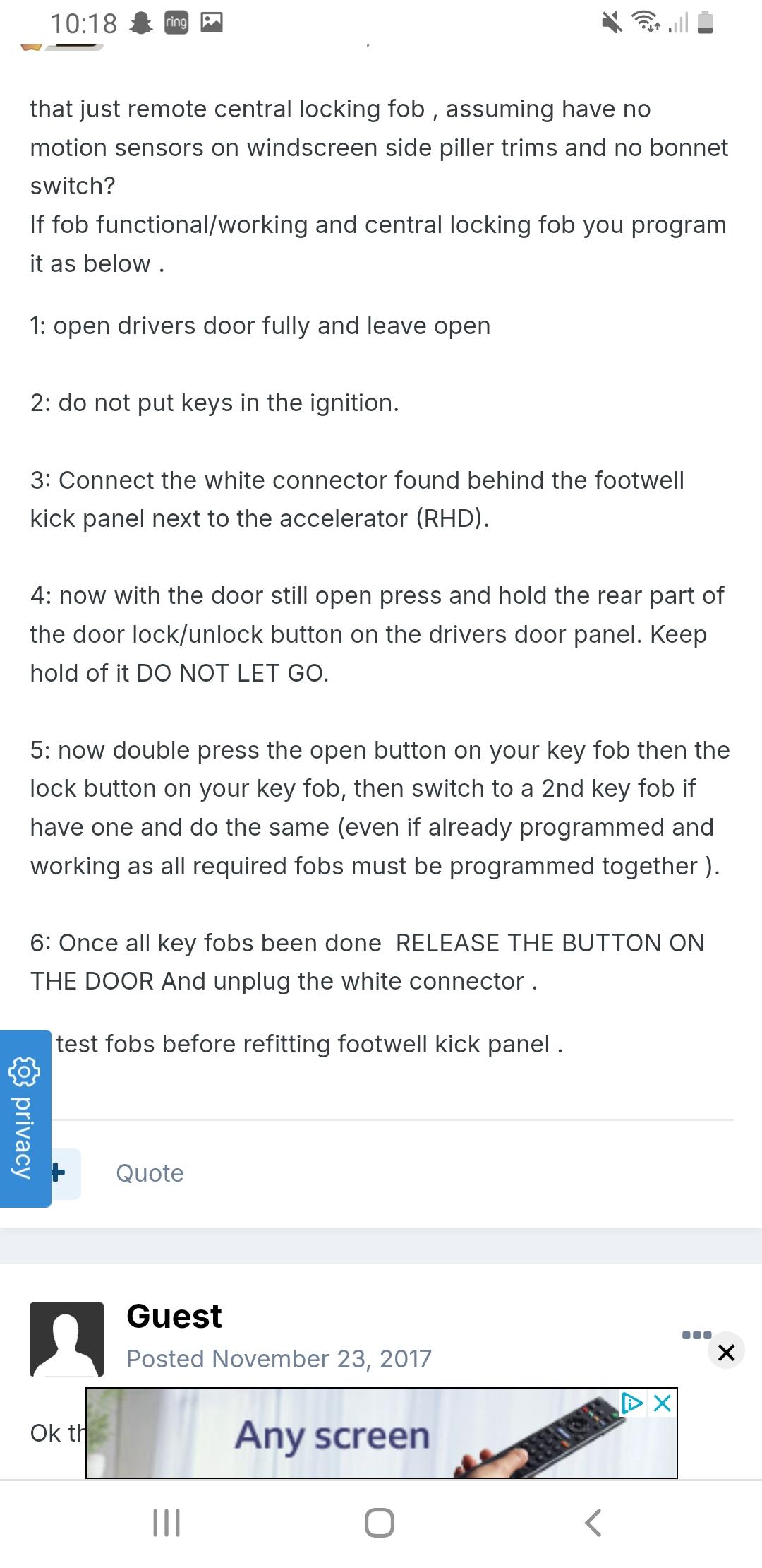

I got subaru forester 1999 central locking fob not working fitted new battery still not working when i press the locking mechanism from inside all dors lock so im guessing its fob any info on how to program another fob thankyou
Please could somebody explain what no4 part means please
