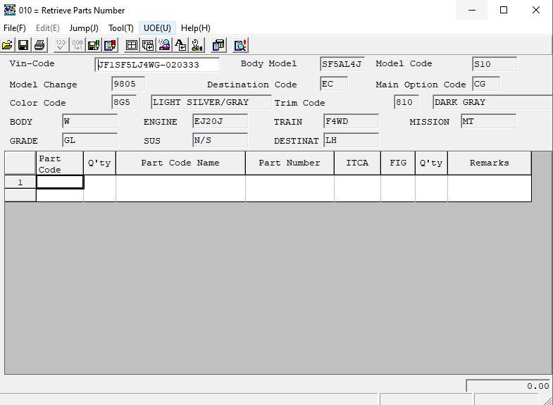

The plot thickens,     after finding specialists  including Amayama,  and a swedish company both replied saying my Vin cant be found, or 'isn't recognised by their system. Just double double checked on my owner's document and two seperate plates riveted  on the inner wing, and I haven''t got it wrong, its exactly as the the above post....Anyone come across this issue before ?
Well your VIN seems good in Subaru Fast ...
Will look into the part in question as soon as got free 10 minutes ...

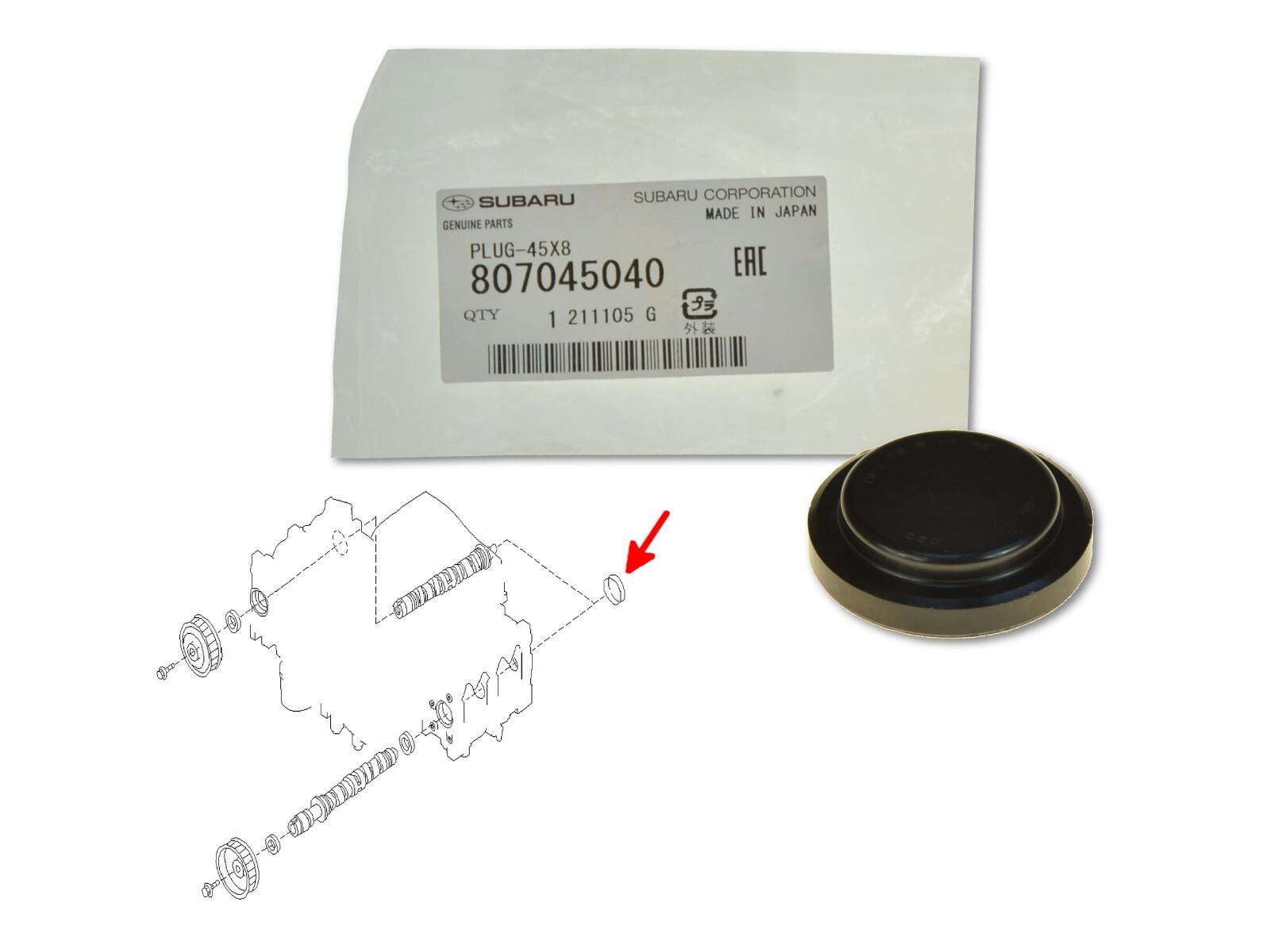

Part number 807045040
It 45mm diameter by 8mm deep rubber plug
Amayama have it and shipping to Portugal from Japan stock is quite fair cost ( no idea if you get screwed on import fees and get delays and hassle by Portugal customs on Japan goods but assume it highly likely lol ) Anything to screw money out your pocket ...
https://www.amayama.com/en/part/subaru/807045040
