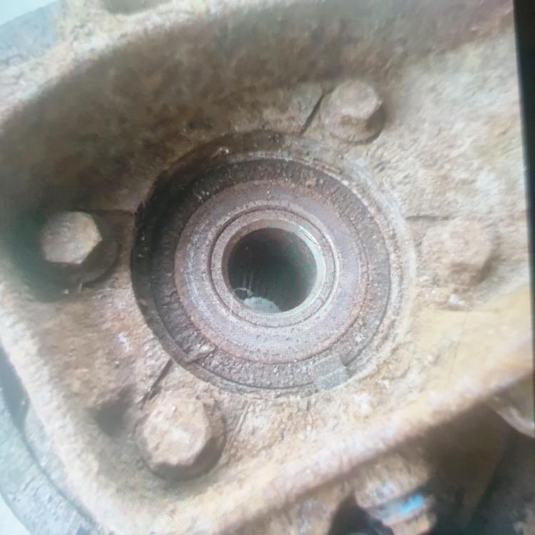

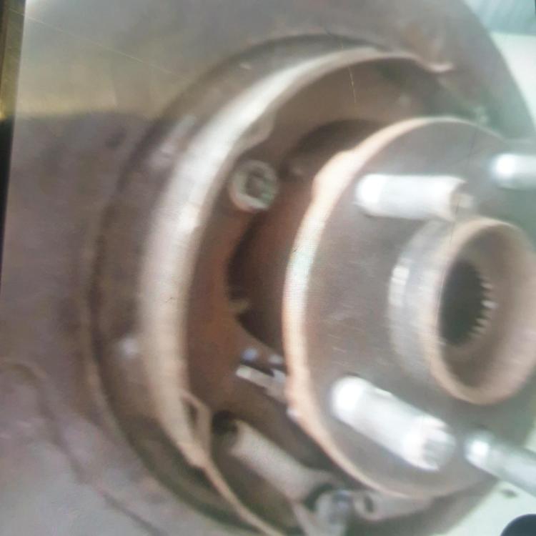

Hi i have a pic of one thats off same year as mine so please could you tell me what the 4 bolts do in pic if this model doesn't have full wheel bearing hub
A pic of rear wheel bearing from front view
Well that picture is not a 1999 Forester sf hub lol .
Poor pics but probably a SH SJ hub !
What is the actual correct vehicle details/scenario !?

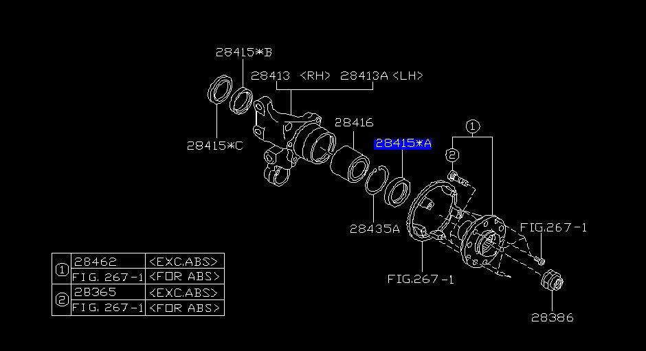

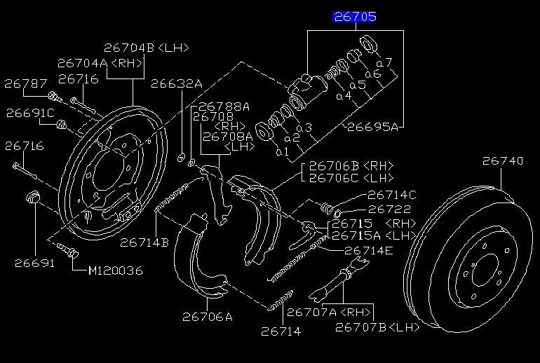

below is actual subaru fast parts illustrations of a SF Forester non turbo rear hub and brake drum layout .
