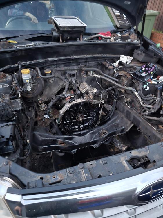

Hi all new to the forum needing a little advice. Ive got a 61reg forester diesel with play in the crank !Removed! oil into bellhousing. Ive found an engine with 109k out of a 60 reg not too far to collect this week. Im wondering will it fit and what will need swapping over if it doesn't ? I know the injectors probably will or get the replacement engine ones coded to the ecu but is there anything else I need to know ? My engine is already out ready for the donor
Just a bit oily in there will be de greasing and cleaning up tomorrow

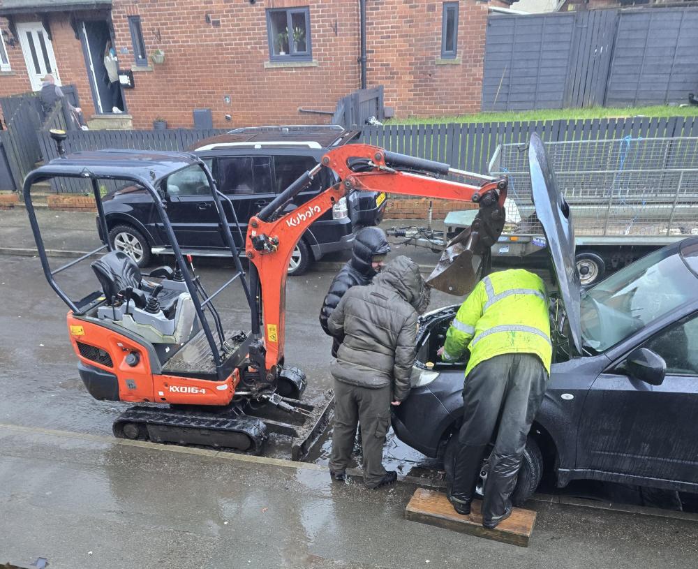

Both euro 5 engines so shouldn't be massive differences. No mechanics wanted to do the job so started it myself. 4 of us on a scaffold tube lifted it straight out 😅

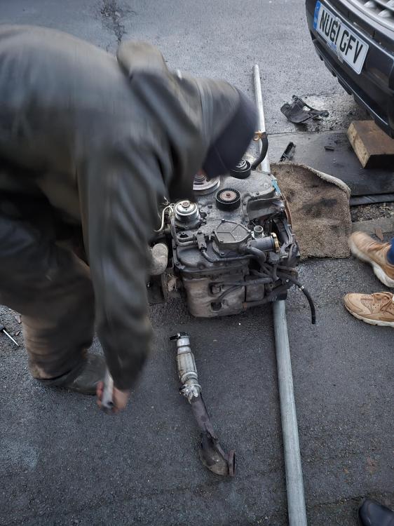

Thats the one 😅 not actually that hard of a job we had it out in 3 hour just waiting on a breaker to get the engine out of the donor lad werent in the yard yesterday 🙈
Well the engines in and running sweet as a nut didnt have to swap anything over the injectors are bang on no rough idle, smoke or any sign of them needing coding.
Made light work of it the machine definitely saved our backs 😅
