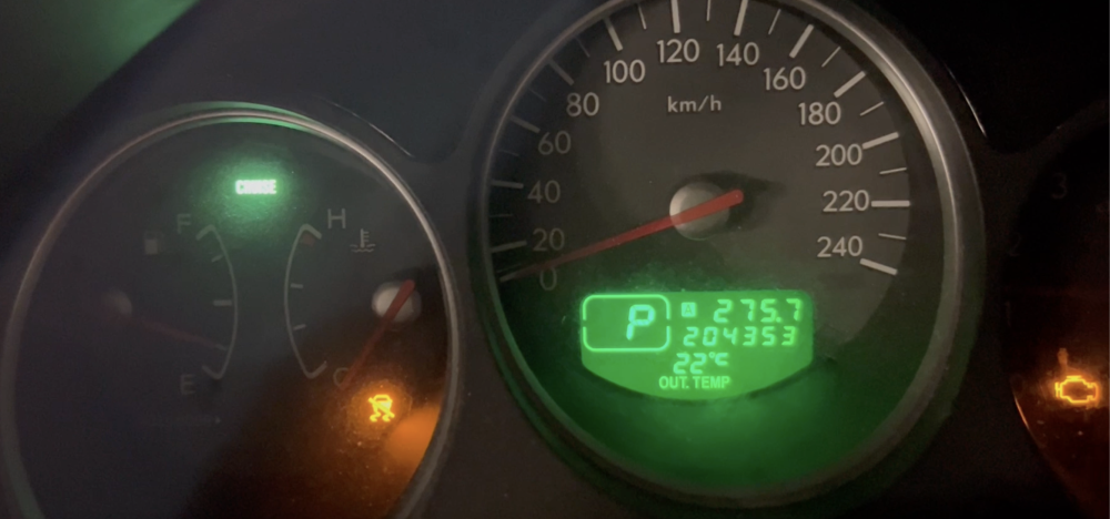

Symptoms
For about 6 years, the following warning lights are present:
  • Check Engine ON
  • VDC/ESP warning
  • CRUISE light flashing
  • Cruise control completely disabled
The warning lights are already present immediately after starting the engine and do not change while driving.
The AWD system still appears to work normally.

Could a faulty wheel speed sensor also trigger the Check Engine light, or would you expect only ABS/VDC warnings?
The original diagnosis several years ago was related to the Secondary Air Injection System, although replacing the pump didn't solve the issue.
And the check engine too ?
here's the picture
You can check if one of them is faulty by plugging in a £10 obd reader that can read live values, pull up all 4 wheel speed sensors and while driving see which one is way off.
