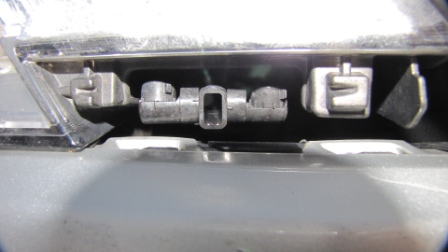

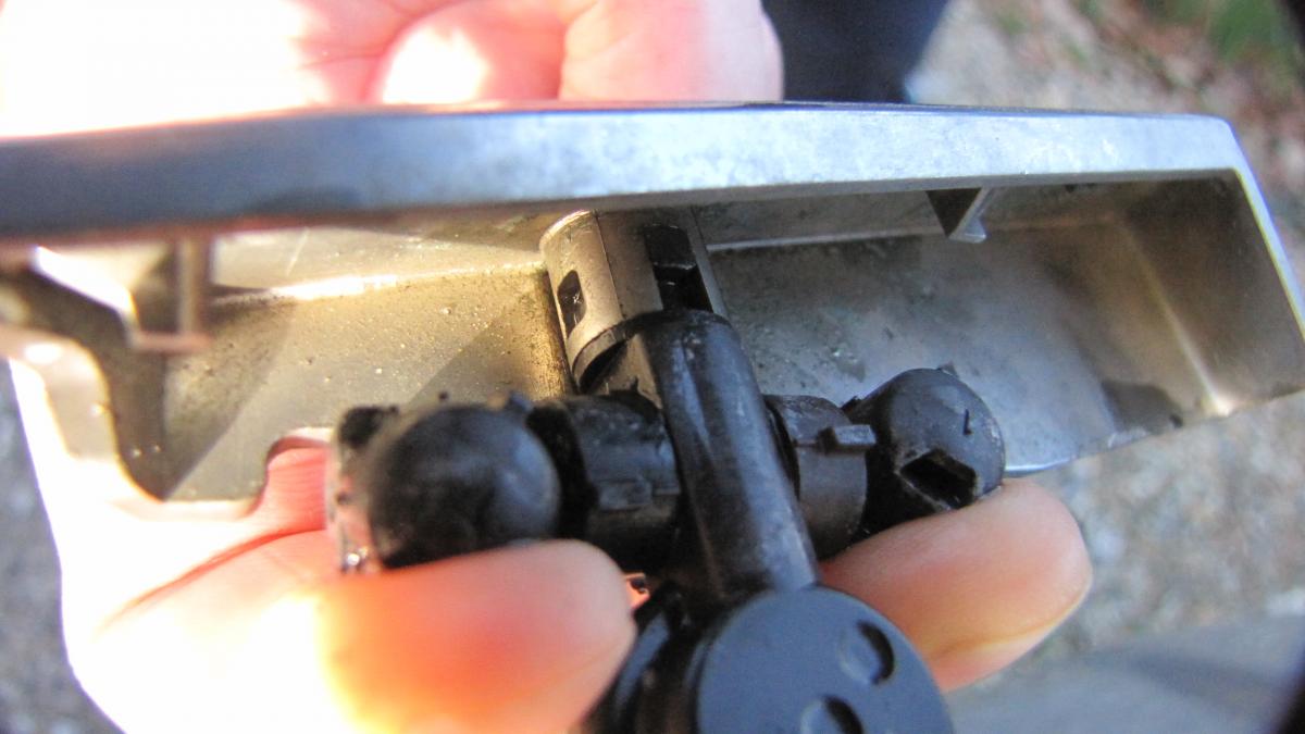

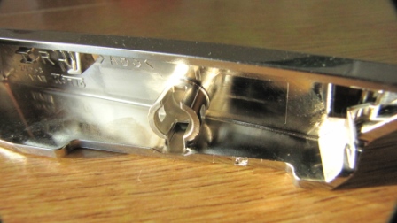

Bigmick11 Posted December 10, 2013 Report Share Posted December 10, 2013 Hi everyone I hope someone can assist. I got my car last week a 2006 Outback 3.0 R, and the r/h headlight washer trim was missing. I ordered the new trim part number 86636AG250 and got it yesterday. The problem is as you can see on the attached pictures, the washer jet has an oblong hole and the trim has a round hole. It didn't come with a joining tube and neither I nor the parts guy at my local Subaru garage can find the item. From the last picture you can see the plug thats missing from the cover. Have any of you guy's come across this? The little cover was £52.67p, you would have thought there was some way to join it to the car. Any help for a newbie appreciated. Thanks Mike. Quote Link to comment Share on other sites More sharing options...

Bigmick11 Posted December 10, 2013 Author Report Share Posted December 10, 2013 Unfortunately not, the square bit is pretty solid as is the plastic cover. There definitely looks as thought there should be a joiner of some sort. It would be sods law if I tried to take the L/H one off to have a look see, it would break and cost another £50+. Quote Link to comment Share on other sites More sharing options...

Jay762 Posted December 10, 2013 Report Share Posted December 10, 2013 It does look like you are missing a 'plug' which allows the facia to connect Quote Link to comment Share on other sites More sharing options...
Gambit Posted December 10, 2013 Report Share Posted December 10, 2013 Thats what I'm thinking to lock it in place. I wonder if another Subaru model might fit, say from a fozzie Quote Link to comment Share on other sites More sharing options...

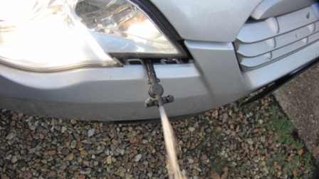

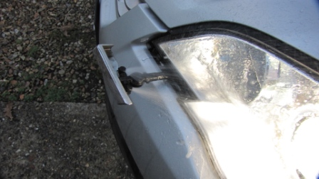

Jay762 Posted December 10, 2013 Report Share Posted December 10, 2013 from the pictures the water is firing straight out of the end in the defective mount, where it should be coming out of one of the holes to the left or right dependant on side of car - I would say the plug both attaches the plastic facia and deflects the stream of water out of one of the side holes back towards the headlight Quote Link to comment Share on other sites More sharing options...

Bigmick11 Posted December 10, 2013 Author Report Share Posted December 10, 2013 So does it spray like it should when you push it tight in ? so is it something more to lock it in place or does it not reach the jet to spray it without it going everywhere ? Sorry about the questions just so I know what I'm looking for ;) Hi, you can't push it tight in as they just butt up against each other, the missing plug would certainly clip into the front cover and I assume just push into the oblong hole. Quote Link to comment Share on other sites More sharing options...
