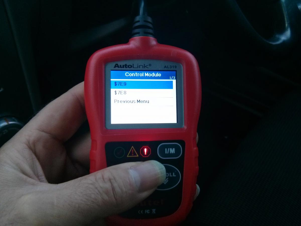

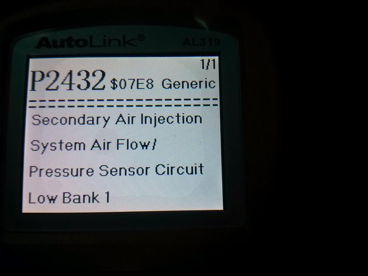

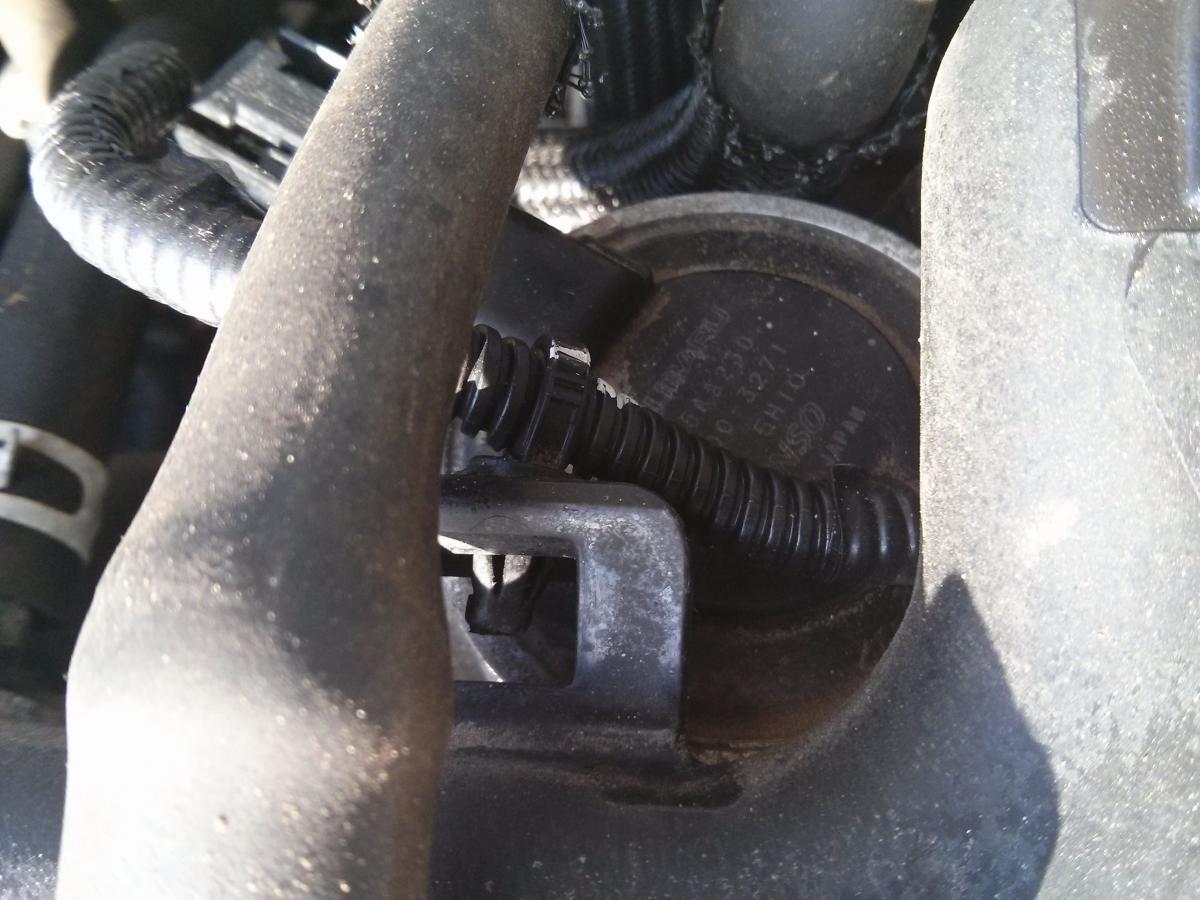

Bit of work to do... P2432
Got a bit of work to do :huh:
post-1873-0-10825100-1390339287_thumb.jp
post-1873-0-59926900-1390339309_thumb.jp
post-1873-0-36768200-1390339333_thumb.jp
Secondary Air Injection System Air Flow/Pressure Sensor Circuit Low

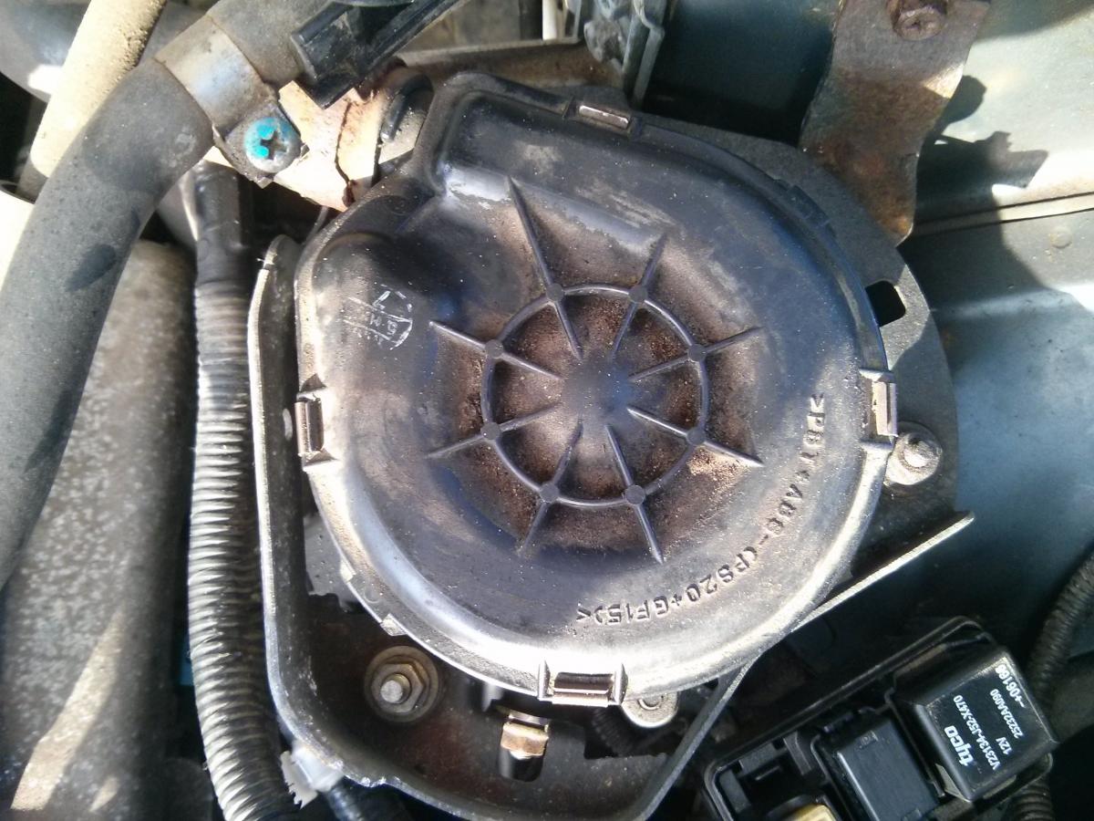

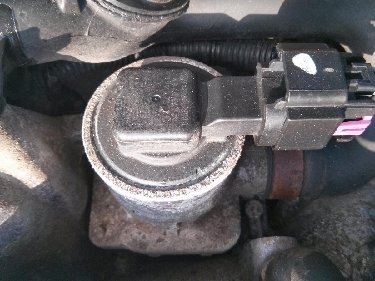

a couple pics for the picture fans out there :wub:

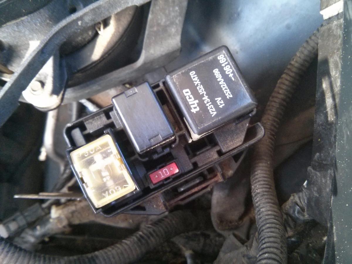

pump does indeed runs very shortly but does anyone here how to manually let it run so i can check it?
may be bridge the relay? oh, the 10amp fuse is fiine

either bridge the relay or activate the relay with a constant feed - probably better as the higher amps dranw by the pump wil be going through cabling designed to handle it
Thx, will have a play with a wire bridge to bridge the relay just to check the Air Pump.
