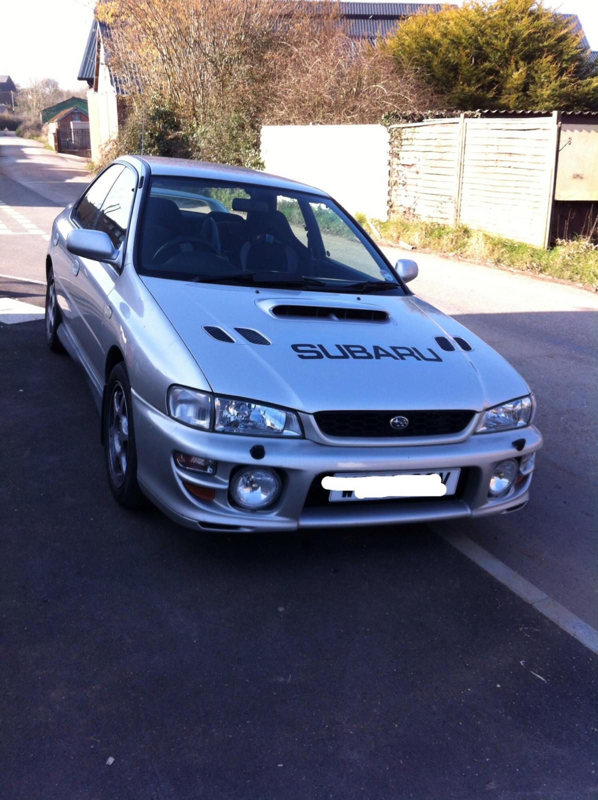

Howdy all. Just stumbled across this site by chance so thought I'd join in. After much begging my other half finally caved and allowed me to go Subaru shopping over the weekend. I am now the proud owner of an Impreza turbo 2000. I think I just rescued her from being abandoned. She's been badly keyed and her brakes have varying degrees of wear, which tells me that the bloke I bought her off changed them as and when and not in sets. Pillock. But because of this I was able to knock him down by £450. Got her for £800. I have to say I am now converted. I will never own anything else. I have never driven anything like it. Anyhoo thought I'd pop in and say hello as I'm reading through for info on brakes etc. so yeh Helloooo :)

Car looks nice but does sound like it was in need of a rescue but look's great from the picture and looks like it was a bargain at £800
