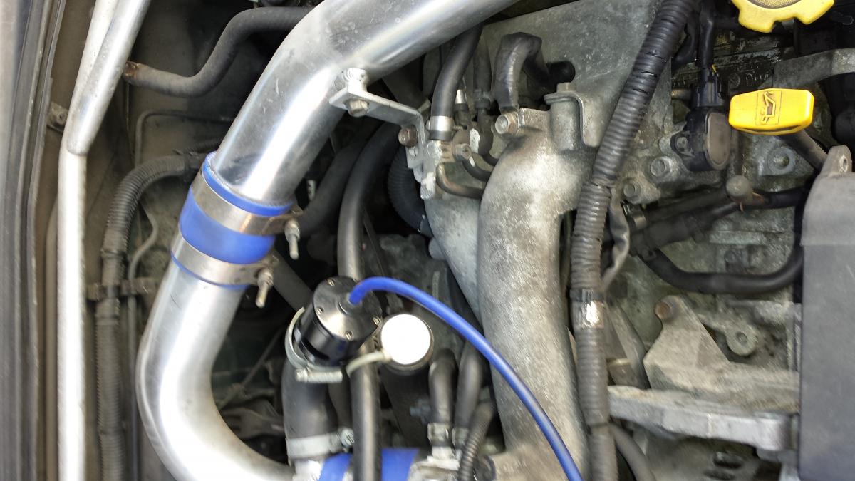

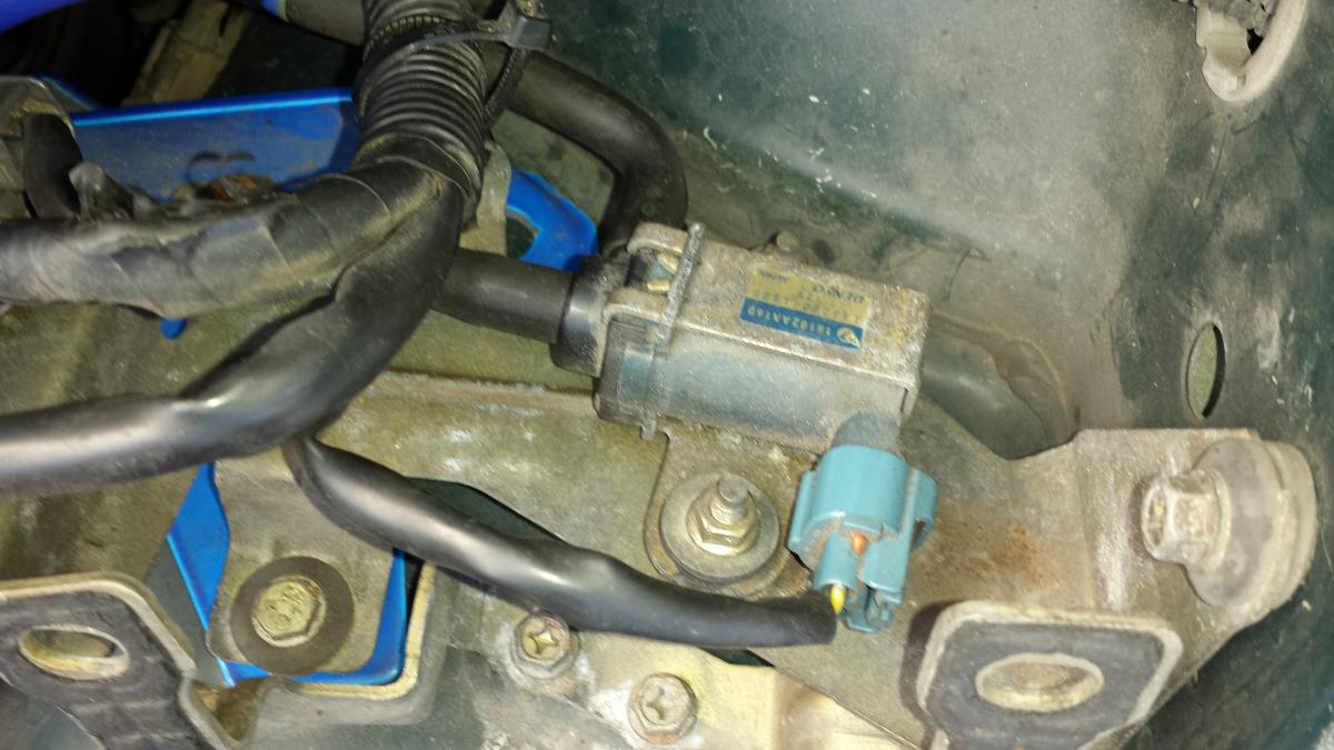

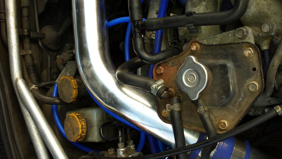

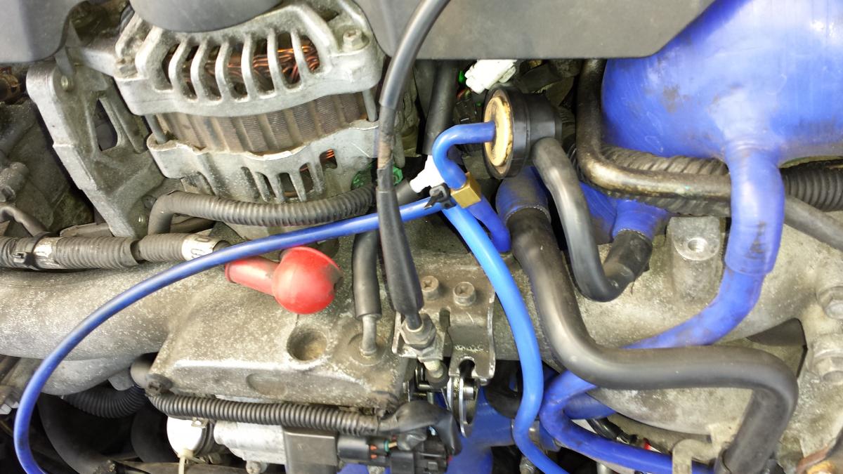

Thanks for your replies, this is my first impreza and I have only just picked it up do don't know what it was running or how/what the parts are call so please bear with me...The pipe was in the Battery looking item at the left of the engine by the suspension if your looking from the front of the car and had a tee off to go into the boost controller and the dump valve had a screw in the top pipe which was not allowing back pressure so we took screw and tee out and bypassed the boost controller and connected straight to the Battery looking item (maybe the actuator) and used the tee off the same pipe where the boost guage is connected and connected it to the top of the dump valve, this tee was just in front of the throttle body. I'm sorry for explaining it so bad :(

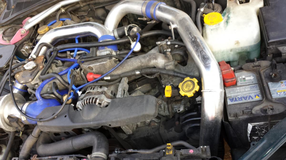

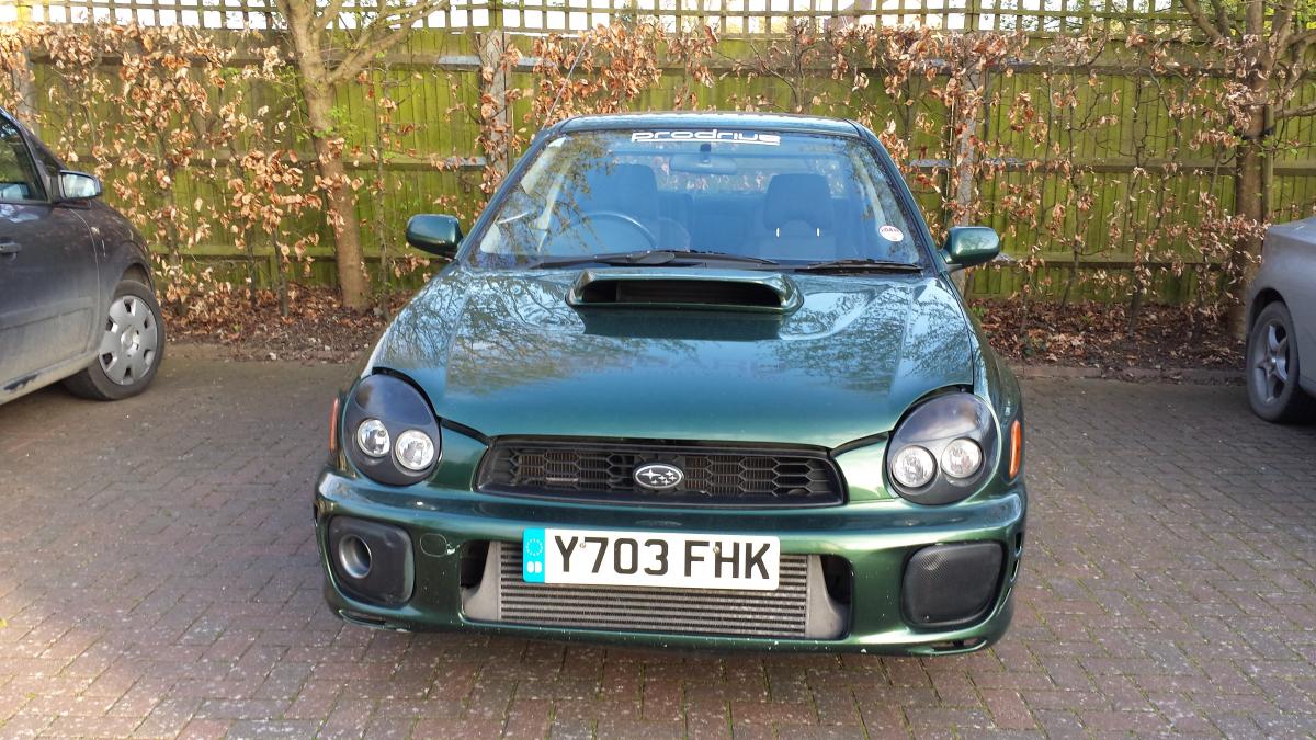

Hi, thank you for your help, I have now uploaded some pictures of the engine and some of the car. I hope this helps explain my question better and the bonnet is open because I was taking photos of engine and disconnecting Battery, so the Battery reason leads me to another question (really sorry for being such an amateur) the previous owner used standard fuel in the car and I have been advised to use ultimate fuel or v power so when the fuel light came on I filled up with tesco ultimate and the car started to feel very sluggish the next day so I done a bit of research and someone said that when you use a certain fuel over a certain period the ecu will set the engine up to take the fuel and that when you change the fuel the ecu will need to relearn the fuel mixture and adjust the engine accordingly and the best way to assist this is to disconnect the Battery to reset the ecu. Is this right or have I been lead astray and am now sounding like a right silly bugger? Sorry for all of the questions and I am very great fun for all the help.
