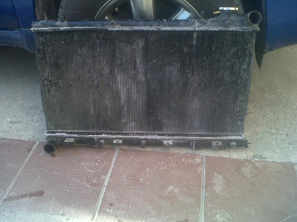

Indrojit Posted April 24, 2014 Author Posted April 24, 2014 Also I did run the car without the thermostat valve with the radiator cap open. No air bubbles or water being thrown up. I did the valve clearance for the the intake at 0.008" and the exhaust at 0.010". No skimming to the heads. Also to mention, I took off the rockers from the heads but didn't take the cams off. Please find the attached pics of the radiator.
Tlag Posted April 24, 2014 Posted April 24, 2014 Not the best looking rad in the world, but I've seen far worse that still worked well. Flush the rad through from both ends. Also, whilst the rad is out, flush through the whole engine, heater, etc. Is the water pump, the original? I wonder if it's become weak and preventing full flow. 1

Indrojit Posted April 28, 2014 Author Posted April 28, 2014 Hello Gentlemen, Have manage to solved the problem. The radiator was completely choked. We have a radiator specialist in our locality who opened and removed the lower tank and we found that the water galleries in the radiator 95% choked. We cleaned it and serviced it. Put it back into the car, put the front end in air and all is well :). Now the next thing that needs to be done are the rear wheel bearings and the power steering pump. Any suggestions for a power steering pump? Thanks Indrojit 2
