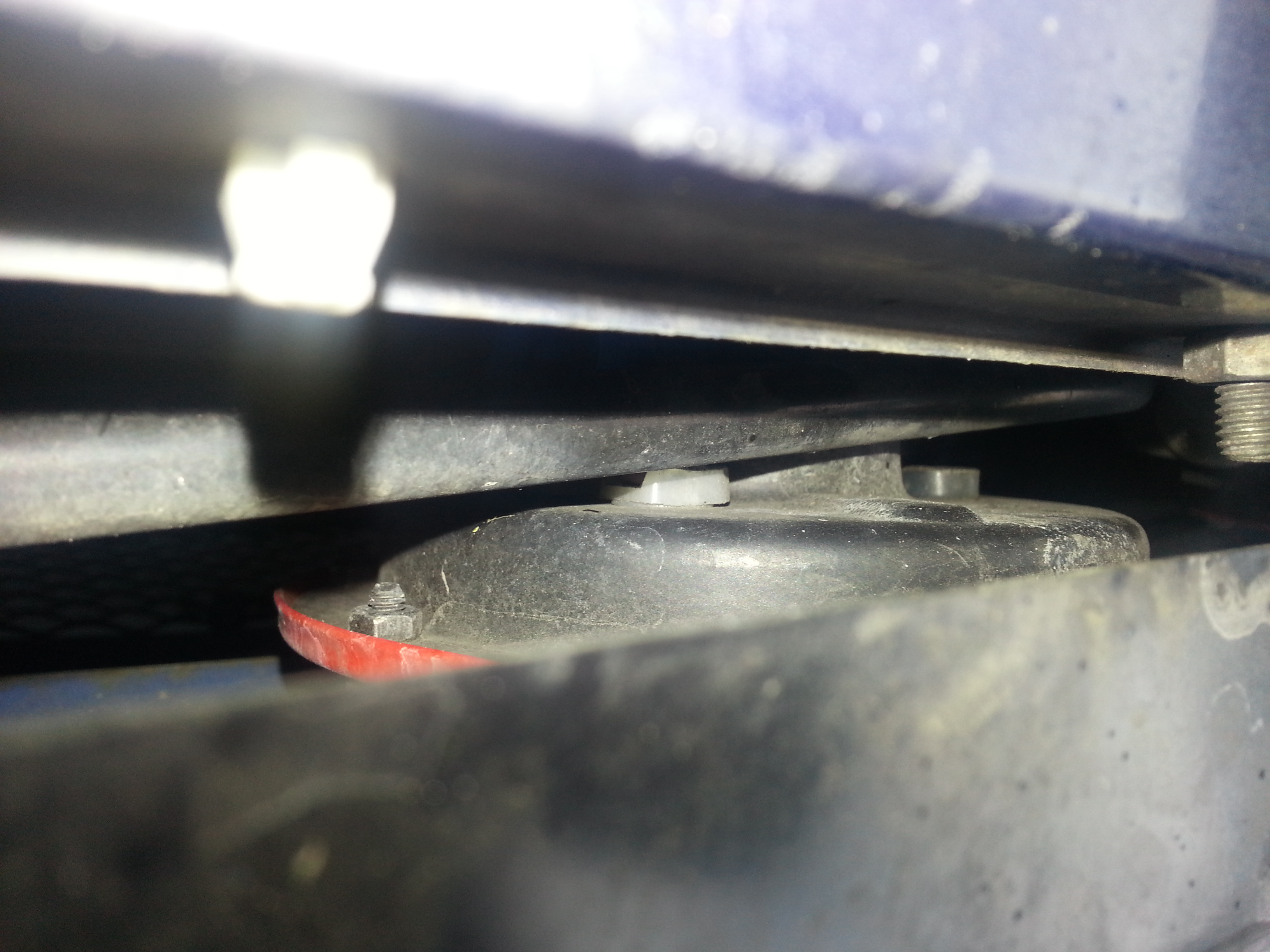

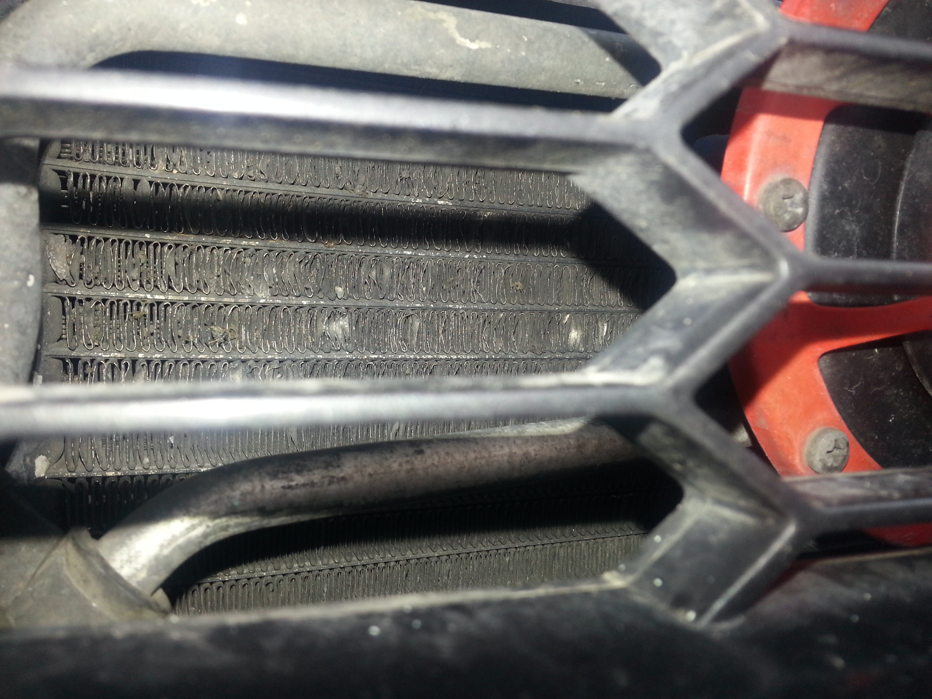

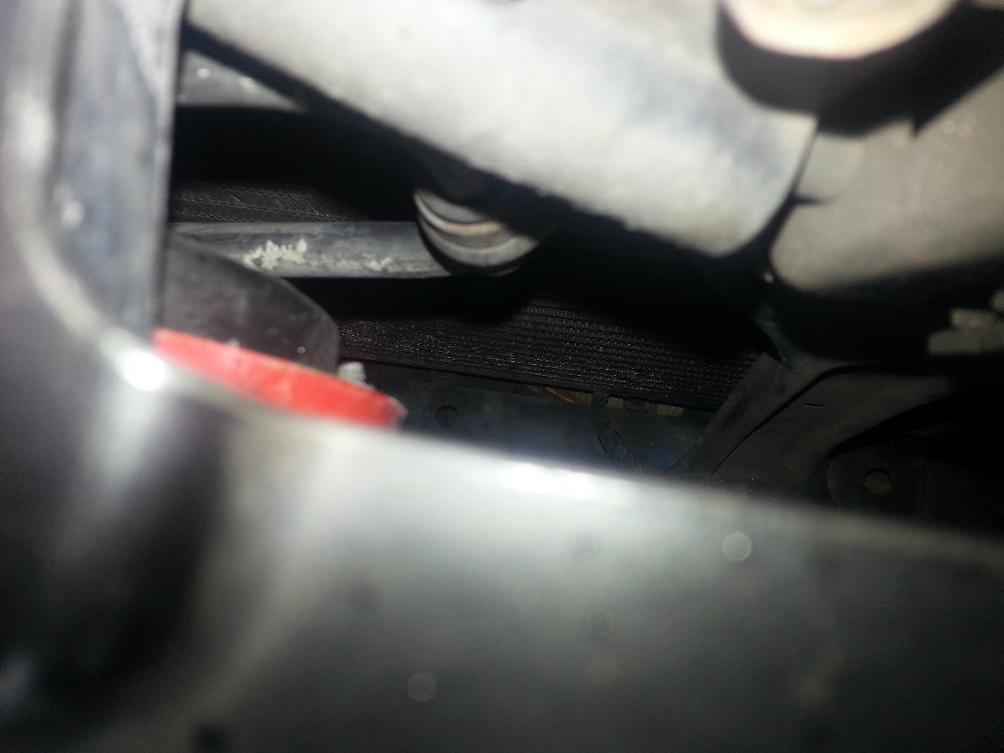

Hi guys, bought some Supertones today to replace the stock horns. Went to fit them behind the grill, but in front of the rad there's a pipe, I think from power steering. It's stopping me from fitting one of the horns. Can I remove it or move it?
Any ideas?
Cheers
I've spoke to him via PM it's the power steering cooler Pipe I'll post the pictures when I get chance here I just put the bracket through the two pipes and pushed it back slightly. I also just bridged the two horns on both Blobeye and Bugeye without running stuff back to the Battery or using the resistor provided. Shame didn't ask before I had the full front end off the Monday :(
