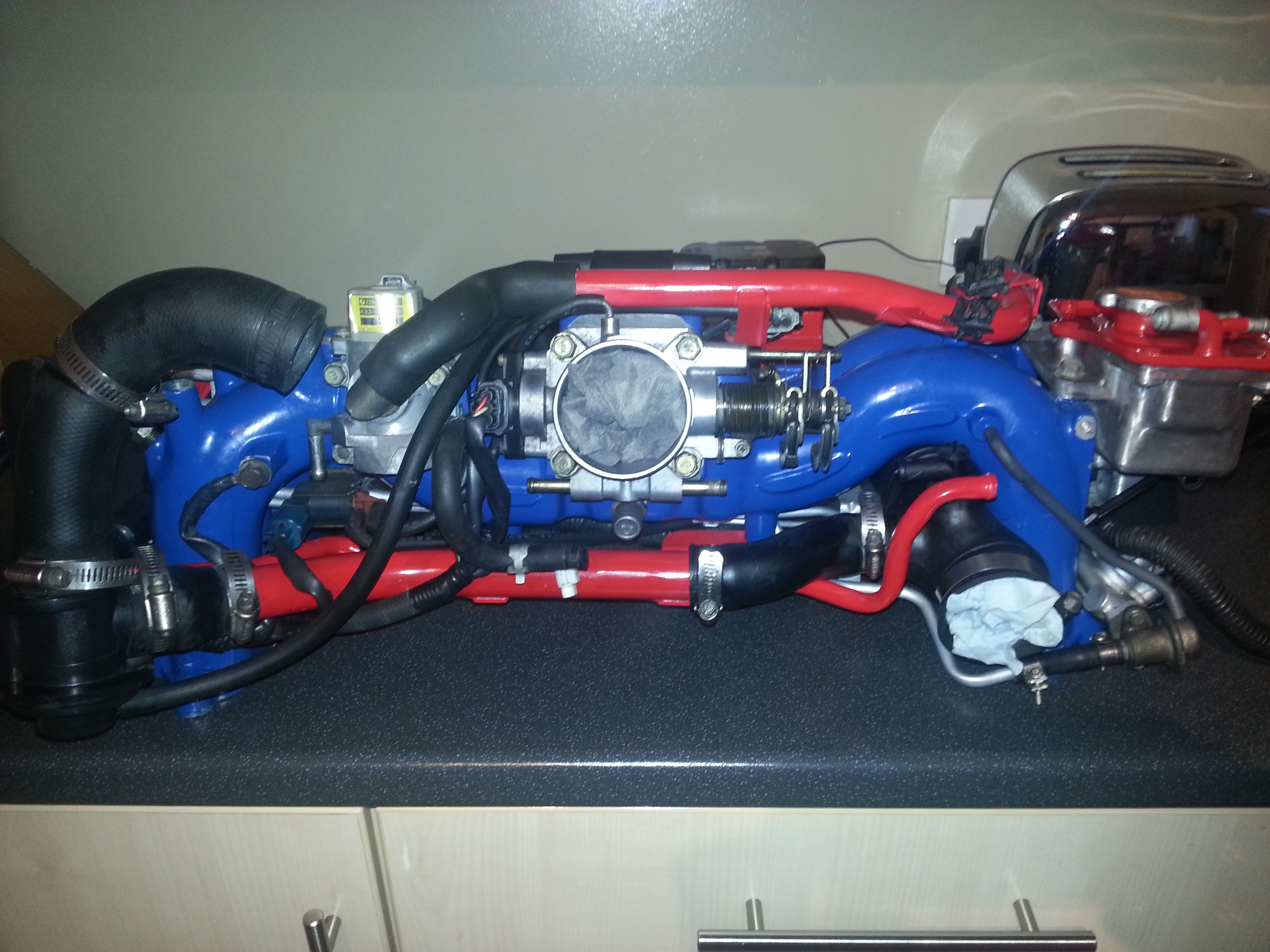

Looks like it goes to the fuel pressure regulator .

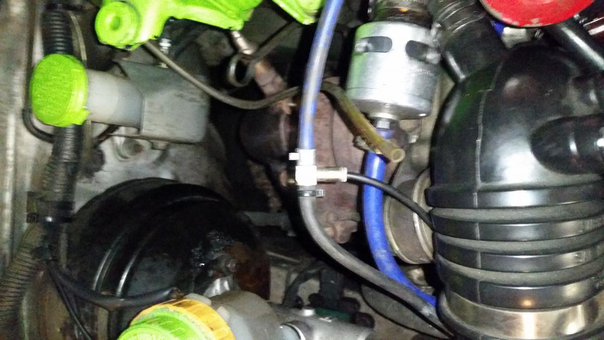

I'll have to check tonight but I don't think the boost solenoid should be directly plumbed into the inlet (map sensor maybe )
Boost solenoid
Top port turbo outlet
Middle port actuator
Bottom port intake pipe (black pipe between maf and turbo)
Had a quick squint and the boost solenoid vac lines are as above .
This is a pic of my old phase 1.5 inlet but the fuel pressure regulator is in the same place at the end of the drivers side fuel rail .
Bottom right in the pic vac line runs from inlet to fpr (looks a bit like a mini actuator)
