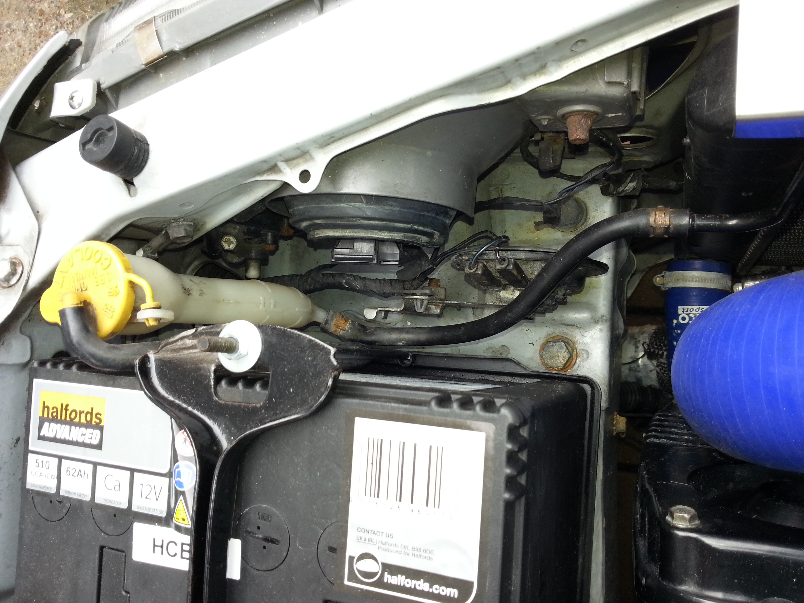

only pic I've got that shows the expansion bottle position on classics
You can just see it in front of the Battery I can get a better pic a bit later if you want ?
You can just see it in front of the battery I can get a better pic a bit later if you want ?

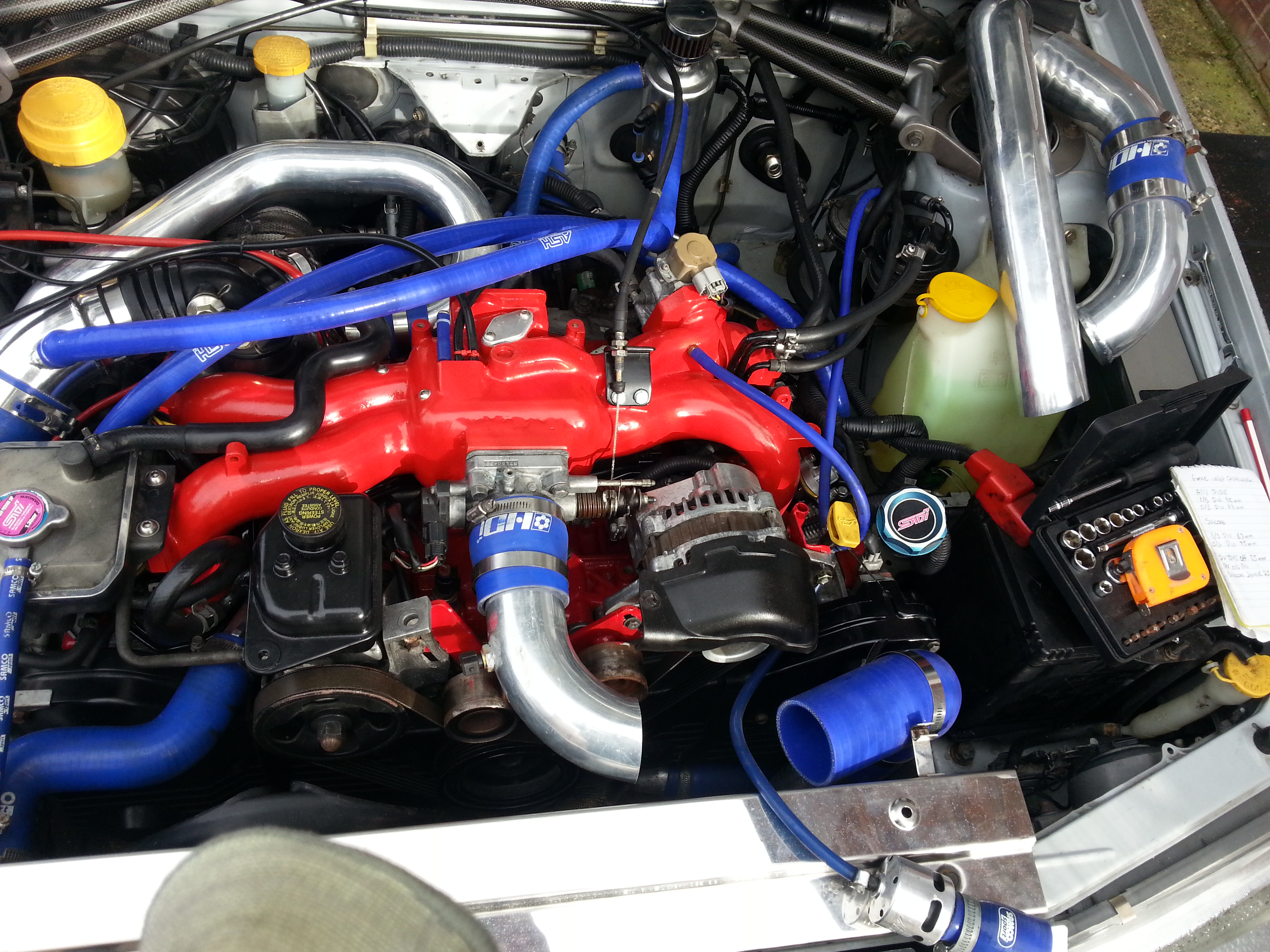

Is it a large coolant bottle Clive or a small one

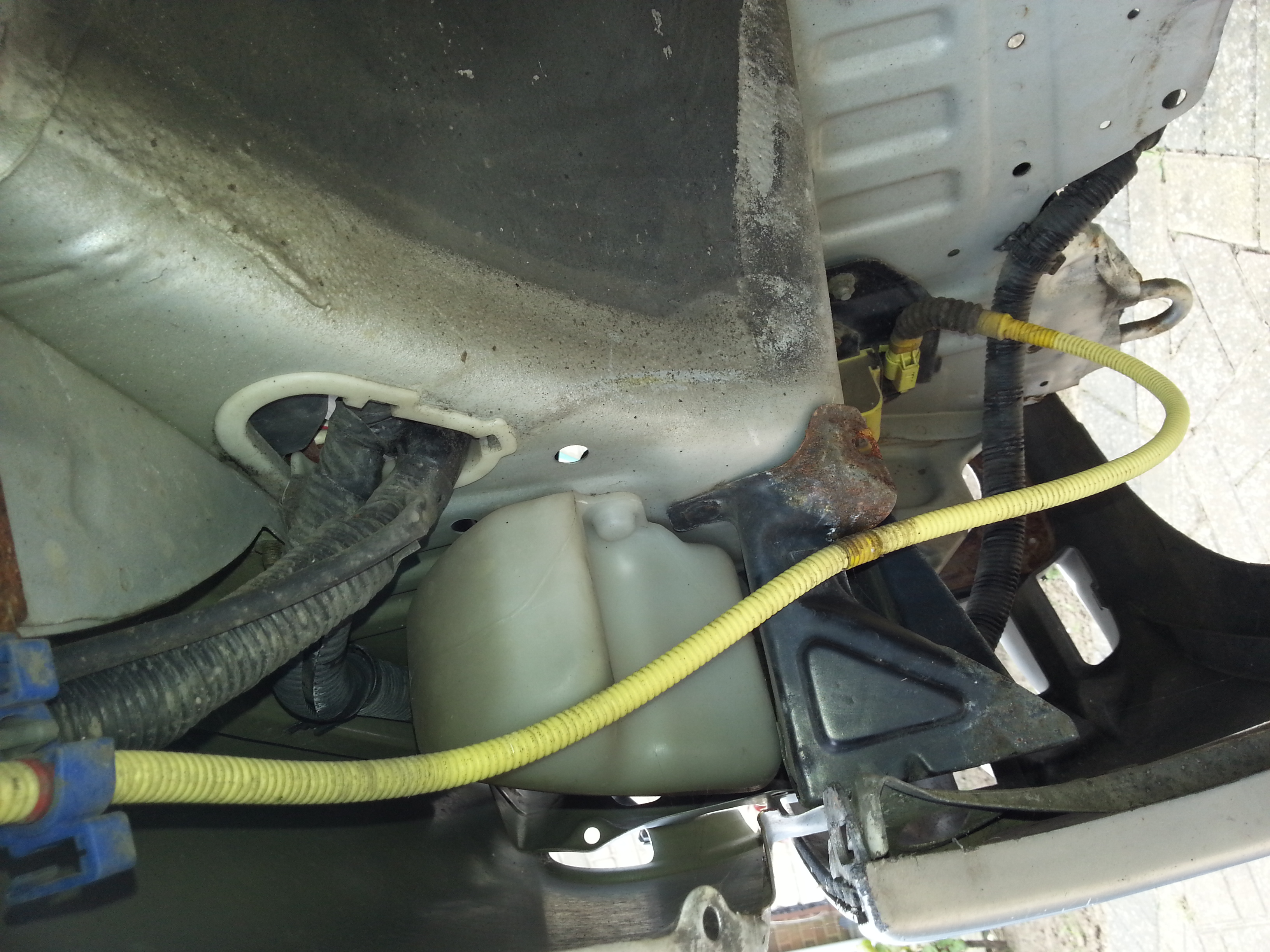

Hi Clive is your coolant bottle just that little stick thin coolant bottle with that piece of pipe sticking out or is there more of the bottle
Here's a pic of the one by the Battery
The small bore pipe at the bottom connects to a metal pipe that runs along the top of the rad to the header tank (attached to the inlet manifold)
There's a bigger bore pipe at the back of the little expansion bottle that goes to the tank in the inner wing .
