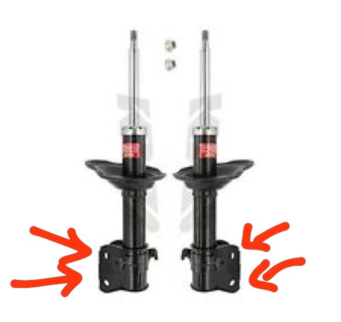

Lower strut Bolts?
I take it you mean the two smallish ones that attach the strut to the hub ?
The ones the front are cambered, not sure about the rears, but you need to mark the position of them before removing.
Chances are if you buy them you won't use them and if you don't you know they'll shear off !
Just soak them in plenty of wd or similar for a few days should be reet !
Yep that's the ones I thought you were on about. They should be easy enough to get hold of, deffo make a paint mark on them and the leg then at least you'll know they are back there and there abouts,
