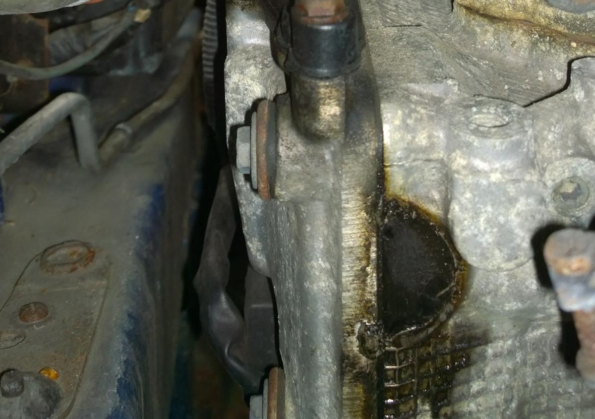

Shine a torch down the left side of the engine between the airbox and cam covers, see if there's any puddles there, the gaskets weep but not enough to loose that much oik in such a short amount of time, also check the oil feed line to the turbo is ok and has no holes in.

Hundred quid roughly for a garage to do it, about 50-60 diy, to be honest it's worth paying somone as it's a pig.
That's the half moon that accompanies the cam cover gasket, they get hot and brittle and eventually perish.
At least it looks like something simple
No worries mate, do you have an independent subaru specialist ?
A main dealer would probably have your eyes out for this as it's simple enough, but access and the bits you have to remove are time consuming
Ah boo, easiest way is to remove plugs & leads remove airbox, Battery & washer bottle and loosen engine mounts then jack the engine up to gain access, there are a few other bits to remove aswell but that's the bones of it Www.importcarparts.co.uk your best bet, if your struggling or can't find it on the site give them a call they should have it
