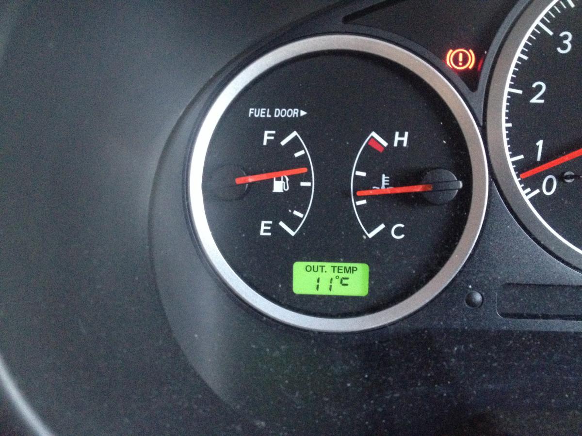

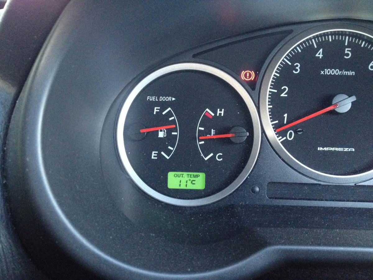

What does your temp gauge read when warm ? The coolant smell could be just a spillage and as it's boiling point is around 230°c it's still sitting on the block or undertray.

Jus went out for drive to get pics and test the rad, yeah rad hot both sides and both pipes hot, expansion tank is at max wen cold then goes bout inch n a half above when hot. I will send a pic of gauge

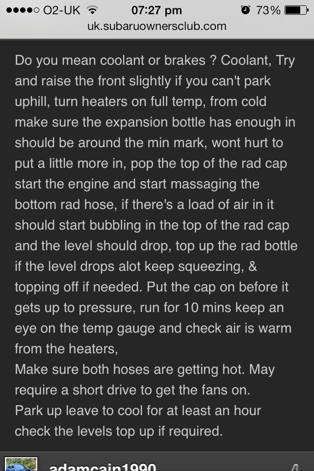

Easiest way to burp is either jack up the front of car, or park uphill. Get a helper makes life so much easier while they squeeze bottom hose you keep an eye on the header tank (do newage have them ?) Check for bubbles and top up as required
Yeah no faults :/ on that pic wen it says rad cap does that mean the header tank cap ?
How long hav a got be4 the pressure goes up ? Wont the fluid go everywhere wen caps off and engine on ?
