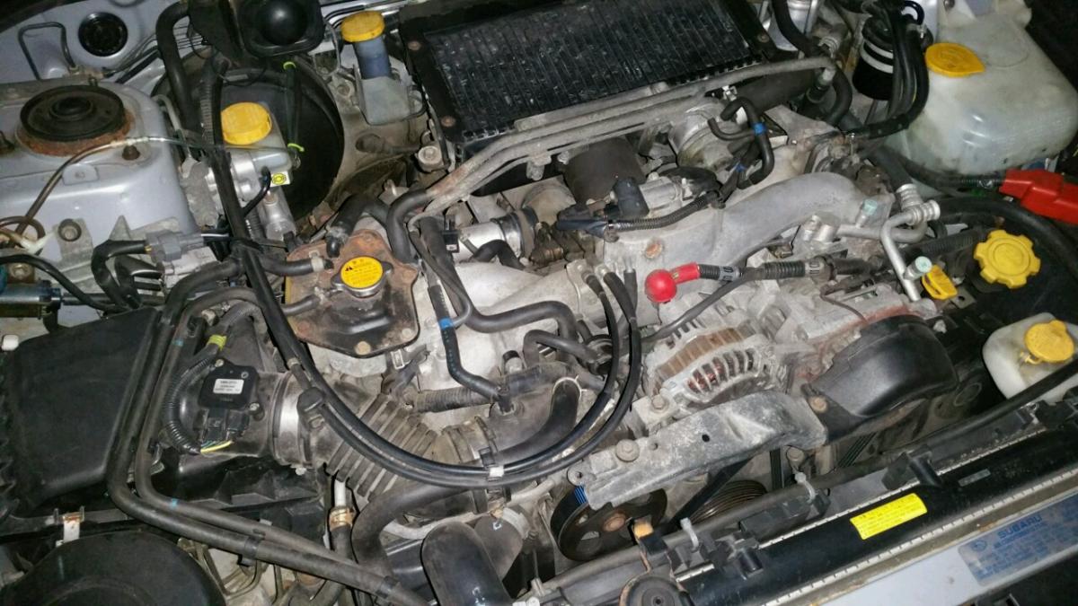

have you got a pic of the bay ?
Sounds like you'd have a v1/v2 phase 1 with a top entry turbo .
So it'll be a phase one then, makes life easier thanks :-) it's an ej205 in mine is that anything different or just pretty much the same? Can find a turbo on eBay for 80-100 quid which isn't too bad but it's long term project so just gaining knowledge at the moment
Yours is a 2001 so will be the last of the v5/6's it may even share some parts with newage bug eyes being an ej205, as all the foz's I've come across haven't been as simple as just looking at the same impreza, yours may have a td04 I'm not sure, best off having a look at the turbo, if you look down at the hot side, 'facing you as look at the car' it will have a model number stamped on it
Scooby ghost can tell you what a minefield it is as his ej205 engine needed different gasket seals to what was recomend when he called the dealer.
Again I've had loads of problems getting parts,my maf is listed as a legacy part, the airbox to turbo inlet hose is a v5/6 measurement even though the engine is based upon the v3/4 impreza so if in any doubt measure twice take pics and
Ask loads of questions ☺
I'm totally confused haha, just gonna match parts up based on looks when I need bits lol, can't quite make out the number on the turbo but I think it is tf03,wjll look when I get to work and get a mirror down there, don't worry I'll be asking many more questions I assure you haha
It's definitely not a phase 1 v1/v2 and hasn't got a top entry turbo .
if the injectors are topfeed and blue it's based on a bugeye
If the injectors are side feed and yellow it's based on a v5/v6 phase 2 classic
stants knows more about the foz varients tbh I've never owned one
Lol I wouldn't take anything as concrete with foz's
Mine seems to have been cobbled together with whatever they had lying around, the top mounts at the rear are newage shape and the fronts classic [emoji85]
