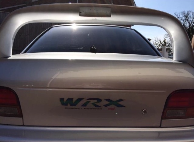

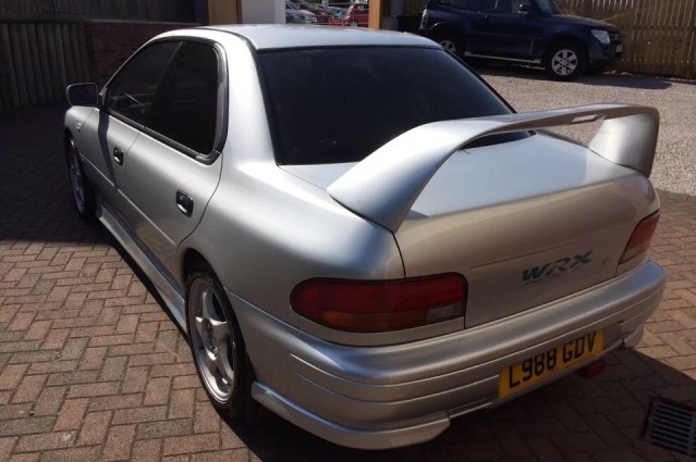

Tbh I preferred the v5/v6 sti rep spoiler
20141015_124612_zpsayiru9e_edit_14153867
But is was a bit rough and needed some paintwork . I want to put it back to preface before I get any paintwork done so decided to keep it looking more oe with the mid level
That looks good, can't wait till I get mine on now!!!!
I've attached pics of the spoiler I have now, it's a nice looking one, it's just the brake light missing.......
I've got a few people nearby that can spray so hopefully will be able to get it done quickly and well.
