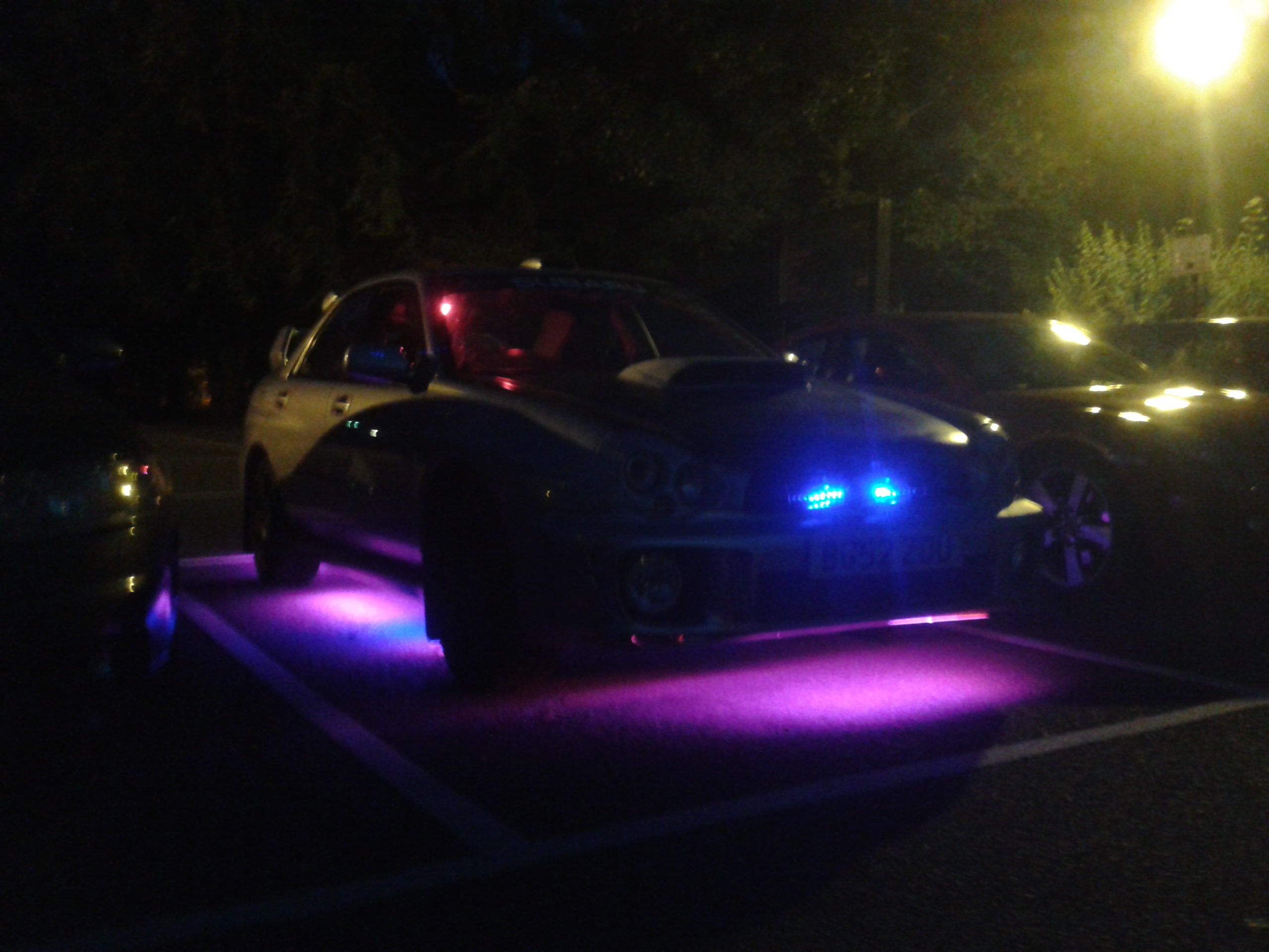

So with the split charging, how would that work?? Ive got a 1800 Watt Vibe Blackdeath sub and Black death 6x9's at 1200 watts total and i was also thinking about getting a power cap. My neons aint just a cheap set from eBay. When left on for a while, i can tell its drained the Battery a little bit.
Whole under body kit, 2 interior lights and a scanner at the front.

But now thinking, its more for my neons. Might sound daft. Im starting to go to quite a few car meets/ shows now a days and obviously im not ganna keep my car running when looking around. Im not sure what power they use but id say after a couple of hours the Battery would have drained quite a bit.

Jay. Im not 100% sure what wattage they are :/ ive got IceLed UFO lights and a few other little bits of theirs. It might say on their site. It might just be in my head that they cause a slight drain though.
