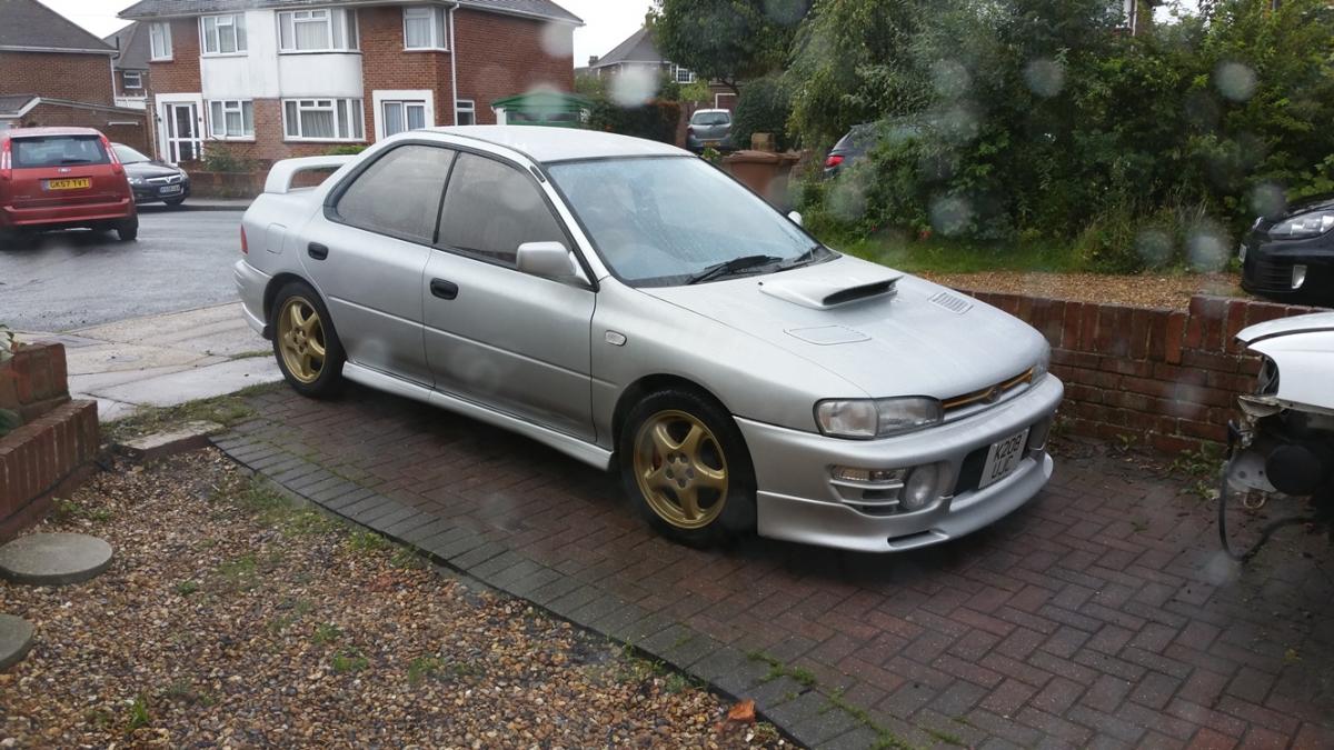

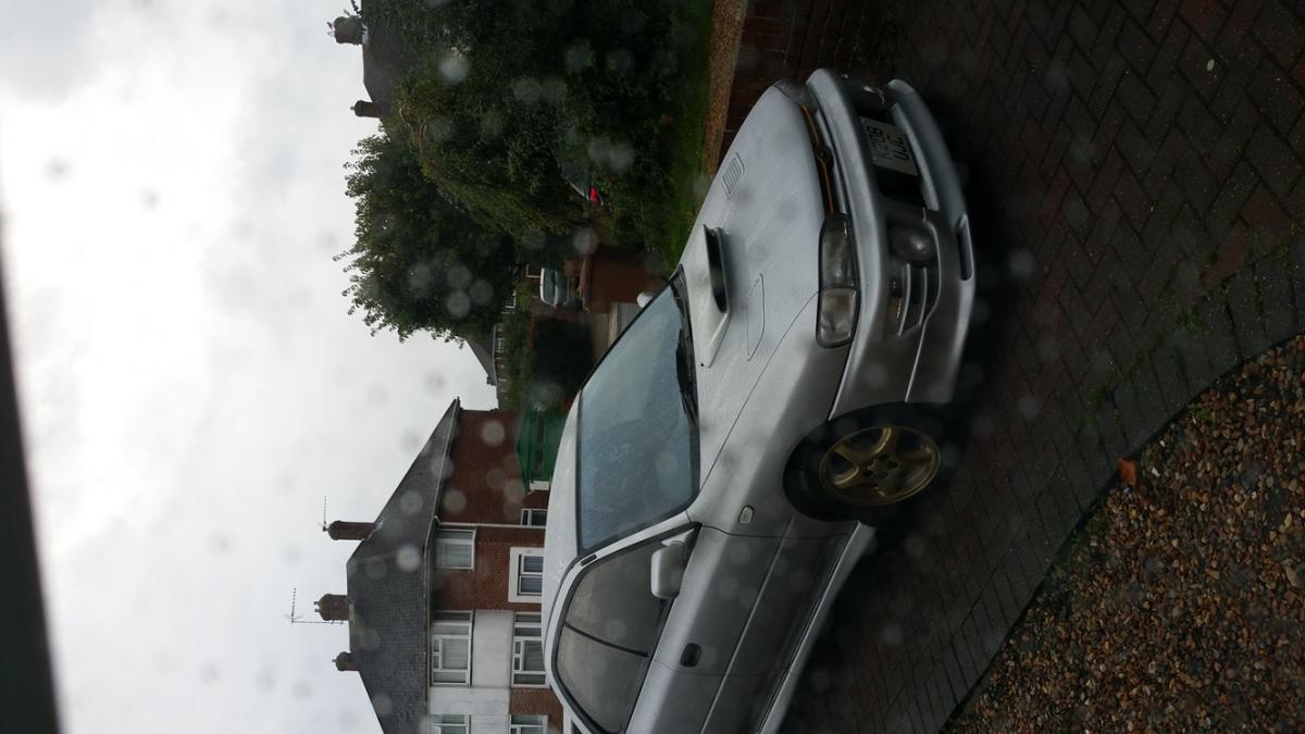

Still got my 96 legacy GT but decided that was not enough I just bought myself a little project which I think was about to be scrapped(couldn't let that happen) I have an early version 1 Import which I must say is brilliant. It's as clean as a whistle bodywork wise but the engine needs a bit of going over. It has quite a bad oil leak from the rear of the engine so I think I will have the engine out and replace all gaskets and oil seals. It's the fully closed deck engine the bottom end of which was rebuilt last year (new rings rods and shells) I would like to keep the old girl alive as I think there are not too many version 1's around these day's, I may be wrong probably am but I love it. Will throw a couple of pick's on when it's stopped !Removed! raining.

I'm not planning on any mod's, just hopefully going to restore it back to it's original beauty, although saying that I do plan a colour change I'm not keen on the silver. Bonnet scoop has got to go in favour of an original for that model and the only other non original mod's are likely to be a full decat stainless system and the Z4 ecu which I have already replaced for the original C2 model. I love the look of the mod'ed scoob's they are so varied and stylish I just think I want to keep this as original as I can. I'm not sure the boot spoiler is original either but that suits the car well me thinks. The leak I have discovered is the front crankshaft oil seal so I will be replacing all the seals on the front of the engine when I change the cambelt. Any advice on any other aspect of the way the car looks in relation to how it would have looked originally would be much appreciated. Thank in advance people your assistance is always much appreciated.

The spoiler looks like the standard one on impreza wrx and sti up to v4 ,apart from the a few special models
