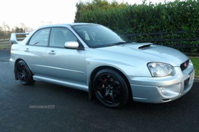

Can I steal ur thread and ask wat grade I should use on my 05 blobeye
post-1754-0-37392900-1387712493_thumb.jp
I think on the Blobeye I use 5-30 but the bugeye I use another grade without going out to check I can't remember off the top of my head. Opie-Oils is shut now for christmas so be after Christmas before Tim will be able to reply. And It's his Birthday today so I'm guessing he will be building up to speaking to god on the big old white porcelain telephone :D
I use helix 5/40 fully synthetic, that's what opie oils recommended to me
great cheers guys 5/40 fully is wat I was thinkin
