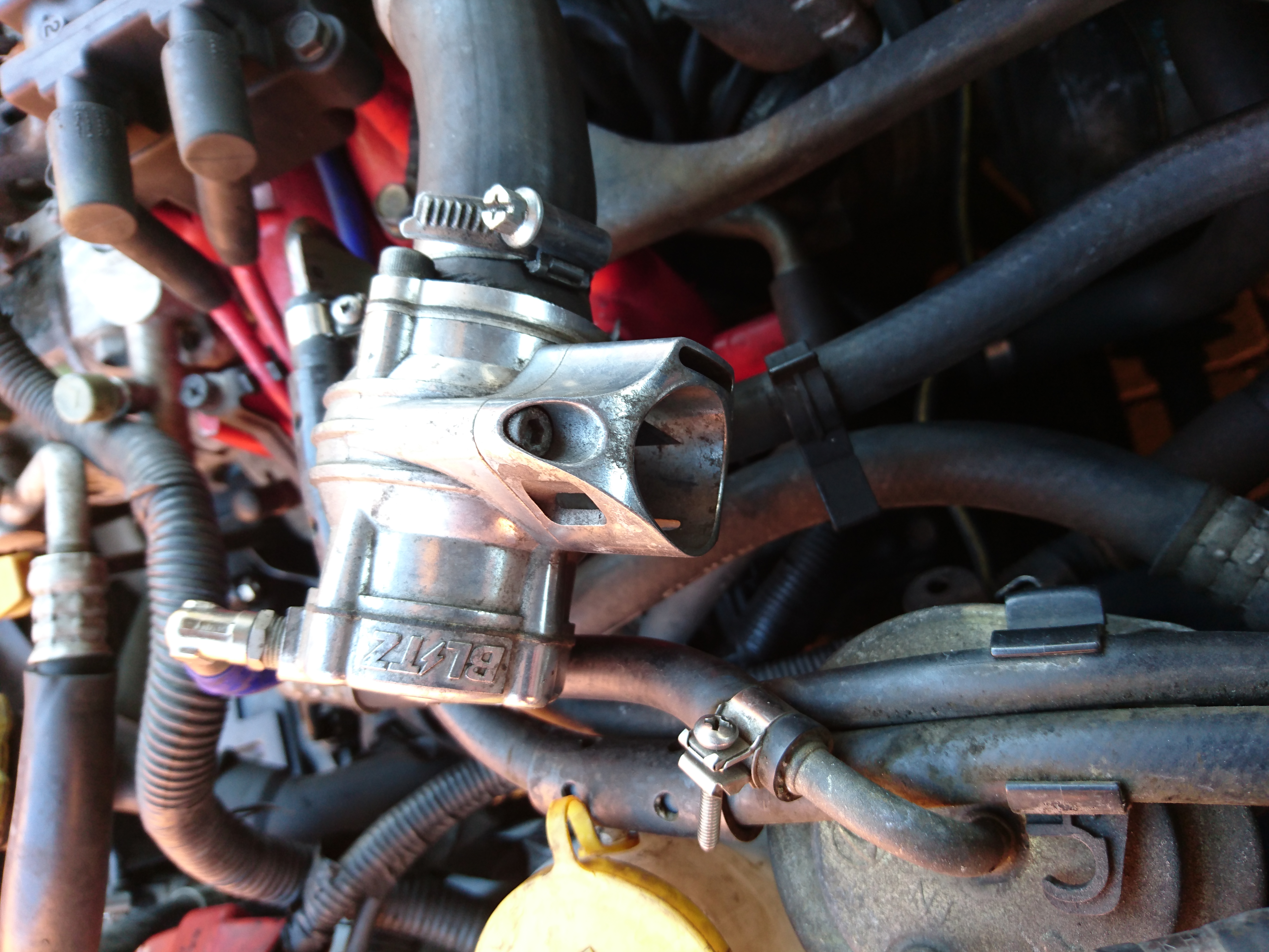

just had a general health check from allen jeffery plymouth I'm sure most of you have heard of him did a full check over and also got rid of the litter and small remap but also noticed that i had a one way valve which was removed and was able to get full boost from this....however, the blitz dump valve does not seem to be loud or is it meant to be non existent noise?

yeah i have checked for any adjusters and there is nothing quite disappointed by blitz i always thought they were meant to be loud and a good BOV.

Is the spring in the DV adjustable? Are you able to see the piston move when boost is dumped? Spring might be a bit too tight

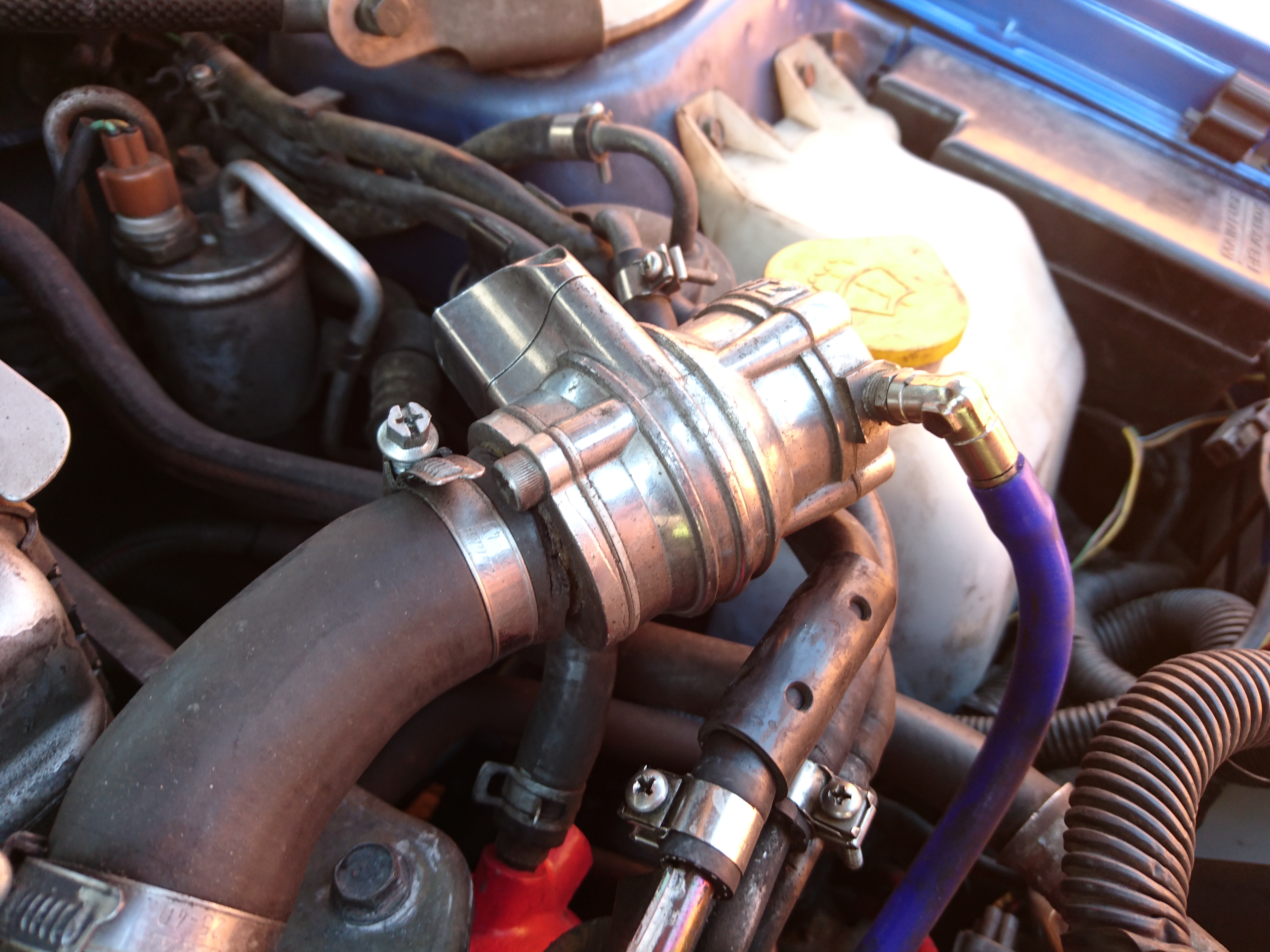

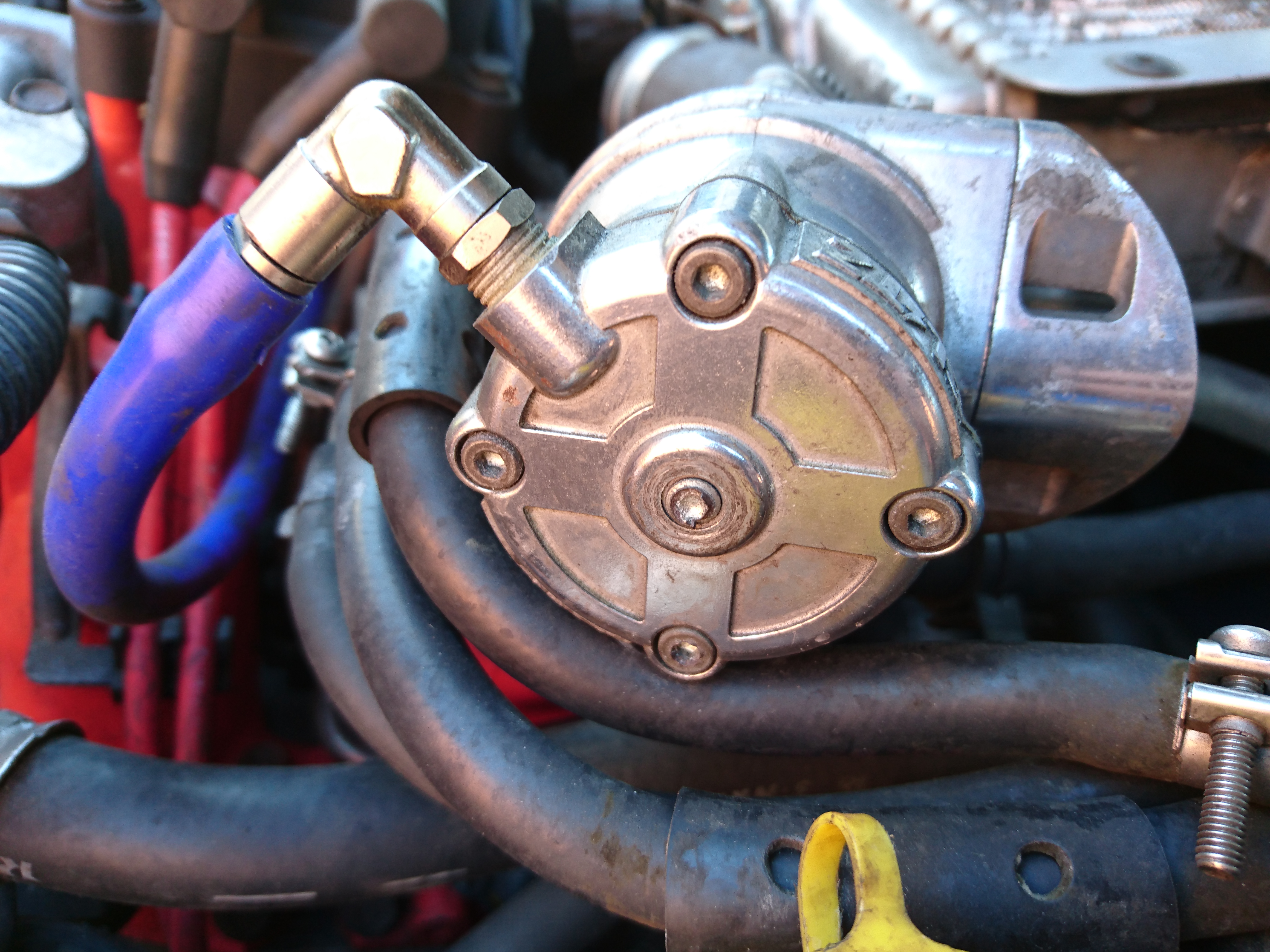

hi all, the only thing that i can see that might be an adjuster is the thing at the end but am not sure?
If it's anything like mine, you can possible loosen that to soften the spring... does it sound louder when you rev it when the bonnet is up? Can you see the piston through the trumpet?
yeah my first guess would be the center allen head crew in your 2nd picture if its anything like my GFB BOV then unscrewing that will soften the spring on the piston and require less pressure behind it to release all that BOV noise goodness

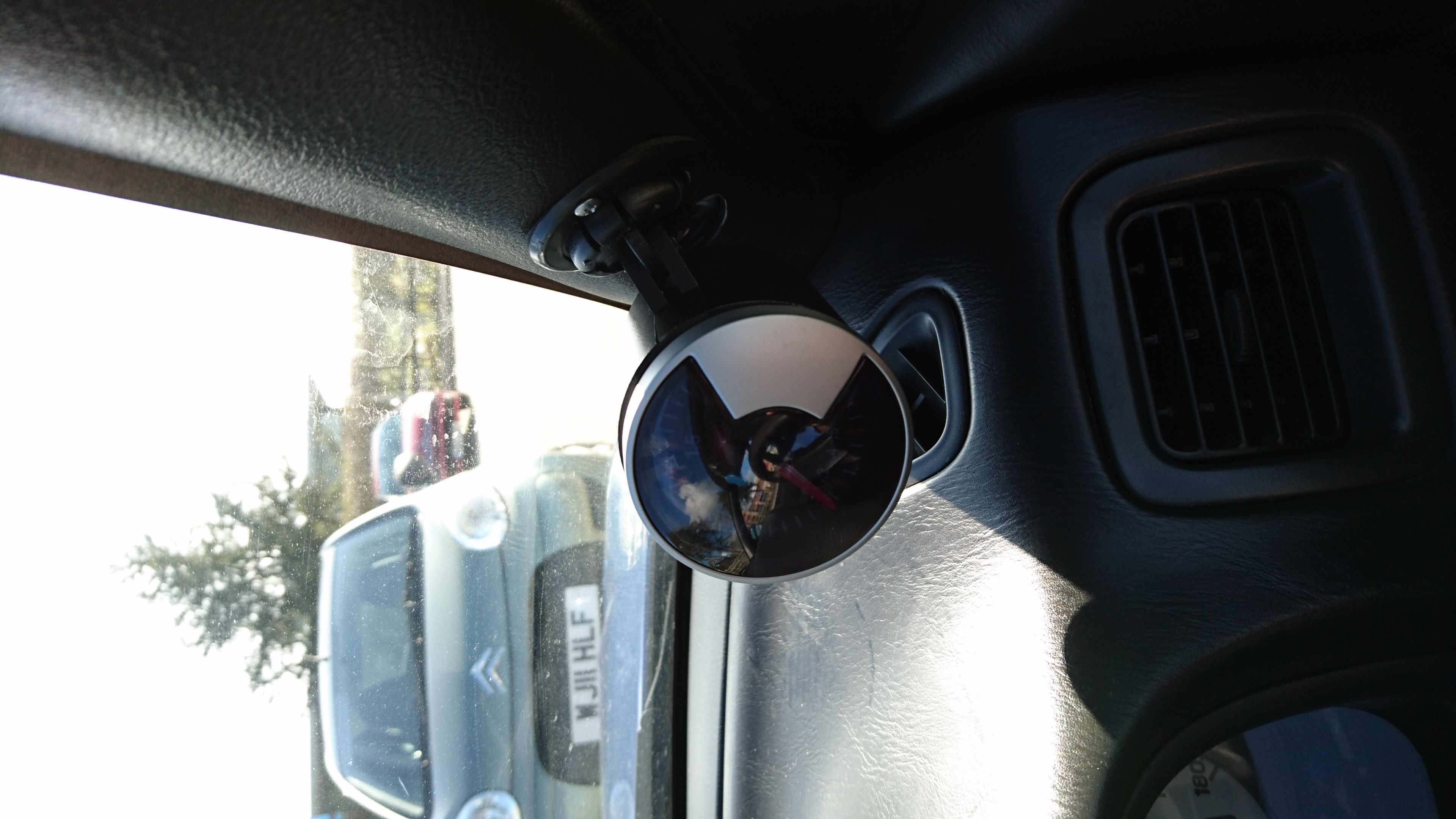

not the best picture and i have it so that the led light come on when the lights are on......now need to look into the dump valve...
that doesnt look bad mate what make is it? ive gone for the prosport evo (evo is the model of the gauge not the car its for) gauges i think they look real sexy just waiting to get 2 more to fit them in a triple pod holder that sits in the center of the dash
