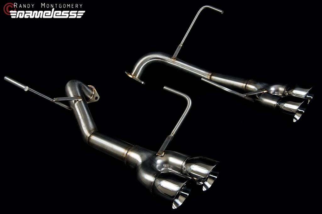

Don't really want to spend  £450 and end up with reduced power. May leave as is. I think the quad tail pipes are too tucked away they needed to be more level with the rear bumper.
