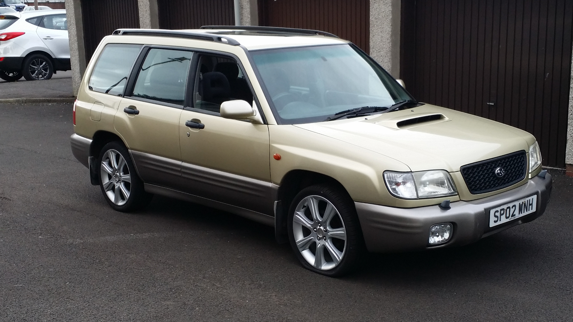

Bought the car from a car breaker, needed a coil Spring, exhaust and the Abs light is on. It's a one owner with full history and 90,000 miles. Put a spring on it, a decat pipe removing the second cat. Sebring centre pipe and rear box from an Impreza but no idea which model Impreza it came off. Legacy 18" wheels and a new set of tyres to go on this week. Any ideas about lowering it ?  Do any Impreza springs struts fit or is it only coil overs for the best result ?
