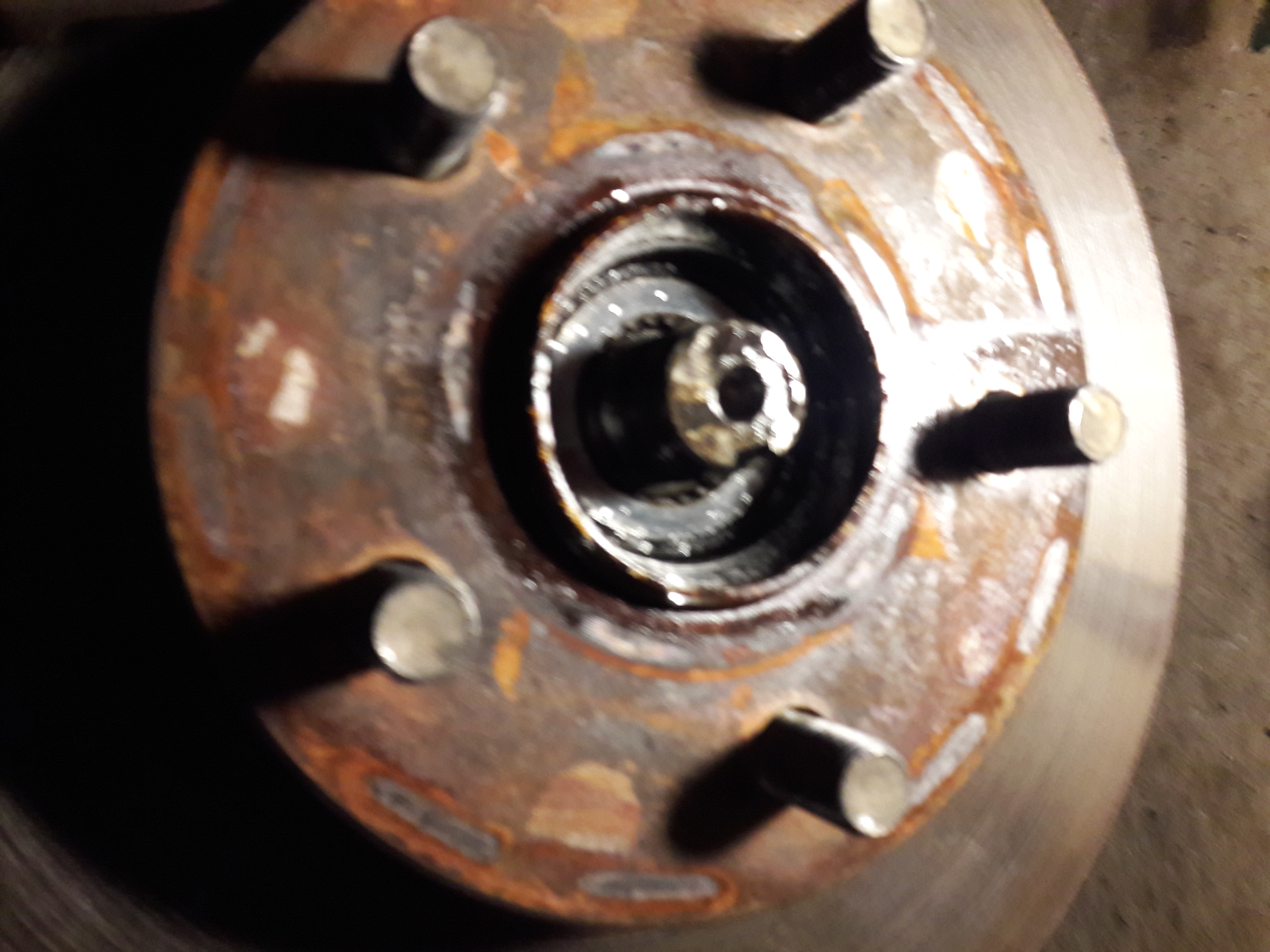

Cv axle problems
95subieman
Yeah a bit of heat and a puller should do it but if not see if you can get a local engineers or fabrication workshop with a hydraulic press to press it out i've seen some shafts take 10-20 tonne of pressure to get them out, they can get quite a hold if they've not been out for a while or indeed never been out at all :biggrin:
