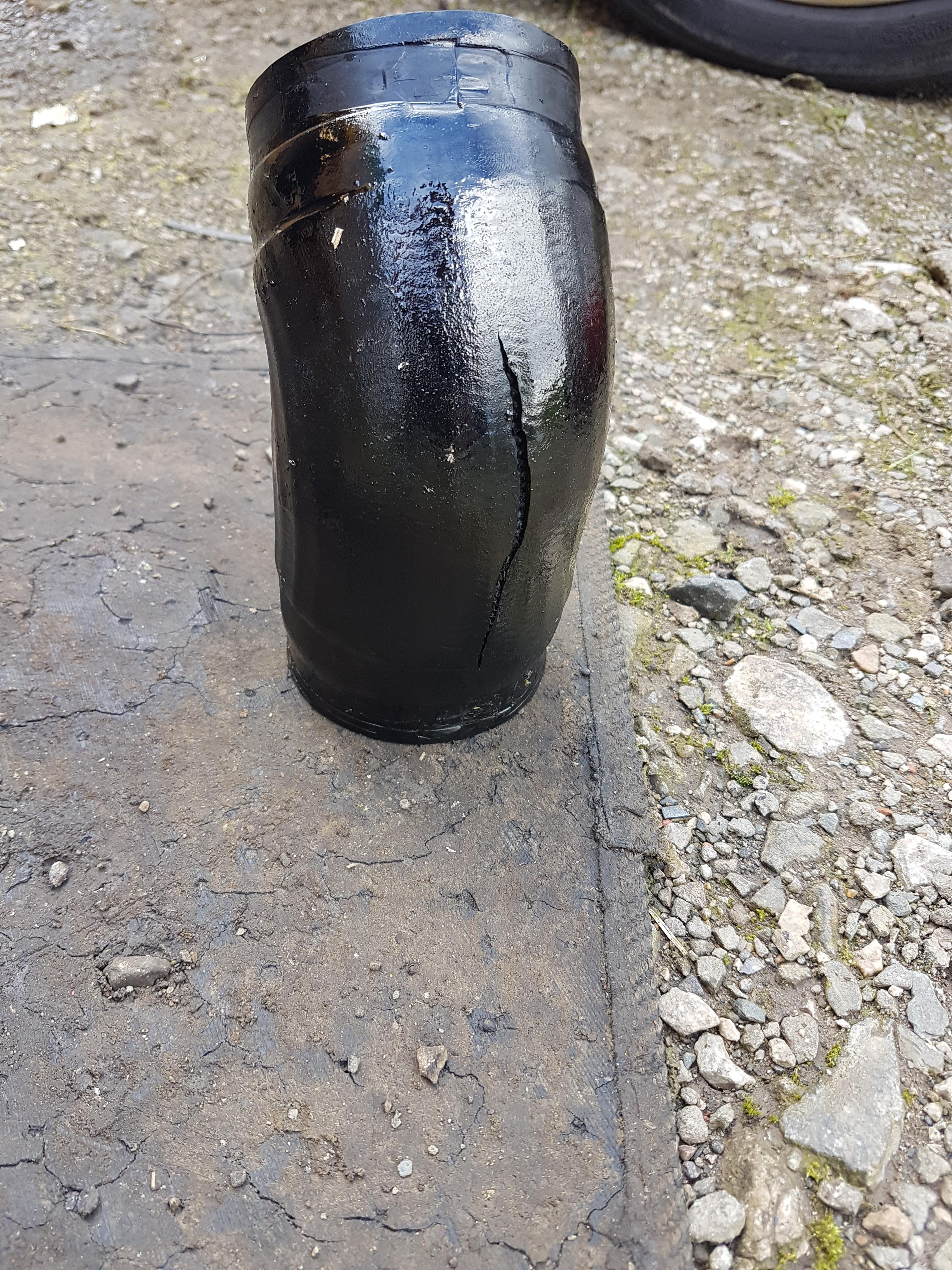

Well currently trying to get to the bottom of a fueling issue at the min. When i put my foot down in 2nd i get a lot of grey smoke all the way through into 3rd until around 3250/3500rpm. Iv cleaned the map sensors as it was clogged up, cleaned the maf sensor, cleaned the egr. Iv got a new fuel filter to fit next and gonna fully blank the egr see if this helps.
Sent from my SM-A300FU using Tapatalk
Cleaning the maf sensor on a Nissan a while back, air intake cleaner didn't work, electrical contact cleaner didn't work... in the end it was wynns egr cleaner that worked. Maybe it was something else I done, but the car ran alright after using that spray.
Scan tool showed the car was thinking it was running lean, so it would adjust fuel trims and made it run rich... then really rich... then back to 0... then again rich, really rich then 0 etc
You could slightly hear a different exhaust note when idling while it was doing this
Cheers for that. I actually unplugged the maf on the way home from work and it was 100x better so its looks as tho thats the fault. Gonna order a new one to be safe
Wotcha and welcome - One thing I would say is dont use cheap fuel and keep sticking an additive in every 3 tanks or so - The fuel is getting more an more bio added to it my merc vito was throwing out black gunk from the exhaust, it took a BG products clean cycle then use of additives to sort it out but it all runs a lot crisper now - and no gunk
Using fuel with added ethanol used to bring up the P0420 code, would go on and off.. takes a couple of drives for it to go off so took me awhile to figure it out!
Read somewhere online over a certain percentage of ethanol is not good for some lambda sensors
Just stick to Shell vpower now
  • 2 months later...
well thought id update this as is was playing up for a while, finally found time to work on it in between my day job, customers cars on the weekends and also planning a wedding :rolleyes:
Turned out i had quite a big split in a boost pipe  which was causing all the problems.  So ordered a bit of silicone of eBay and fitted that along with my homemade egr blank plus a new fuel filter and oil filter with some fresh oil and that was that.  Plugged everything back in as it should and Voila what a difference, pulls really well now so want to get it on a dyno to confirm the supposed 211bhp.
