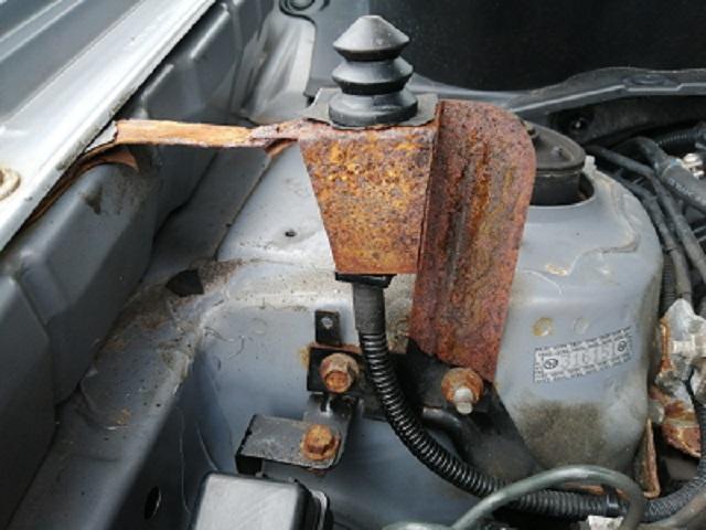

I've just bought a 59 plate Forester (my very 1st Subaru), it's a single button fob which when I press it to lock up the car beeps 5 times then the alarm goes off, press it again alarm stops and drivers door only unlocks. I'm assuming it's the standard factory fitted alarm. I've no owners manual so has anyone got any ideas what the problem might be?
door boot or bonnet not shut or switch issue /
check the bonnet switch as they on a bracket that tends get bent with people leaning in engine bay  ...
Use the manual link in this thread get basic understanding of your alarm .
Is this the bit that you mean? It's quite rusty so I'm guessing that could be bent, doe'snt look easy to replace either!
Yes, you can simply test with bonnet open by holding switch down with one hand and arming alarm from fob with other .
We relocate those switches sometimes as pretty poor effort by sigma .
Easy enough fab a bracket /use another generic alarm switch and lengthen wiring.
in a pinch easy enough jump the wires so alarm thinks switch always pushed in .
don't rule out doors and boot if bonnet switch doesn't appear at fault .
you could keep the switch in with a cable tie for a temporary measure.
Is easy fix or relocate.
If garage charge to pricey picking up a used bracket online should not be too hard .
Yeah just having a look on eBay there's a few breaking Foresters so might just drop on one, thanks for the advice it's really appreciated.
