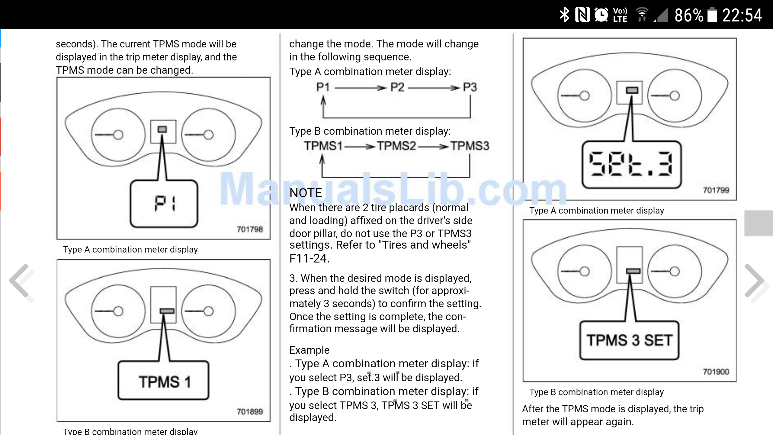

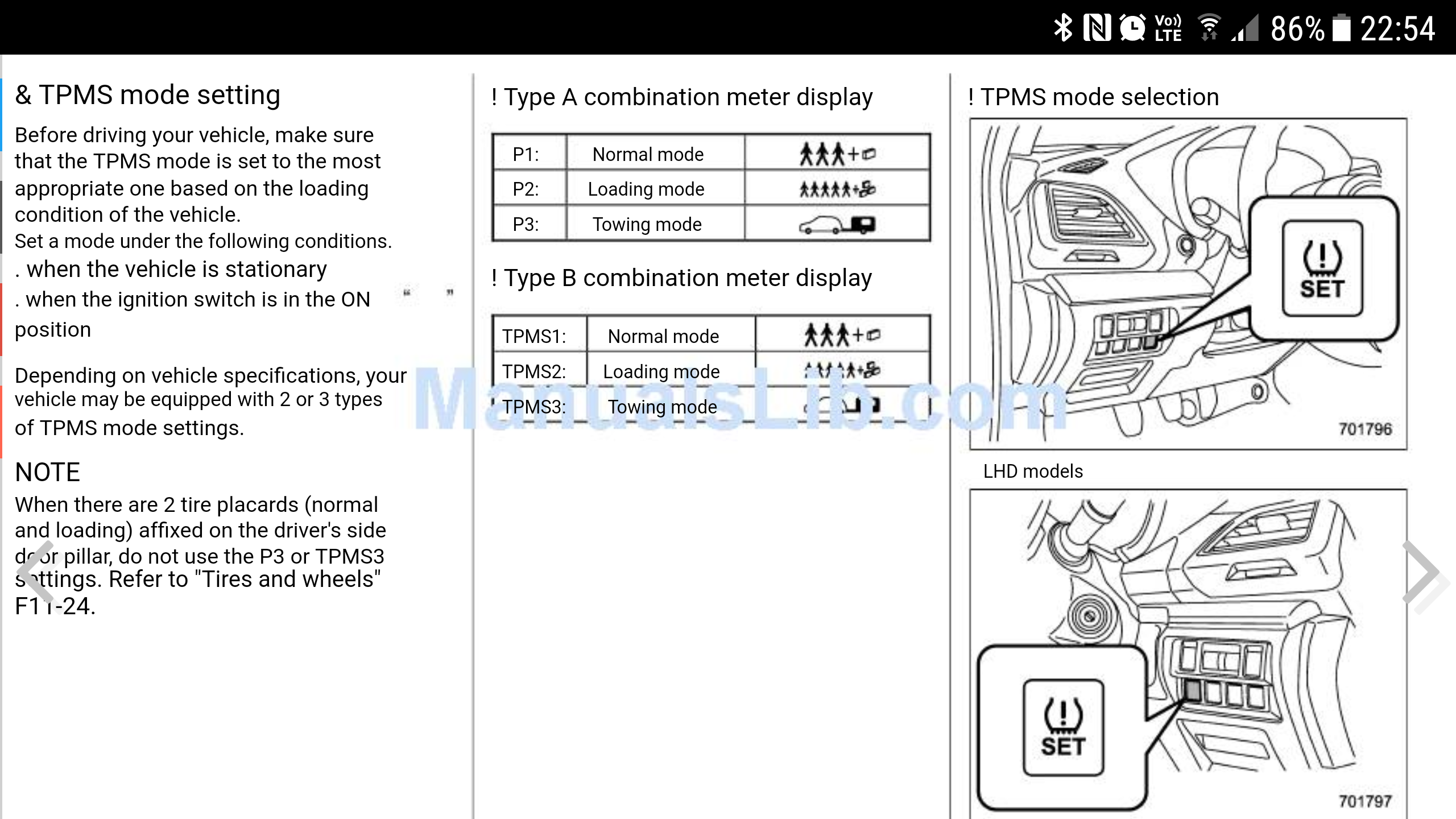

Ok, if I've got this right, this is how it works.
There are either 2 or 3 tpms settings, depending on age and model, I think we've just Iot the first 2.
1, Ordinary
2, Loaded (with passengers)
3, Towing
Press the tpms button till it cycles to what you want, and hold for approx 3 seconds, that'll set it for that loading.
You can set it to monitor your pressure depending on who or what's in the car.
Screenshot_20180201-225422.thumb.png.8d1f50309354fd9342b007d5704b6630.pngScreenshot_20180201-225442.thumb.png.044ad75966358960fefca5388fcb86ab.pngScreenshot_20180201-225501.thumb.png.dff08e90579a8a8e3e441167c69bfc07.png
