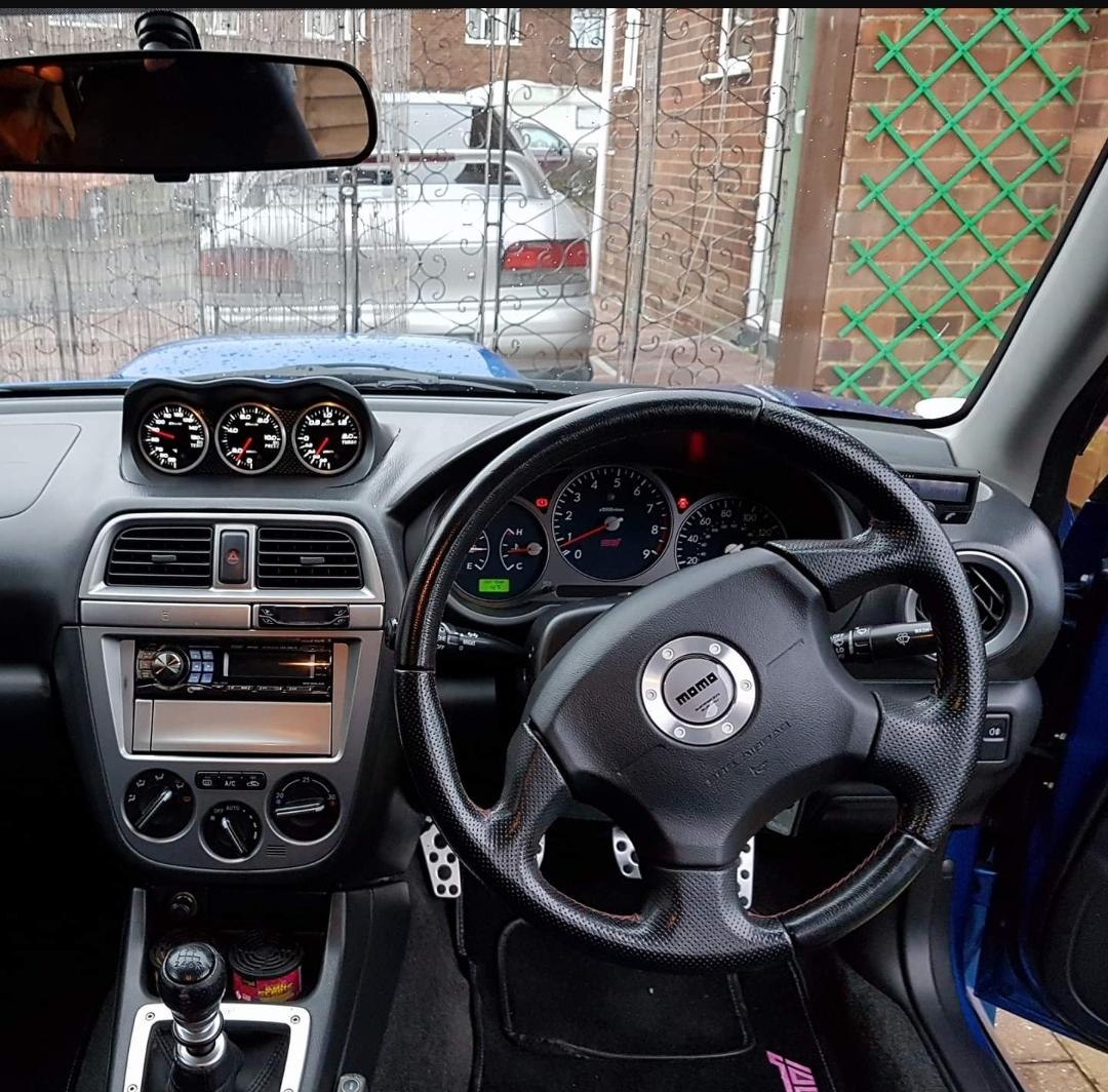

I've noticed there seems to be a few variations on the instrument clusters, mine has the speedo on the far right with the rev counter in the middle.
I've been told my 52 plate UK sti has had a jdm clock swap , did wonder if there was supposed  to be a "sidelight on " light .
Dont know if yours are the same clocks as mine ?
In mine when the side lights are on,  the clocks ,switches and gauges illuminate .The digital outside temp odometer LCD screens dim a bit as well .
I have left them on a few times but thankfully ,they shut off when the keys aren't in the ignition .
I wouldn't take it as gospel , I'm not up to spec on newage,  I've never seen one on my dash and so try to use the change in back lights as a reference when driving,  instead of looking down at the stalk position
I do tend to use the side lights more , as loads of newer cars have daytime running lights and you do tend to notice them .
