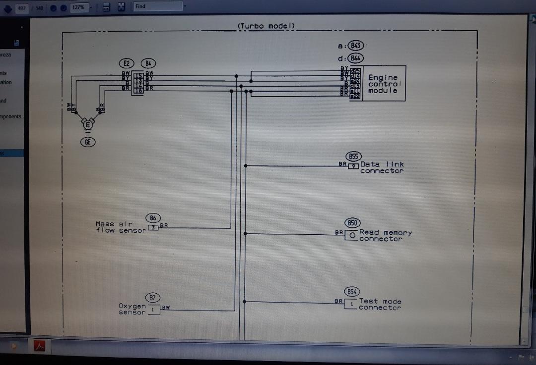

I can't remember if the 02 sensor wires spur off from the main engine loom , if so check the grey multi plug (near the battery and clutch slave) pins are making good contact . Also the engine loom ground that attaches to the inlet manifold, near the fuel hardline flow and return.

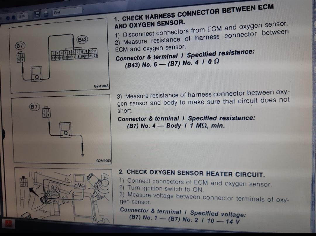

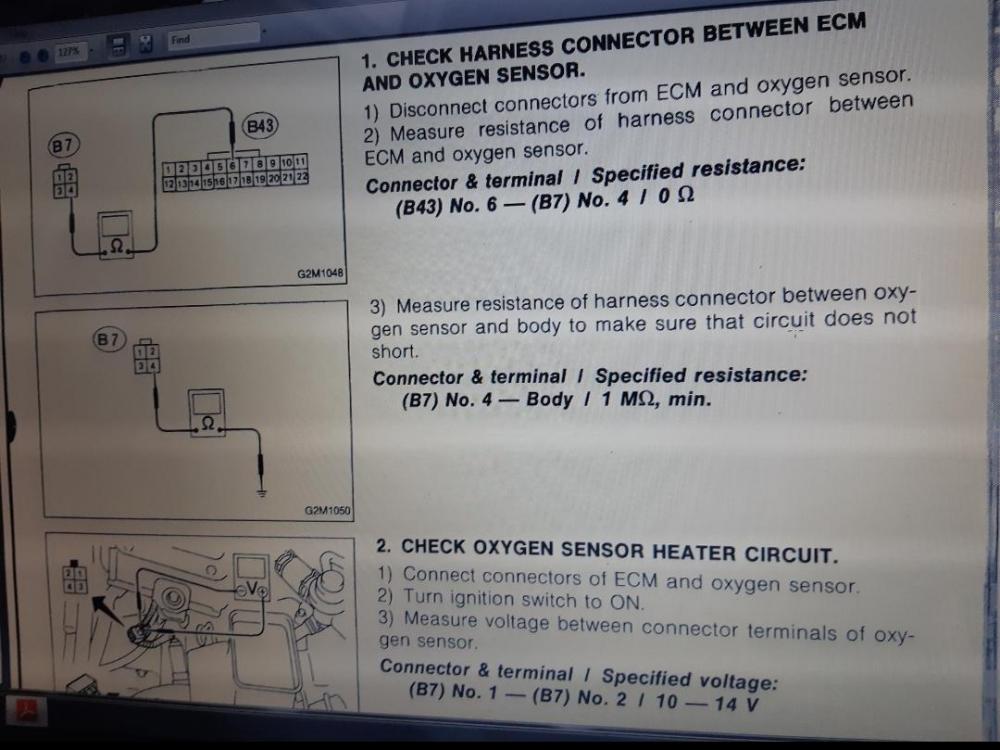

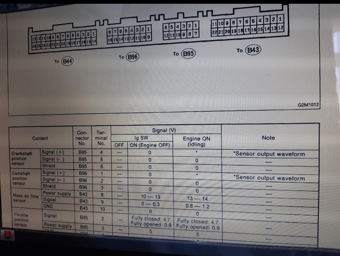

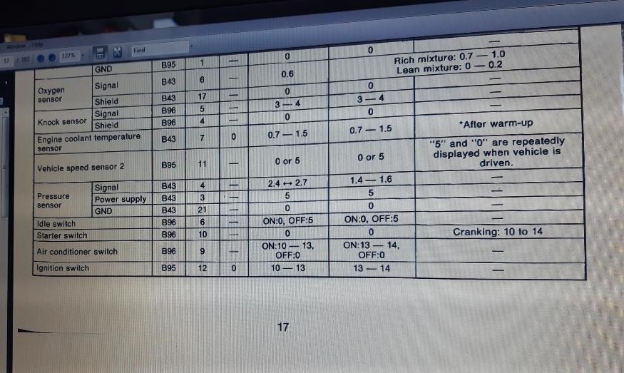

Don't know if you've got a service manual? But here's a few pics that I have on my phone that might help .
Screenshot_20200404-162001_Gallery.thumb.jpg.93d4d170bebe0e9452037b9340865a0d.jpgScreenshot_20200404-161827_Gallery.thumb.jpg.1f0ff5b8bd64613953c71d2c9734efb4.jpgScreenshot_20200404-161928_Gallery.thumb.jpg.3a566345f87a64b2ace8ee2ebdcd2ecb.jpgScreenshot_20200404-161914_Gallery.jpg.3697bb38b93a006cf28c032f4971a934.jpg
