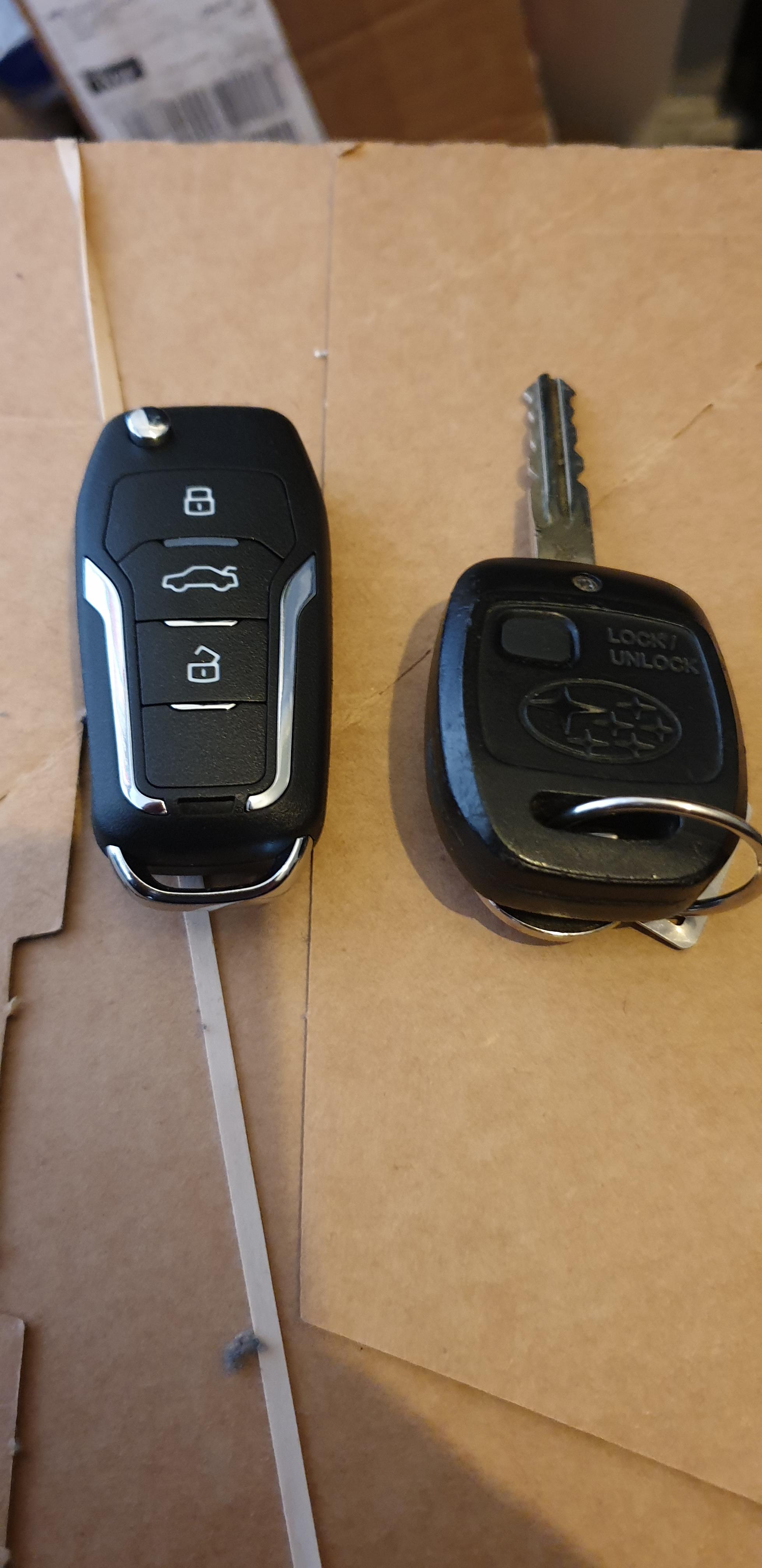

Right so lost the spare key for 2005 WRX BLOBEYE so decided to buy a cheap £20 eBay key fob for subaru impreza.However following youtube tutorials I cannot manage to program it to my car.
Anybody got some suggestions.
Would be much appreciated thanks guys20201209_103128.thumb.jpg.94be9997e10fd677a63c99934ca59796.jpg
Doubt it will work with the m30 alarm .
try using programming method below .
If no luck buy a used single button m30 fob or fob-key and remove key to make it a fob .

I'm trying to re-program fobs (one that is working currently and another one that I bought online) using the PIN code (I got it from the dealer and it works, I can arm the system with it) but I cannot get that procedure to work. After # key I'm pressing a fob and if I press the one that is working, it will just arm the system instead, if I press the other fob, nothing happens.
Any help appreciated.
