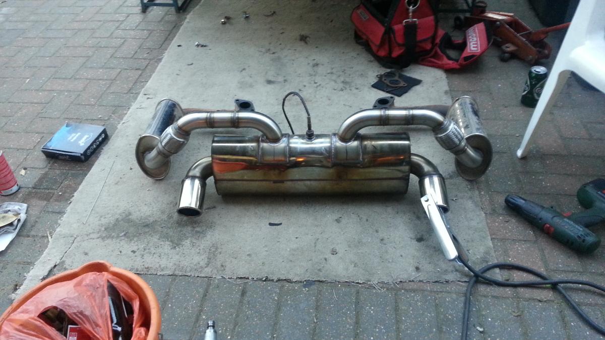

I have recently installed an ej22 n/a engine into my vw T3 caravelle which I have to say is an awesome engine. I am getting slightly hight readings from the emissions. I know it won't be spot on as no cat but when my mate had the engine in his bus with a different exhaust his o2 level was 0.46% compared to my 1.91%. I have a twin exit tvr exhaust with 2 powerflow silencers added.  The o2 sensor is positioned in the tvr silencer as I have attempted to pick up both manifolds but not sure if it's getting a good hit of gasses or maybe they are too cool,Would it be Ok if I positioned the sensor so that it only picked up from one manifold or would this not be a good idea. I was thinking somewhere near the flexi. Any other ideas are welcome as it's definitely running rich.

post-1626-0-58927600-1383247964_thumb.jp

Ps did you see the pic
Yup I looked at the picture,
the original system has a two into 1 manifold then a cat then a sensor then another cat then a silencer.
you have two silencers into a big silencer and twin exits this - irrespective of distance travelled is going to disturb the flow and mixture due to the circulatory nature of the silencers as opposed to a cat which is straight through perforated material
You can move the sensor closer to the down pipe but I think overall you may be looking at a redesign of the exhaust to get an undisturbed flow, a two into one before the silencer or a twin sensor setup
