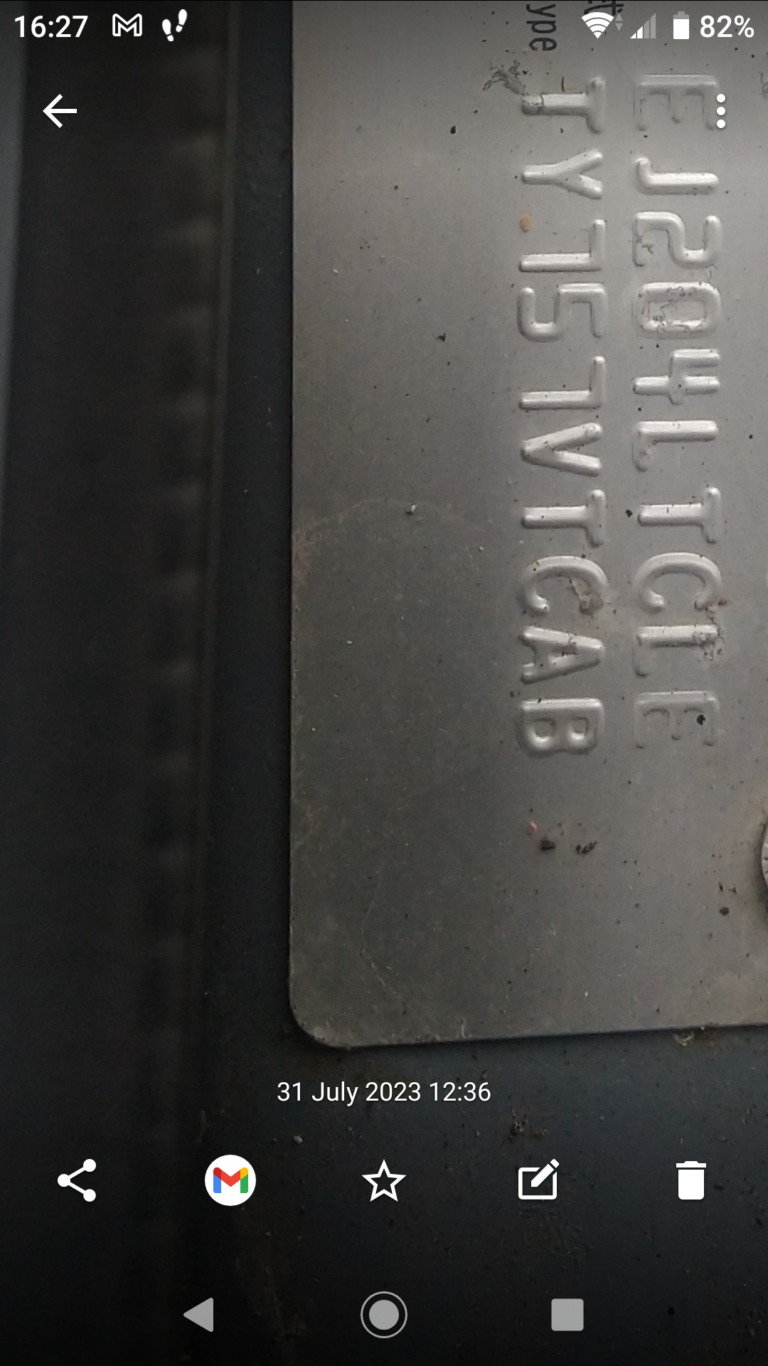

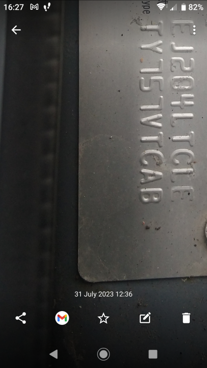

On manual 5 and 6 speeds the code is on a white sticker on the bellhousing near the starter motor (ty####) .
Otherwise if its definitely the original box it might be on a silver id plaque on the front suspension turret .
