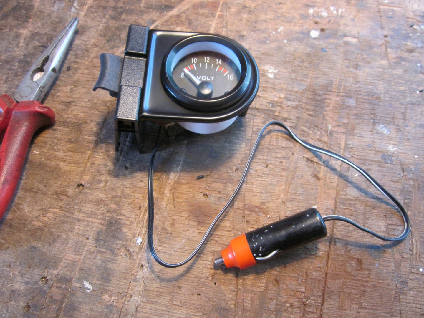

norfolkRX Posted April 7 Share Posted April 7 SFBS, and Yes, I'm another 'victim' of Subaru's poorly designed electrical system. I got a "you want to go somewhere, well not today Mate" from the car this morning. The Battery was showing only 4 volts and Yes, it was partly my fault for leaving an interior light on, but come on, should a car with so much electrical equipment & stop/start be fitted with only a 65Ahr Battery as standard? And given the car has so many safety systems on it that protect the driver from themselves, why use an incandescent bulb for the interior light (which might be left on by accident) when a low power LED would have been more suitable. This circuit should be timed to be switched off sometime after shutdown - I can't see any reason why the interior light would want to be left on in a locked car (other than by accident). On the binnacle on top of the dashboard it is possible to display some useful info like Water Temperature, Oil Temperature and Average Speed . . . . Average Speed!! really? how useful is that, why not a Voltmeter given the car has so much electrical/electronic stuff on it?? Anyway I'm going to fit a voltmeter in one of the redundant cup holders (I don't drink and drive) in the centre consol - it will be powered from the nearby accessory socket. I've checked that power is removed from this when the car is switched off. While I'm on the subject of electrics, why can't you default off the stop/start system? Rant over . . . . 'til the next time . . . 😉 Quote Link to comment Share on other sites More sharing options...

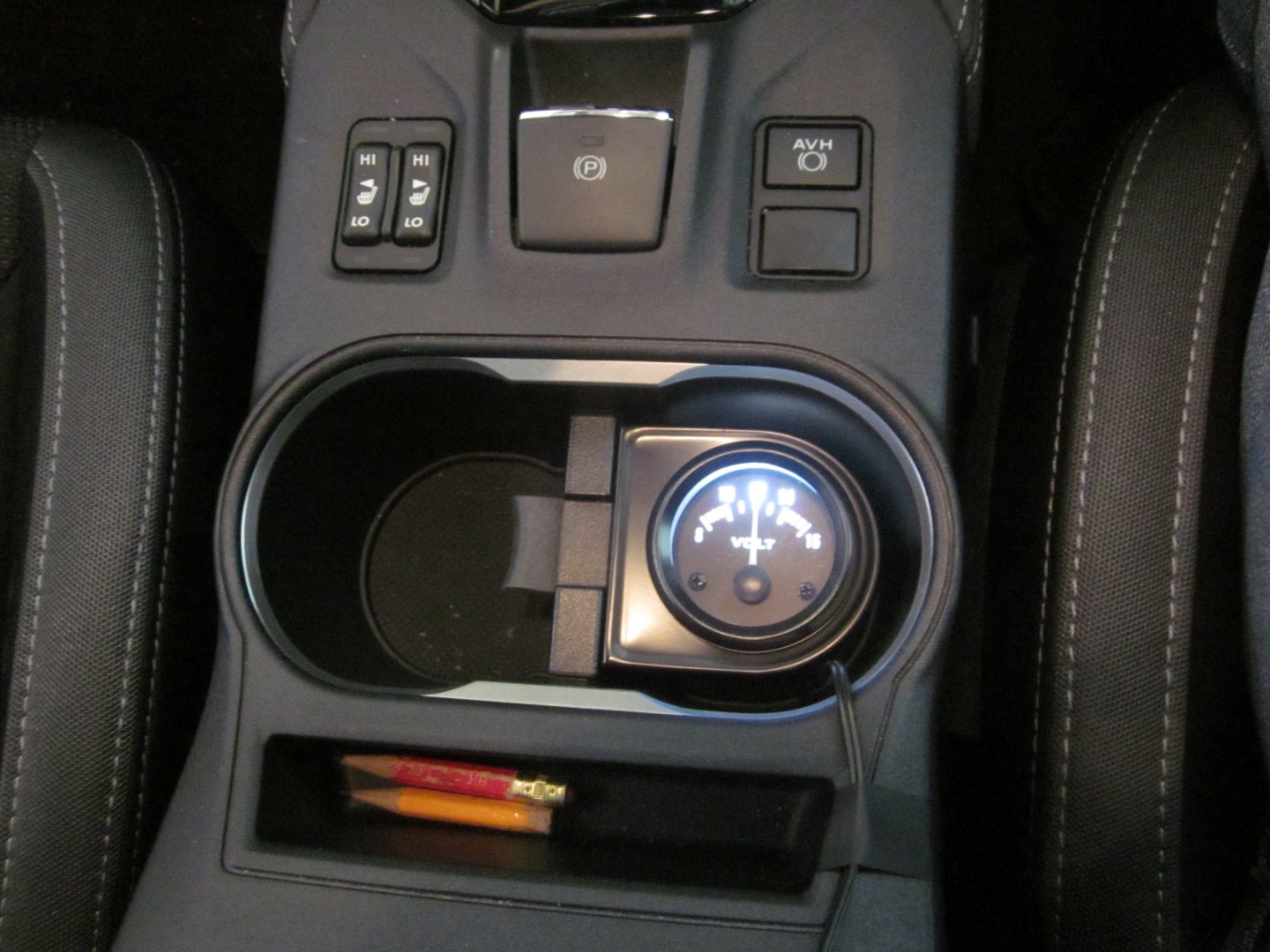

norfolkRX Posted April 7 Author Share Posted April 7 Well, I fitted the Voltmeter which I got from:- https://www.amazon.co.uk/Gorgeri-Universal-Voltmeter-Voltage-BX100007/dp/B08CNFBPMG/ref=asc_df_B08CNFBPMG/?tag=googshopuk-21&linkCode=df0&hvadid=499298107818&hvpos=&hvnetw=g&hvrand=18332633606580583942&hvpone=&hvptwo=&hvqmt=&hvdev=c&hvdvcmdl=&hvlocint=&hvlocphy=9045081&hvtargid=pla-1004357903227&psc=1 other Voltmeters are available . . . It turned out to be a neater installation than I had expected and more importantly - less work! The supplied bracket can be screwed to the centre cup divider, leaving the other cup holder still usable. The whole installation is easily removable and the only damage from standard is two small holes in the centre divider. 3 Quote Link to comment Share on other sites More sharing options...

norfolkRX Posted April 10 Author Share Posted April 10 44 minutes ago, Justin Time said: You can also check on the battery status/charging- volt level - if you go into the 'hidden' dealership and/or factory settings mode on the infotainment system. Press and hold the 'home' button while simultaneously pressing the tune button 4 or 6 times - then toggle through menu to find charging value in volts. Yes, I found some of your previous posts on this - thanks. I'm not sure how useful the setting is as it only says it's charging (14.3V) or not (12V) - but not Battery health other than by implication. It's much like my voltmeter, except my old school solution doesn't need setting up each time and is visible all the time. An ammeter across the Battery terminals would be useful for checking the level of parasitic currents that are usually present and if anything else is adding to them. At the moment I'm looking at replacing lights, that might get left on by accident, with LEDs. The dealer I bought the car from did actually warn me not to leave the car unlocked or the doors or hatch open without having the engine on - this was a first for me!! Do you know if setting the key fob to sleep also reduces how often the alarm system is looking for the fob and therefore reduces the drain on the car Battery? Quote Link to comment Share on other sites More sharing options...

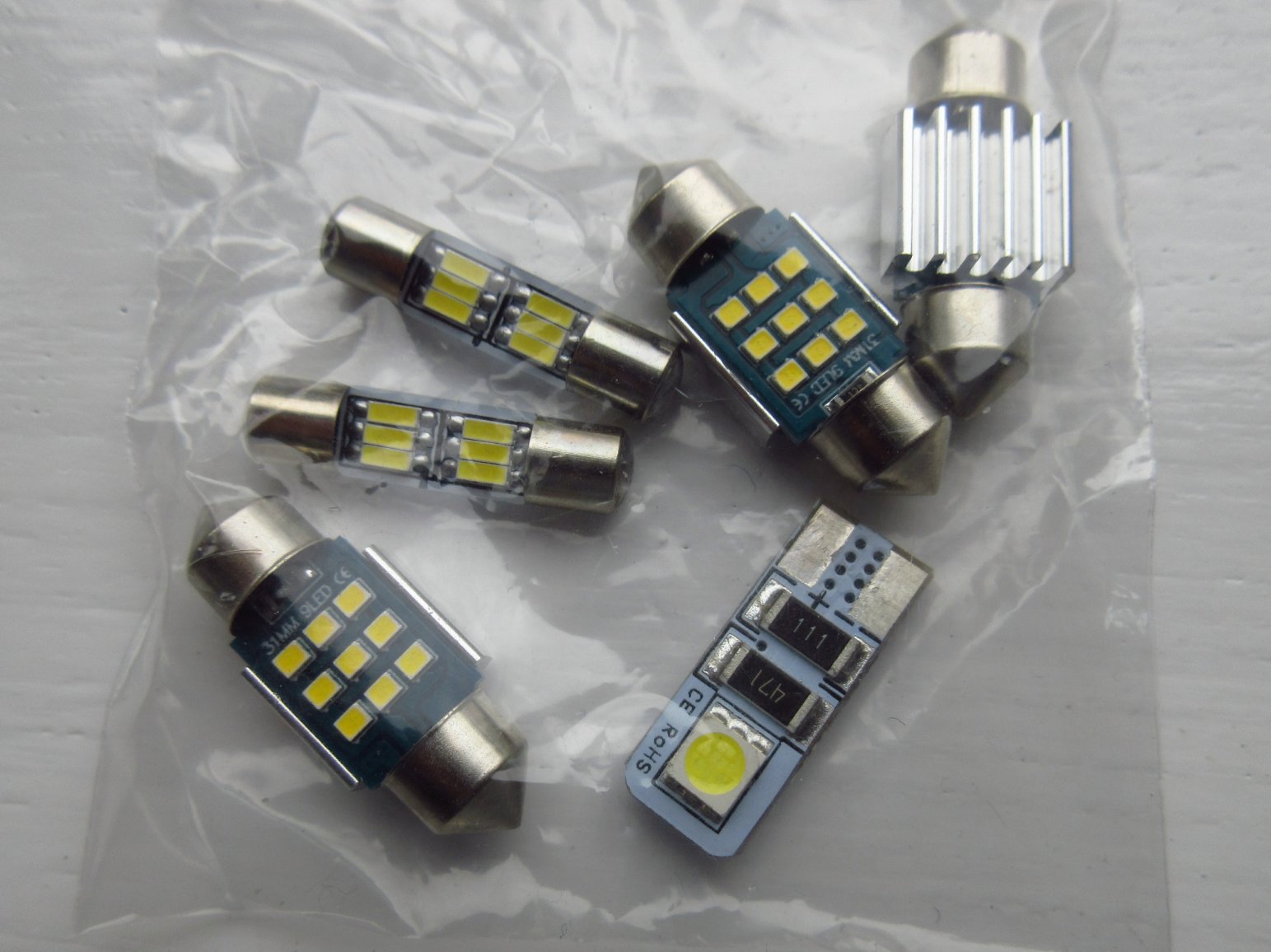

norfolkRX Posted April 14 Author Share Posted April 14 A selection of the LED replacements for the interior bulbs - the festoon bulbs were a bit of a struggle to fit as although they are the same length, the end caps are a different shape.The LEDs should reduce the current draw to between one third and one quarter of the originals. Whether you like the bright white light of the LEDs or the yellowish light of the originals is a matter of personal preference. Quote Link to comment Share on other sites More sharing options...
