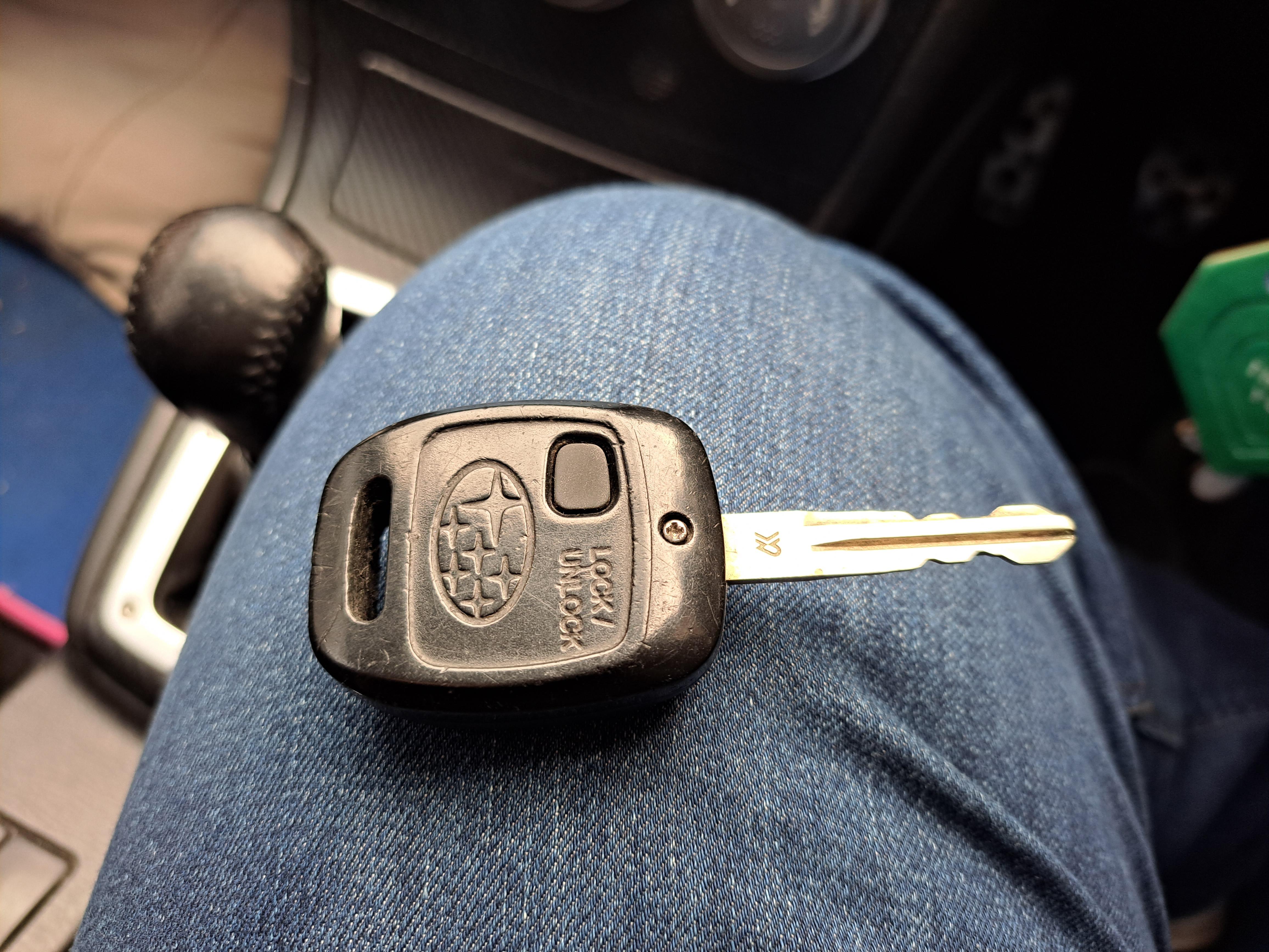

Hi all,
I took my Impreza WRX (05 plate) for its MOT yesterday but, during the test, the key fob completely stopped working and I had to rely on the Sigma passcode to get the car started. Originally, I thought it was just the Battery so replaced this with a new one.....still nothing. I had a read of the forums and took the key to a local auto locksmith to check the signal from the fob. Apparently this was fine but the immobiliser still doesn't recognise the fob. Tried to re-register the key using the passcode but this hasn't worked either. I also tried to re-register an old spare fob but this didn't work either.
In desperation I contacted a local auto locksmith in North Somerset who supposedly 'specialised in Subaru' but he was a lost cause! So, I have 2 keys, neither of which are recognised by the immobiliser/alarm and I am currently reliant on entering the keycode every time to start the car.
Any advice, guidance or support to help rectify this is greatly appreciated!!
Cheers,
Gareth aka Coffinhammer
