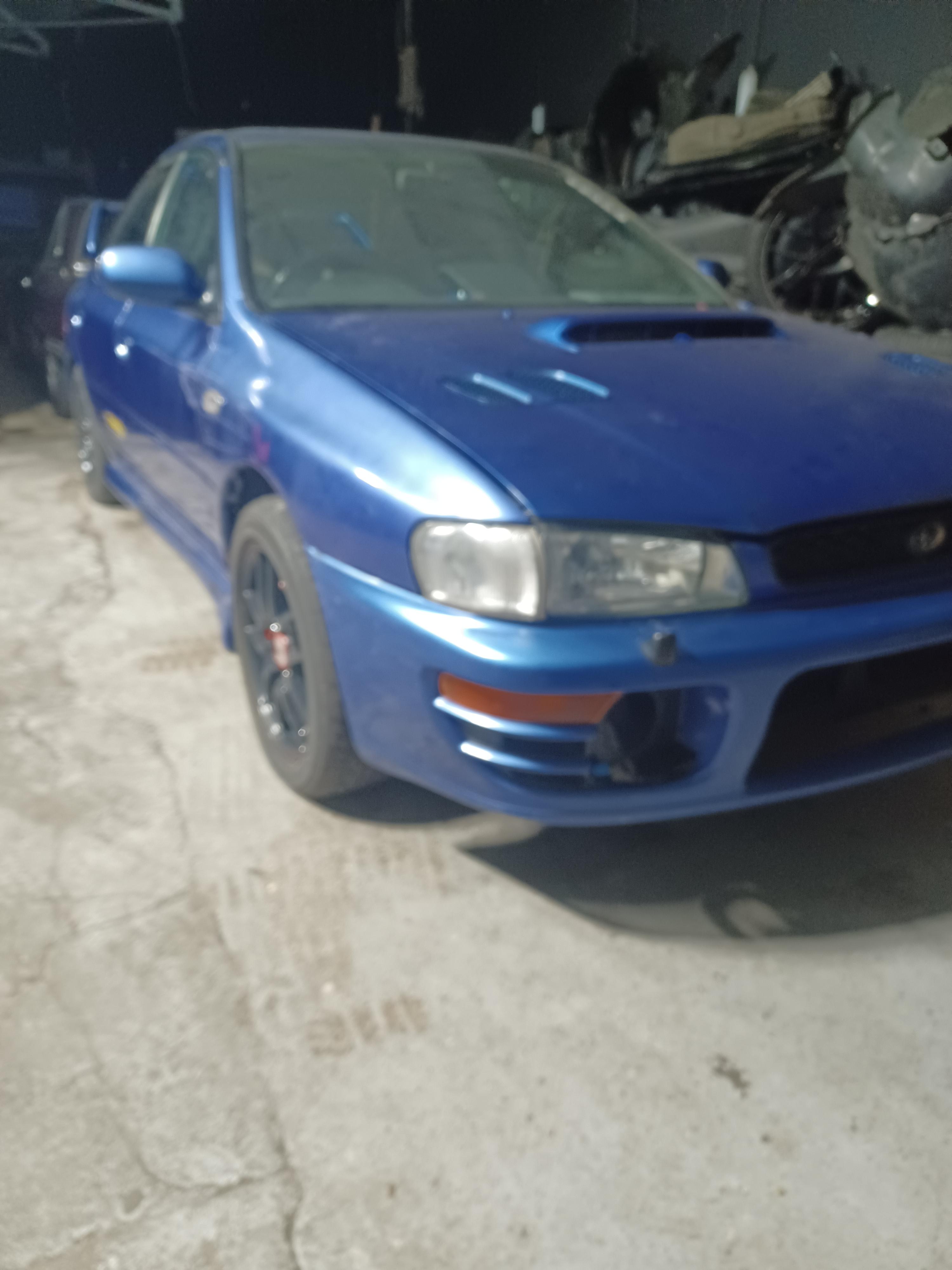

Hi there all hope you are all well. Need some help and advice. Have this version 4 uk2000 which has had an engine swap. Car started a few times but was idling really rough and also had a wiring short which has been fixed by an auto electrician now. The car has spark, has fuel but the car will not fire up anymore. I'm confused as sparks have been changed, coil pack has spark coming out. Leads have been changed.ignitor has been changed and Crank sensor as well. Timing belt and waterpump has been done along with clutch kit. Have opened the timing up again just to double check and all is bang on. What else could cause a Crank but no start issue?
