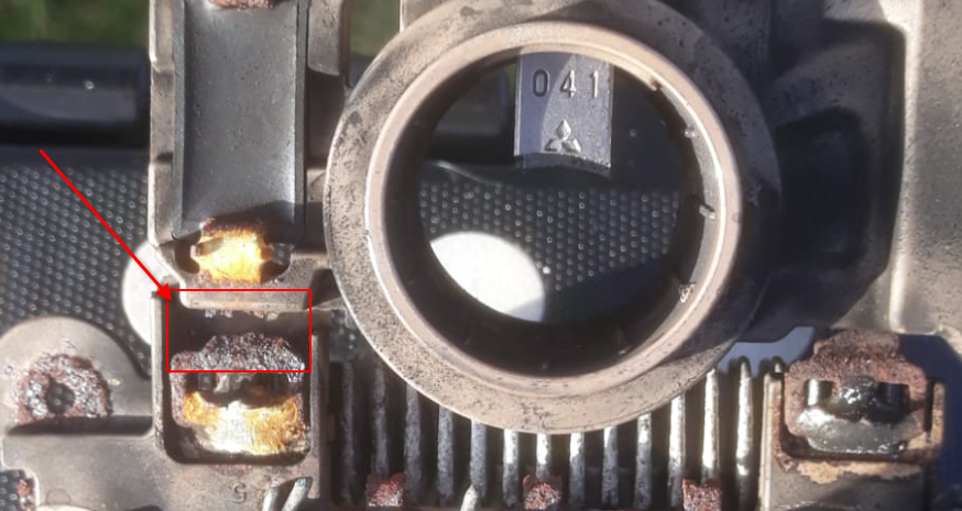

The alternator on my 2004 WRX recently failed.  This is a Mitsubishi A2TB5391 / OE 2700AA420.  The fault code P0558 - Generator Circuit Low Input is flagged in the ECU.

Thank you for your reply Tidgy.  The original alternator had failed due to corrosion of the electrical strapping between the rectifier and the voltage regulator.  I guess not bad after 21 years.
I did replace it with an AS-PL A5194 alternator that did not have this smart charge feature and the P0558 came back, although it was charging.  This was showed on the AutoDoc website to be compatible, but wasn't.  I have since ordered the AS-PL A5074 which is shown to be compatible by the manufacturer.
