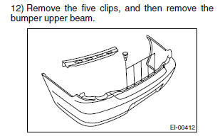

Hi all, I am in a state of confusion about what's needed by the guy repairing the back end of my poor car (see the Old Banger thread) and I wonder if anyone can help me get my head around what I need.
The repairer has assessed the car and says he will straighten the slight dink in the subframe with a jig. He has asked me to supply a rear bumper beam (which he originally described as a backplate) as that will be bent too.
According to the diagrams I have seen and now can't find again, there is the bumper skin (which I have), an upper beam (which the scrappie missed but will send on to me), then an energy absorption thingmy, then a rear bumper beam.
However the breakers have said there is nothing behind the bumper skin and the rear bumper beam is spot welded to the car. They are apparently experienced in breaking these cars. The diagram I saw on scoobynet looks like there is a rear bumper beam with bolts to hold it on.
Please help. The car goes for repair a week tomorrow and I really want to get the right parts to the guy so it is as painless as possible - it has caused enough pain already!

Only thing I can think he means is THIS
Rear Bumper Backing Bar
Not the best picture will see if I can get a better one in a bit from the Workshop manuals
Or you can download it yourself HERE and have a look :)

I got a copy of these in four parts, and the diagrams I posted relate to the rear bumper section but can't find the rear bumper beam bit. If it's on the frame of the car I don't know what the damn file is called. I'll trawl through this and see if I can find the part, but what you posted is a different diagram from what I saw before.

Well it appears that number 2 in the diagram, the rear bumper upper beam is what's needed. We sandblasted it and gave it a spray before taking it to the fixer dude. Seems everything else is Hunky Dory - good for an old Bowie nerd :-)

The part needed was the equivalent of number 2 in the diagram you posted Gambit, but looks more like the part in the original diagram I posted. The scrappie had forgot to send this bit on, and did so free of charge. They even found more of the clips that fix it on, as the originals got busted when it was removed. I must write and thank them. It was in much better nick than the original bit, which had rusted such it had a small hole in it, so another good thing to get tidied up.

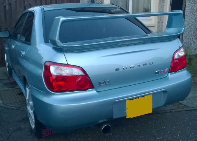

As requested in the Old Banger post...
After pic - stickin' oot!
post-1363-0-98535100-1392575602_thumb.pn
In time will replace the spoiler, as it's not perfect - guy has offered to
respray it for free if I get the wrong colour. If that's the case there
will be a spoiler light for sale ;-)
