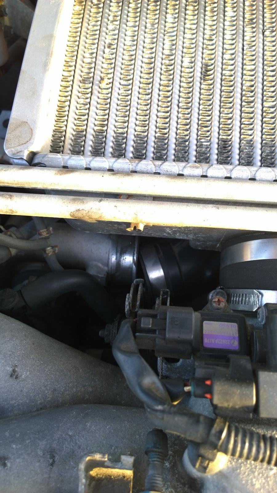

This one definitely caught me by suprise, I was on my way home from work and happened to be behind a motorbike. Coming onto a straight I thought "wonder if I can keep up" so gave it some, got round the corner onto another straight and just into third gear there was a pop/bang! All power went, smoke out of exhaust and it died.
Obviously first thing I thought was "oh god my car" then once I popped the bonet I realised the intercooler pipe had come off. I was told I was just unlucky but I'm worried it might have been something to do with my driving as It's only my 4th day in the car.

Nope never seen that happen not with me. I would just see how secure the TMIC is see if it has lot's of play just shake it, and reattach the pipe just make sure it's on tight. I've redlined mine before mate in 2nd 3rd and 4th and never had that :)
Thanks, I had it put back on last night extra tight and driving to work today she seemed pretty good. Was a good scare though!
Yeah you will be like that for awhile every knock bang or squeak :) you will start to turn into Detective Cluedo :D
That wasn't your driving - possibly just a dodgy connection but I would check all secure as Gambit suggested - given that I would also check the other connections under your bonnet
Yeah happens to me a lot as I'm running a sti 8 tmic , you need to make sure it's all tight but if the jubilee clip isn't man enough get a mikalor clip
yup jubilees dont seem to be as robust as they did years ago, metal seems softer so you cant get them screwed up as tight
Or you round off the screw head
I need a set of them as normally the screw driver ends up in your hand
That is the worst! Almost as bad as stepping on a plug.... wouldn't advise that.

If ιt keeps happening! Spray hairspray on the pipe work, then quickly put the pipe on. Yes I said hairspray lol
Well that's a cheap fix ;) .
