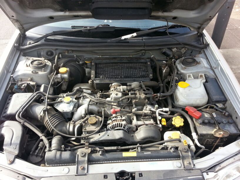

Hey been asking in a few places now but think this might be the right one im looking to add a Dump valve or a BOV to my 2000 Forester S turbo i was wondering what people opinions are and any good Mod ideas..I had a Jap import WRX STI a few years ago so im new to the Forester

Going to have a quick look on ebay see what i can find...is it most impreza mods parts fit the forester or am i barking up the wrong tree
Send a pic of the engine. The usual should work. If not you will need the adapter.

hey any advice is good advice at the moment mate this is the only picture i have
post-2439-0-76345300-1399846334_thumb.jp
Looks pretty standard for any 2001+ wrx/sti bov. Email them and see. Take a closer pic and send it to the.
