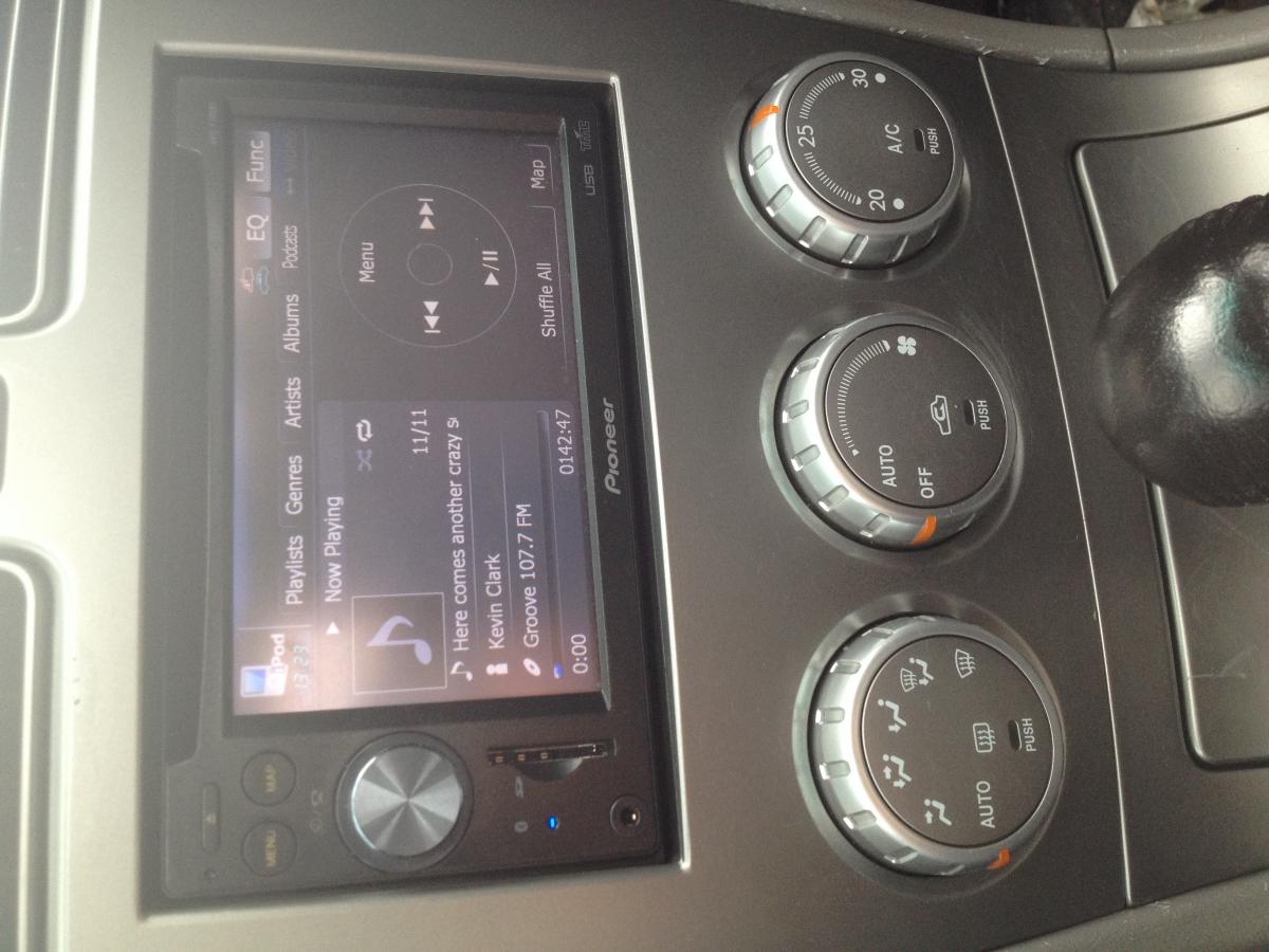

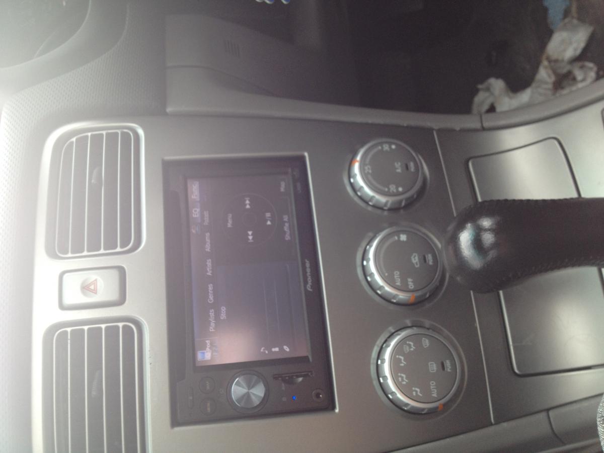

has some time and installed my 'old' and hacked Pioneer AVIC-F700BT and a Kenwood KAC-5205 amp in bridged mode given by my brother.
still using the stock speakers as i'm not really wanting to spend £ in a car.
to connect the SWC i used these parts from Halfiords as being around the corner;
autoleads PC29-677 (usc Subaru) £3.99
autoleads PC29-PIO (patch lead for Pioneer) £17.99
removed a pile of crap made by TrafficMaster as i cannot see the reason if this kind of pay systems as a smartphone does a better satnav job IMHO!
anyway got some sounds as being able to stream internet radio (ie Groove from New Zealand) from my iPhone so no need to listen to the boring UK radio stations. good.gif
that Pioneer i hacked years ago so can use any maps i want and has better menu system as stock dirol.gif

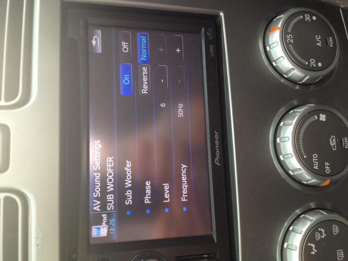

oh, the Kenwood drives the stock sub in bridge mode below 50Hz...
