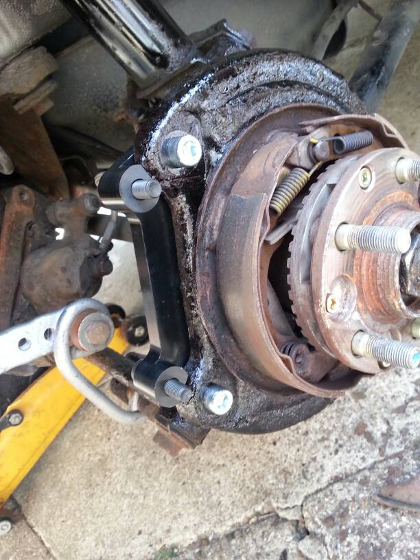

Dunno if the pic will come out as I normally use photo bucket but, here's one of the billet ally brackets fitted. They're needed on the classic 160 rear hubs move the caliper away from the centre of the hub to allow for the bigger disc diameter
Sent from my GT-I9300 using Tapatalk
Straight swop on the fronts with newage /late classic sti front 4 pots and 4 pot bigger discs
The rear handbrake shoes only fit the same type diff ie
Classic 160 rear diff/hub set up suits newage wrx 160 rear hubs/handbrake set up
Classic 180 rear hubs (from late sti /type r) fit newage 180 sti rear hubs /handbrake set up

Cheers for that savage yeah they are all standard 2pot front 1pot rear personally i think they really are terrible ! I will most likely go for that setup if its straightforward
Cheapest way would be to Have a look for newage wrx front 4 pots and rear 2 pots with discs second hand. then you'll just need new pads all round and the rear conversion brackets [emoji6]
Your my97 uk turbo will have a 160 rear diff / hub set up if you want to check compatibility . Alyn @ A.S performance sells the conversion brackets and numerous types of pads , but you'd be better off phoning him cos his website

I got my advice on handbrake shoe compatability and conversion brackets to fit newage wrx 160 rear 2 pots to my 160 classic rear hubs from as performance , but give him a call or drop him a email (cos his websites pretty useless )
http://asperformance.com/contact/
Wouldn't have thought you'd need the 2 pot brackets as I think they fit directly to the classic 180 set up.
