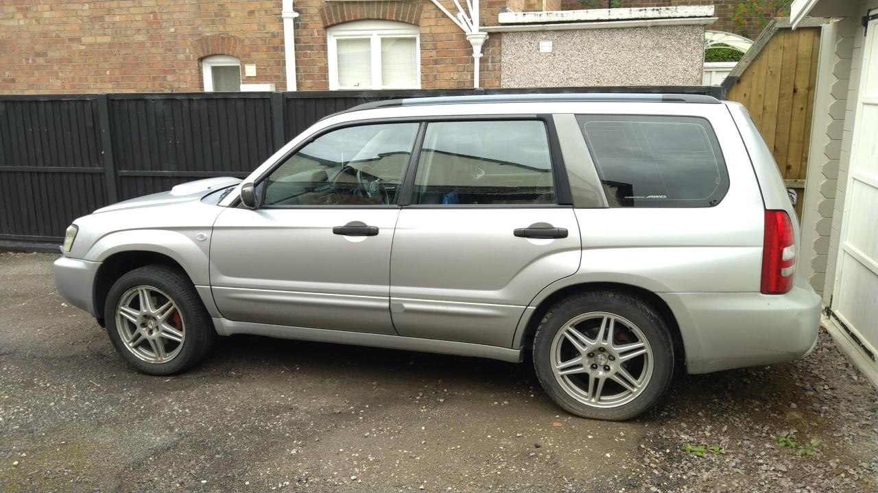

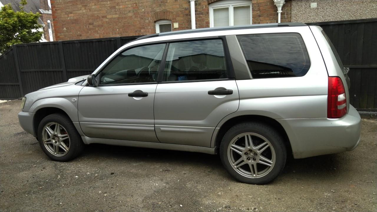

Okay, I finally got round to changing the springs and dampers the other day. Pretty straight forward, without issues. Though there's still a slight rattle from the rear, a tired droplink I suspect, as they are both tightened up.
Ride height is now approx 425mm, which is lower than I expected but actually what I wanted. My driveway woefully needs replacing, so finding good flat spot to measure isn't viable. Pics attached of before and after.

yeh would expect see another 20mm on kyb springs and struts paired but you can loose 5 to 10mm pending how take measure and fuel tank level and any boot load will all vary it .

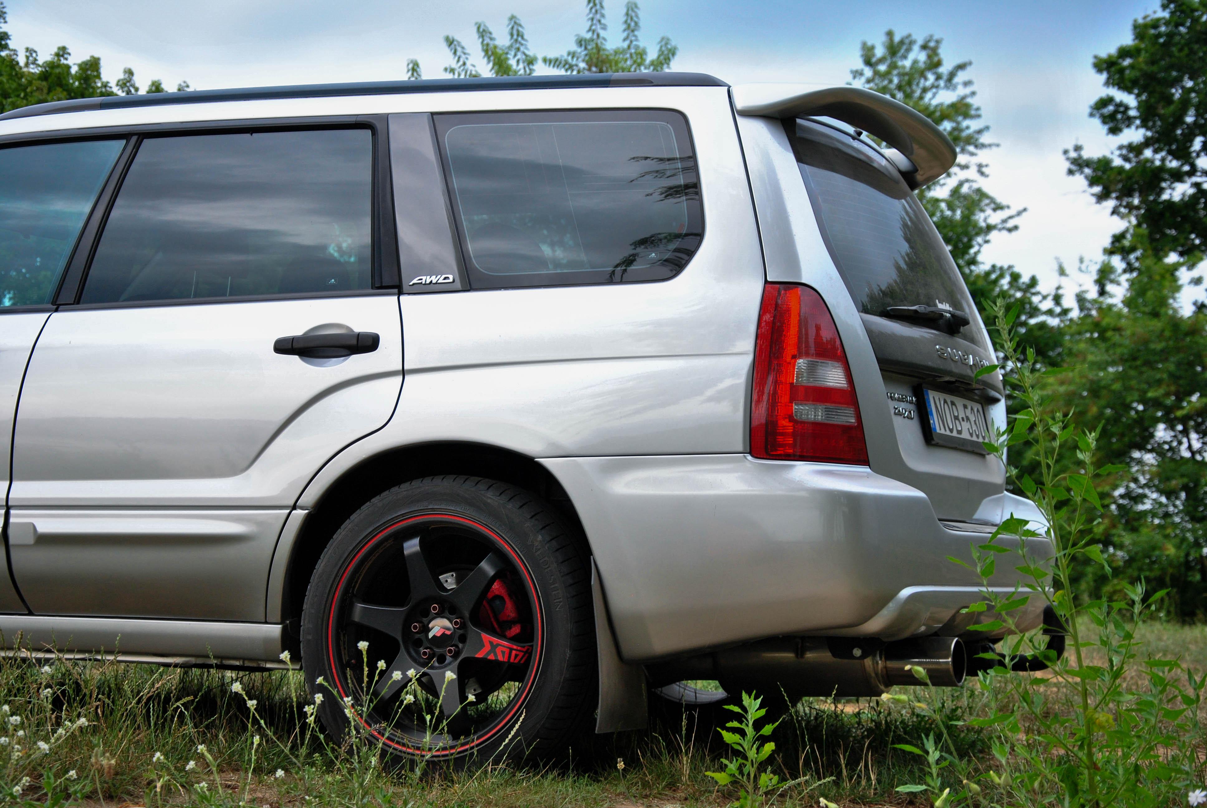

Your informations are really really awesome! I've got a 2003 SG5 XT with the SLS. Mines are not leaking, but they are saggy and one of my front springs is broken, so I'll have to replace all the 4 shock absorbers.
I want to buy the Kayaba/KYB struts and springs, and top hats too just to be sure, but I really don't know which spring should i buy to the rear. I don't tow often, only 4-5 times a year when I go fishing. I've got a small trailer (210cm x 115 cm) and the total weight when its loaded, and with my rubber boat on the top is around 350-400 kilos (incl. the weight of the trailer). Would you recommend the heavy duty RA6028 even if I wouldn't get the "benefits of it" many times?
Thank you very much for your answer!
Balázs from Hungary
My preference is the RA6028 mainly as the little extra height and stiffness tends be a good match to what the SLS managed when working correct.
The RC6431 soon give you that slight sagging look with light load and seems you going new on front the better final balance front to rear on heights likely come from using RA6028 springs .
Only real reasons to use RC6431 is if have preference to softer spring or desire lower side of subaru spec ride height .
If using KYB shocks on front then using the KYB top mounts will be good as the KYB shock has a longer threaded shaft with flats for a wrench rather than broached allen/hex key and this difference stops the original plastic cap being refitted which a problem as the koyo bearing in the top mount only has integral seal bottom side so it soon collect dirt and water without the plastic cap. KYB top mount has integral seal both side of the bearing .
What I will say though is the oem subaru top bearings are superb quality as koyo bearings are some of best made in the world and none of aftermarket will last as well .
You could cut 1/4" off the top KYB shaft and put a slot in shaft if want reuse original subaru front top mounts and have plastic cover fit .
Bit of silliness from KYB on design and purely a penny pinching one for simpler manufacture procedure .
