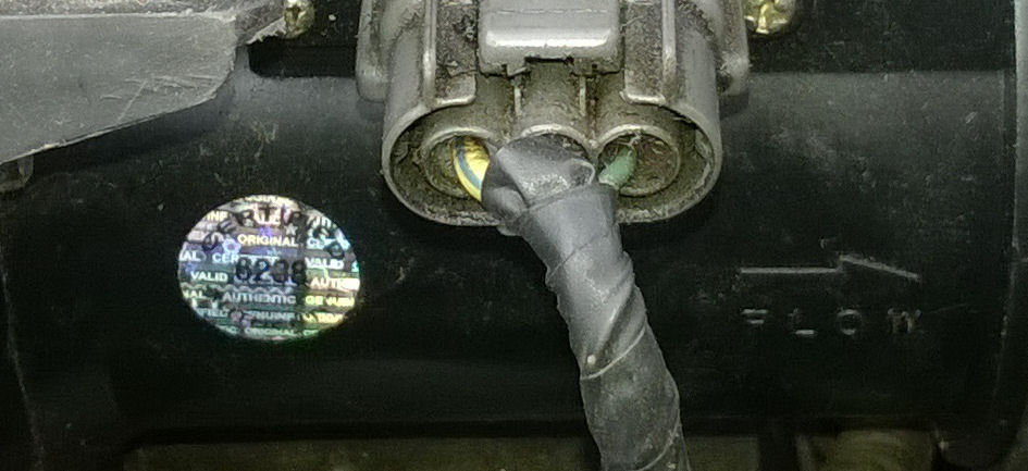

If it's been decatted and had a different filter should have had a remap, I'd pop in a standard paper filter in and give it a service, see how it goes, then try replacement maf, what colour sticker si on the maf housing ?

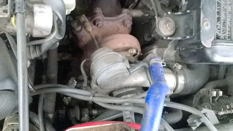

Going out to take a few photos just now Stanton. Is there 2 cats on the car? I will post the images in 20 minutes. Engine is a bit grubby looking but I will get it all nice once I get it running proper. I have all the service history and all previous mot's etc. Its done 111,000 miles.
Normally when the plug is pulled and a stall occurs this means it's working, it's not the best test but it gives an indication,
Standard exhaust there's one just behind the turbo and another one underneath the car in the 2nd section, the milage is nothing for these if they have been looked after [emoji3]

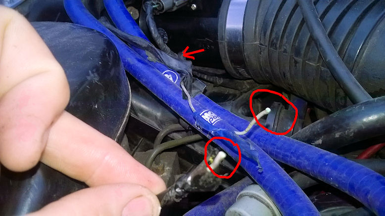

There are no other markings on the maf Stanton. But I did find a broken wire which was tie-wrapped to the maf wiring loom. The image shows the break in circles and the arrow is where the wire joins the loom. I do not know what this wire is for but I have cut off the green corroded ends and joined the ends back up properly. Will test the car tomorrow. Thanks for your help post-2587-0-62783700-1402864931_thumb.jp
Very odd ! If it's a three wire maf surely 2 are for current and one's a ground, how many wires coming iut of the loom, maybe it's an aftermarket maf and it's been altered to fit,

In your picture of the MAF plug, it clearly shows 3 wires. I can't see the middle one due to the wrapping. Is that wire the same colour as the broken one you found?

Its a grey wire and its not from the maf loom. Its only held on to it with a tie strap. The wire runs towards the radiator. I never had time to have a look at work because I had a few MOTs to do and fit a power steering pipe to a ford fiesta   :unsure:

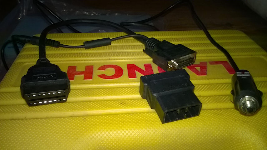

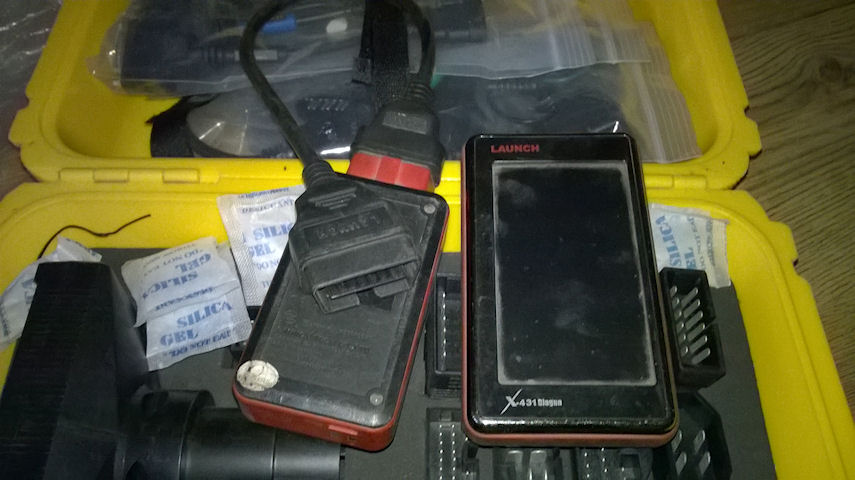

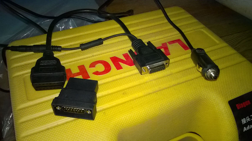

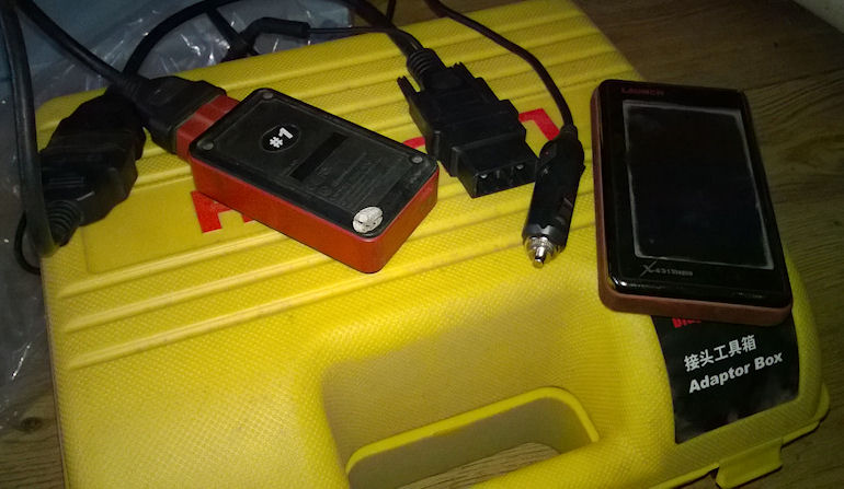

The wire was for the alarm switch on front panel to stop theft of engine parts I presume . On another note, I have replaced the air filter panel with an original and bought NGK platinum plugs ( not fitted yet). I managed to connect our works OBDII computer to it using an adapter that plugged into the yellow 9 pin plug thats under the steering column. The MAF showed up as a fault in history only and there were no current engine problems with Ignition on. I started the car and went through the computer again and it came up with the fault (Injector number 4 faulty). the Launch diagnostic kit is ace  :) . I have put the car back off the road for now until I get a few things sorted. I want to put new injectors in, the new plugs, Clean the throttle body, fit original exhaust because I want it to be a classic original one day. So its back to my tuned bmw 318 tds for now  :wacko: I am also going to check the cam timing marks are all aligned. A new coil pack and leads will be fitted too. The car needs a couple of bits of bodywork done but I am going to keep a running update in a post (where can i post it) including images of all the work done making this a modern classic in original condition.

Interesting news on the 9 pin adaptor, I take it being a garage you have an all singing all dancing diagnostic package,
As a long shot bases on your findings I've just ordered a subaru 9 to 16 pin adaptor from the bay if it doesn't work with the cheap softwarer I have then no loss if it does, opens up a whole new avenue for classic owners.

We have two systems. The bigger system is OBDII only but we have a system called launch that has various connectors I will show you the adapter I used. Oh and if it asks for 16 pin or 9 pin, select 9 pin  ;)

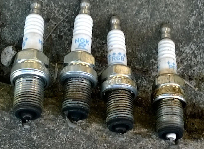

post-2587-0-00109000-1403070632_thumb.jp
post-2587-0-01409700-1403070642_thumb.jp
post-2587-0-45952300-1403070645_thumb.jp
post-2587-0-08955300-1403070652_thumb.jp

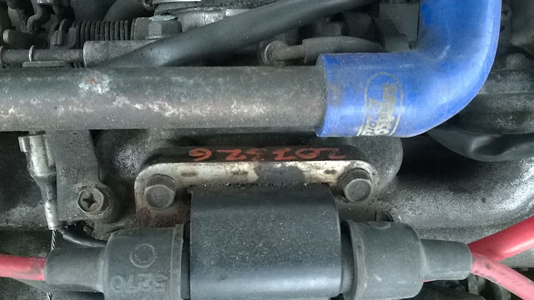

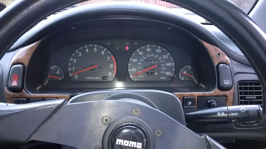

Number four looks like its not been firing properly as you say. And it does look a little rich. Im new to subaru and Im also mainly a diesel specialist. My ignition timing is at 12 degrees, is that correct for my car. Also when on the computer the knock sensor was showing no value. it was at 0
