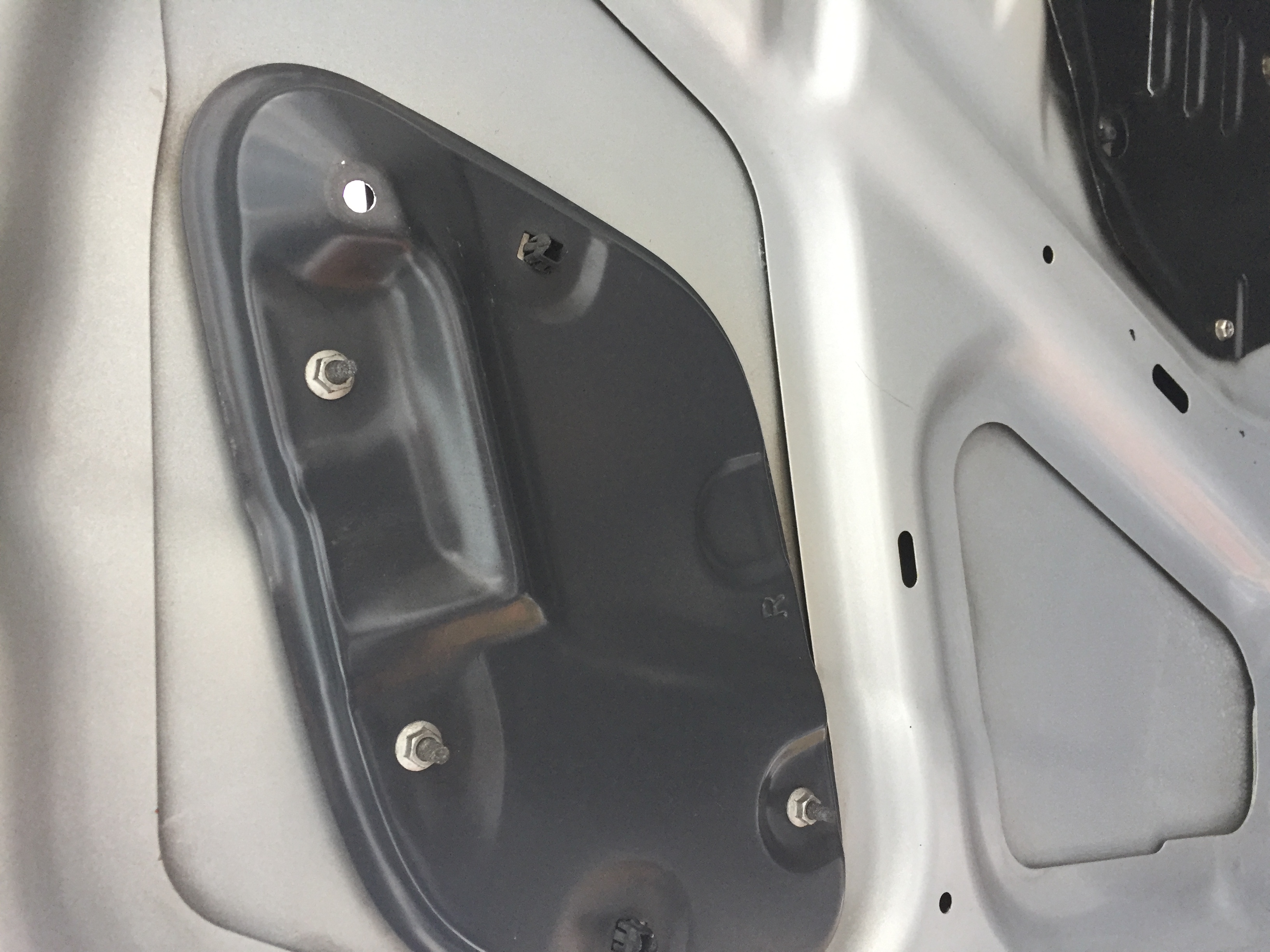

in my example I think there's a missing grommet or something - see top left of the air vent.
Both of my classic turbo's had that hole in the vent under tray (without a grommet in it) and get water sitting on the chassis legs .
I just assumed it was a drain hole for rain water and they'd designed it to drip on the bodywork . As otherwise it might cause a electrical fault if it dripped too close to the spark plugs or engine ?
Hi SB, thanks - did you have water sitting in the battery tray as well?
I did have a bit in the plastic battery tray once but I released the battery tie down , shifted the tray over a bit and re tightened the clamps .
It now misses the tray on the passenger side and the v1 hasn't got abs , so it just sits on the chassis leg on the drivers side ,untill driven
