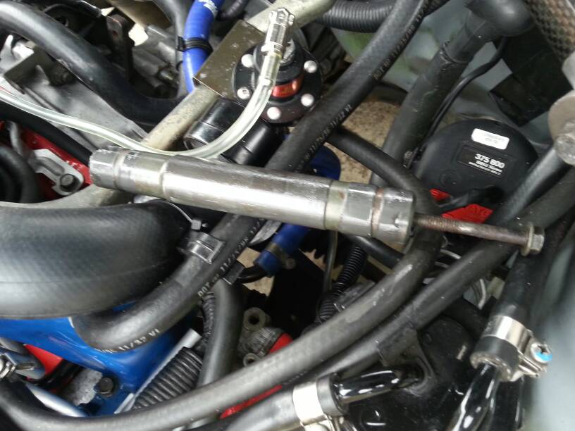

Thanks for the replies. I've found what I think is the filter mounted sideways next to the nsf turret. Is this it? post-2830-0-02204800-1406492812_thumb.jp
It's only 4cm deep. The supposed correct replacement from ECP is 10cm deep with the outlets at a different angle (sorry for the poor picture).

Is this the correct replacement part as I don't think there's enough space to fit it?
I took a couple more pictures in the daylight so can anyone confirm whether this the fuel filter?
post-2830-0-28957300-1406572797_thumb.jp
post-2830-0-05550300-1406572862_thumb.jp
If it is, where I can get a like for like replacement?

That's not the set up in my car. What I think may be the filter is mounted low down and sideways below the fusebox and furry pipe in this picture:
post-2830-0-48894600-1406577222_thumb.jp
Its also a third of the size of the supposed "correct" replacement part from Eurocarparts. That's why I keep asking!
