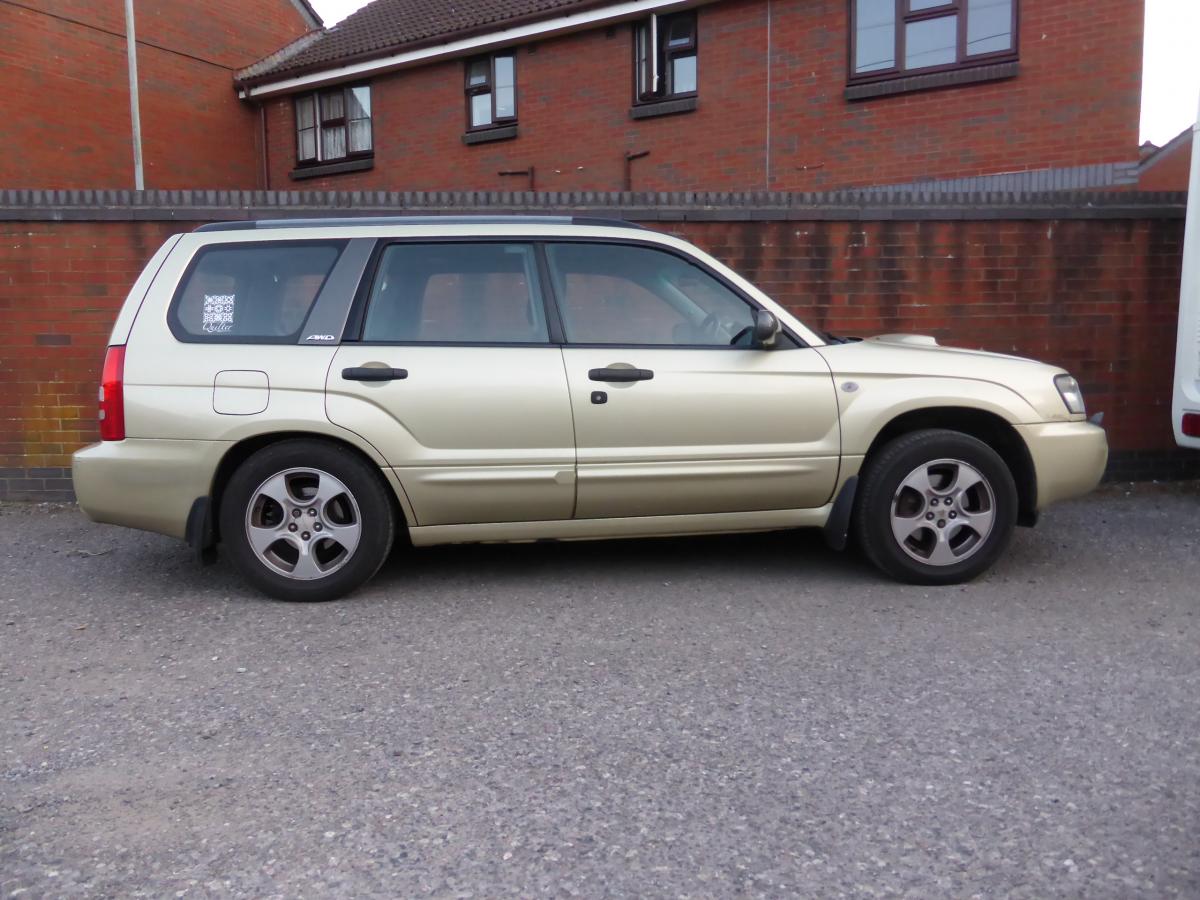

Hi, I've had my Forester for a couple of years now - it's registered at the beginning of '02 but because there's a 00 in the VIN I assume it was made in 2000.  It has 128K miles on the clock and I'm very fond of it,. I note that there is a difference in height at the back making it always look like it is well loaded. I'm wondering about the rear suspension although as far as I can remember it was always like that since I bought it.
It has just passed the MOT with no problem and there's no trace of wallowing. Both sides appear the same. Using the jacking points as a very rough position, there is about 1.5 inches less at the rear.
Before I get involved in the obvious expense of replacement springs etc.,   is this something I should be concerned about?

Failed SLS struts.

Not that expensive even if need a garage to fit. Parts around £280ish tops with springcoil springs & can be under £200 if pick up excel G shocks with K-flex spings off eBay at close to half of RRP & cheaper than most autofactors.
Can be left but best done really if intending keep vehicle for some time, won't drop any more as about 50mm is max travel of the levelling function in the strut ...
agree with Mr B, shocks are shot. i had the same with my 2003 XS back in Australia. the only thing i wonder about is that you still can drive her and not feeling any sweeping from the back when driving over bumps at speed  :huh:

I think your Fozzy deserves new struts & springs, looks tidy & it got plenty of life left yet ...
I'm in the process of doing mine this week. Good indicator or how dead they are is to lift the rear arch by hand and let go not very scientific but you get the idea. Or get a tape measure and go from the inner lower edge of the rim to the body work.

Currently measuring 610mm :-(
