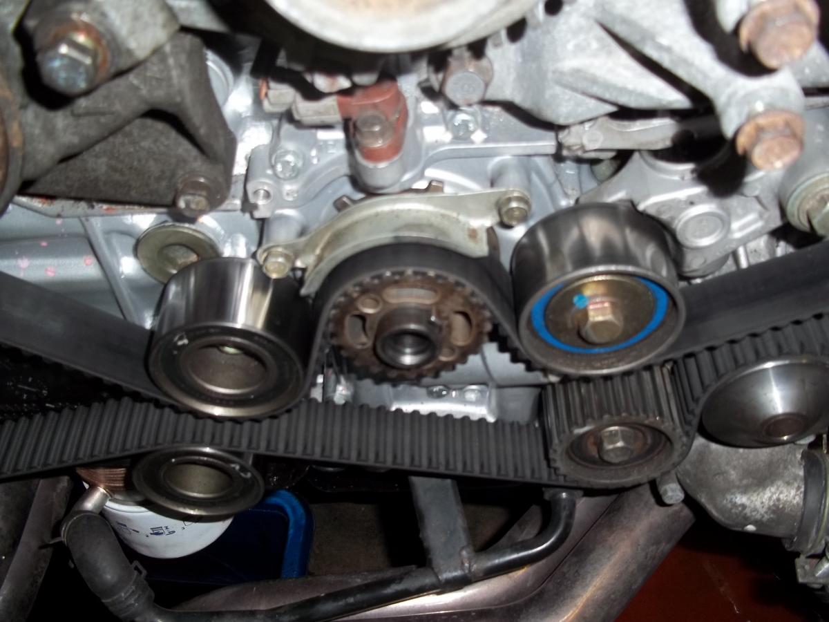

guys is the rh side exhaust pulley f***ed or something, this is what happens when i line all the marks up, the driver side exhaust is facing the wrong way, help please , i need to time this right,

Tbh I'm not an expert but from the pic you posted you bottom left pulley looks 180 out to me. Hopefully some one with more technical knowledge would help. Personally I would call a local specialist to a least have a look and tell you what the problem is.

hi mate as you look at your RH bottom pulley ur 180 degres out, should be a faint mark/notch on your belt cover to the side of the pulley.
