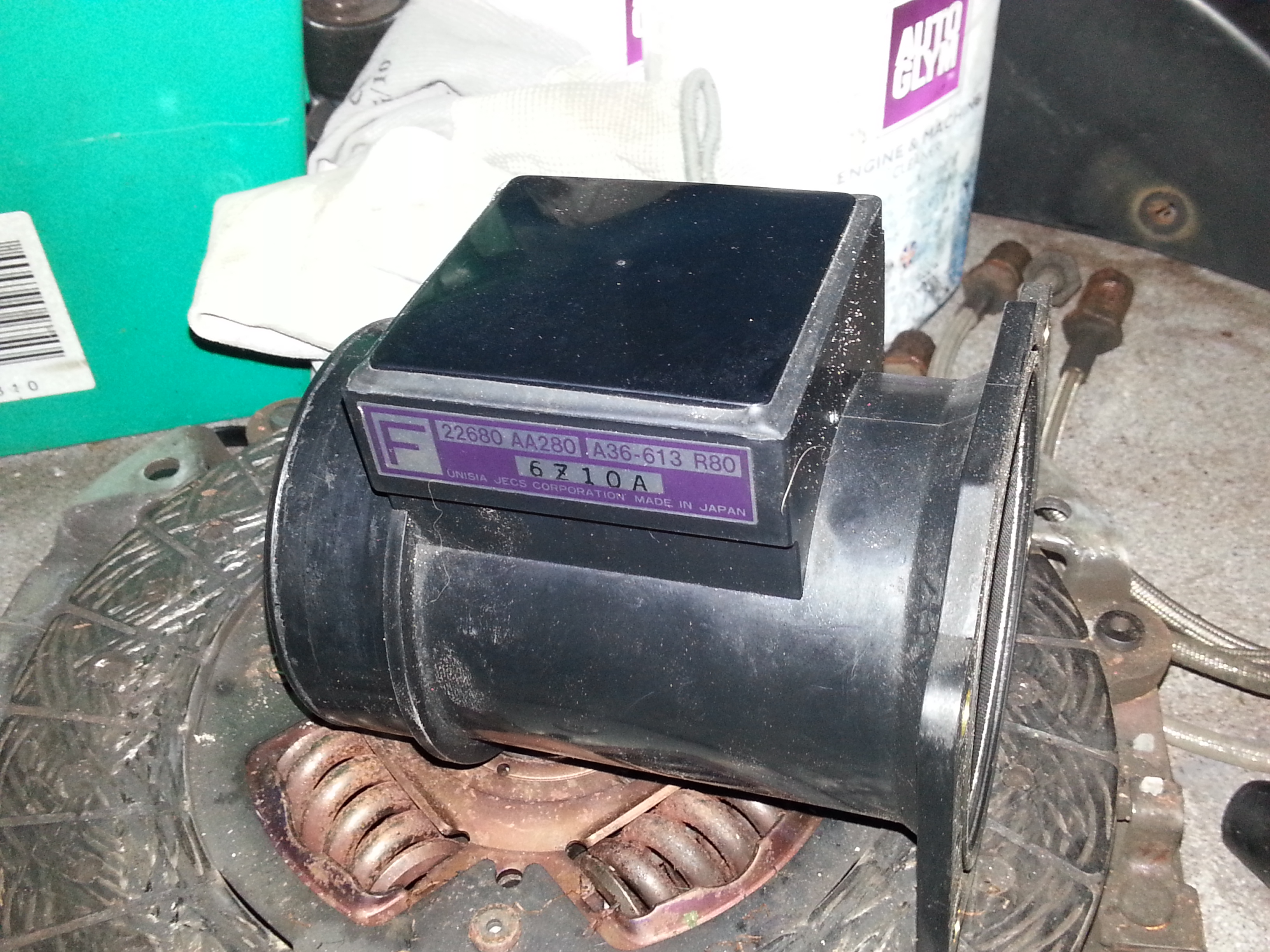

Bugger . Got maf but plugs are diff . Any ideas guys ? :(

Mmmm I gladly have it of it of you . Got a green one I'm sending back as son as I get the refund I gladly buy it off you .
Hi I'm desperately trying to find a purple maf ? Tried a green one but plug was wrong . Any ideas guys ?

If you're really stuck and can't find one elsewhere I can chuck mine in the post for £35

the best way I can think of being fair is for me to send it and if it doesn't work send it back and I'll refund you £30 (other £5 covers postage my end) .
Worst case scenario is we're a fiver down each

sorry to be a pain in the !Removed! . Replaced maf and is a lot better but still not 100% . Any ideas ? . Thanks btw bulldog .
