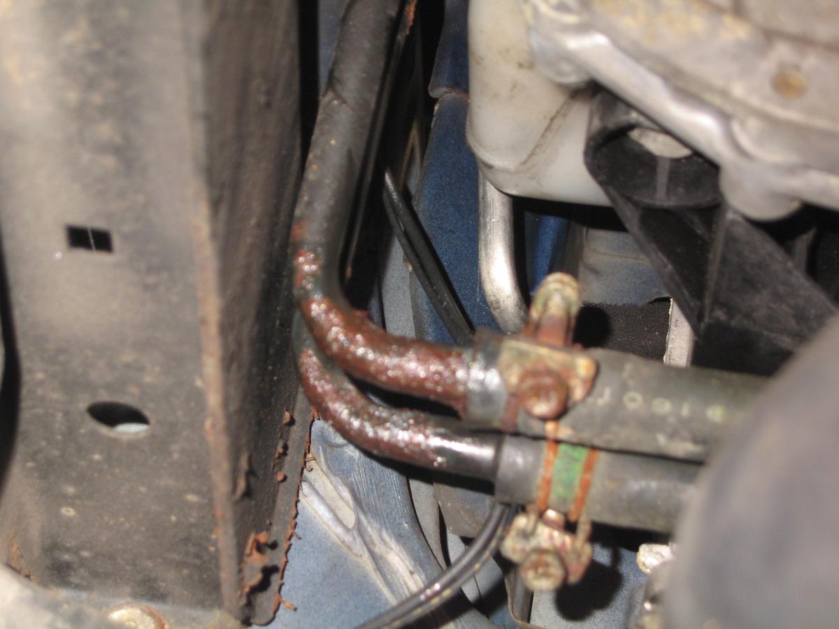

I have recently experienced a problem with corrosion of the transcooler pipes. It was pointed out to me on its last MOT. The corrosion is at the engine end of the pipes at the bottom below the battery. I attach a photo taken from below the car. At first I thought in might be that some battery acid had split and run down the pipes as the battery is directly above the point where the corrosion has occurred. However, on having the pipes stripped out I couldn't see any other signs of corrosion higher up on the pipes or on the body panels, so I guess it might be from road salt. I am surprised that the pipes seem to be made of mild steel. The replacement pipes took 10 weeks to come from Japan and the car is now back in good health. I was a little curious that the pipes seem to take a detour out and under the nearside wing near the battery on their way from the auto gearbox to the bottom of the radiator. I presume that there is a additional cooler under the wing. Can anyone enlighten me about this?
